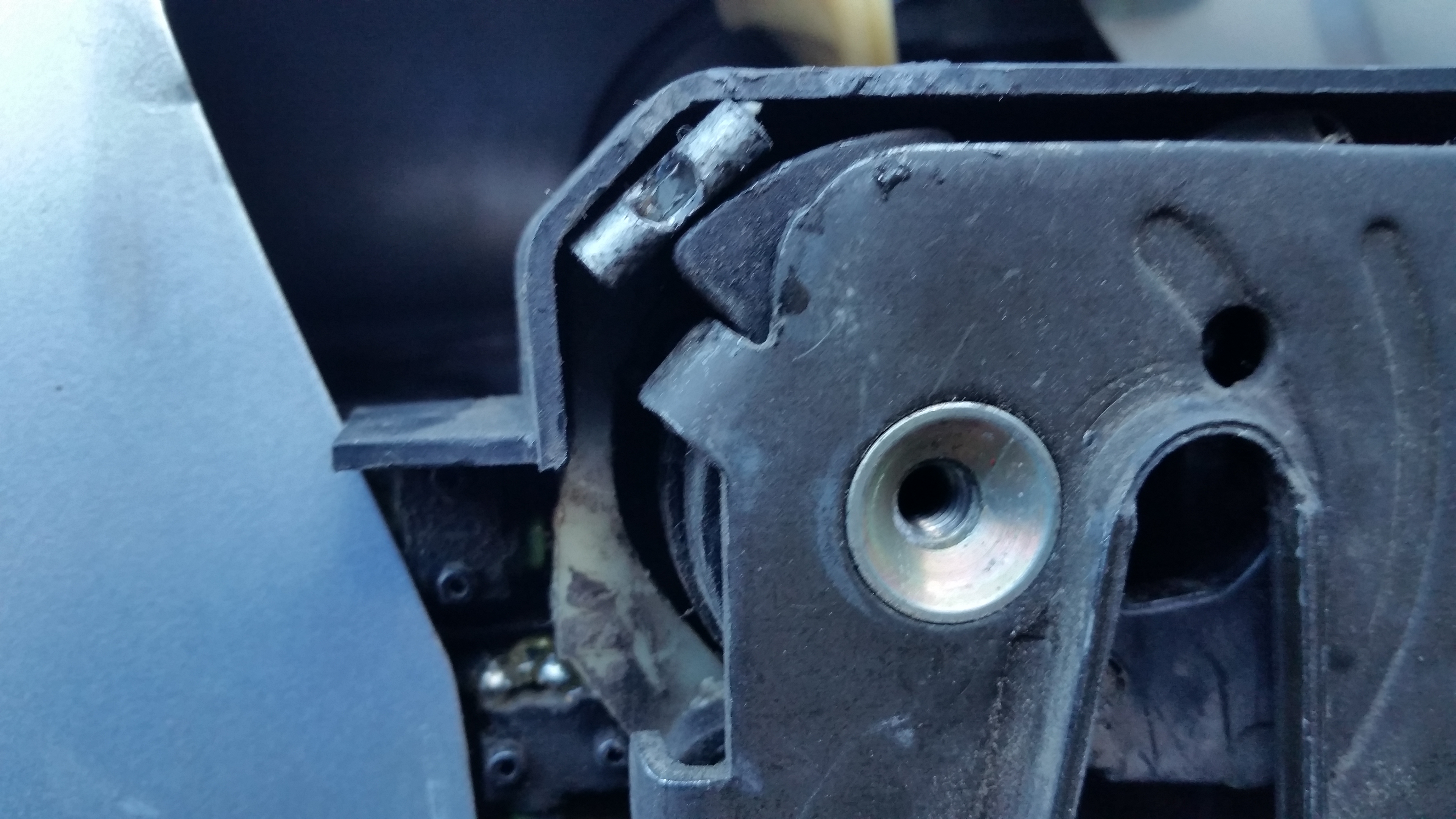

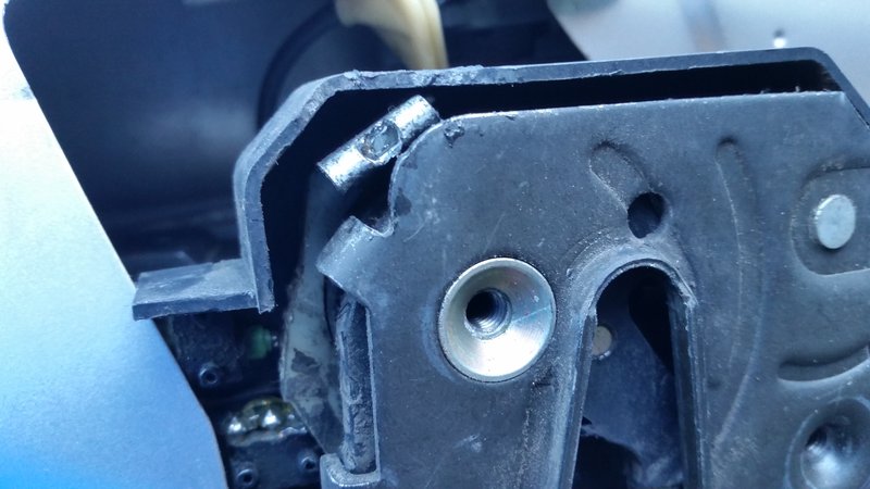

This is a fairly simple fix and a common problem. There is no need to buy a $100.00+ new switch. You can do this job inside of an hour. I will not go into detail on explaining how to take the door panel apart or how to unbolt the latch.

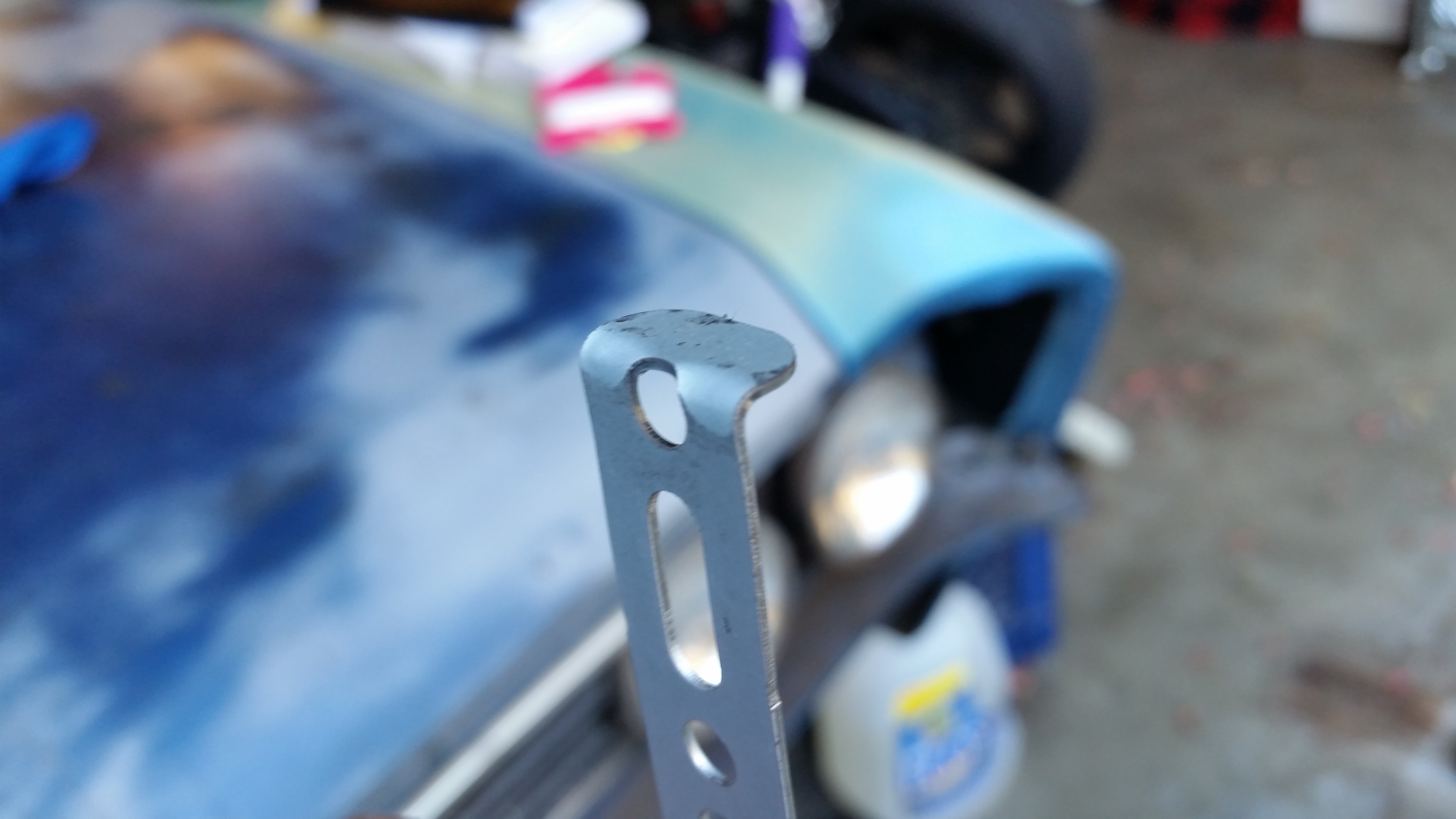

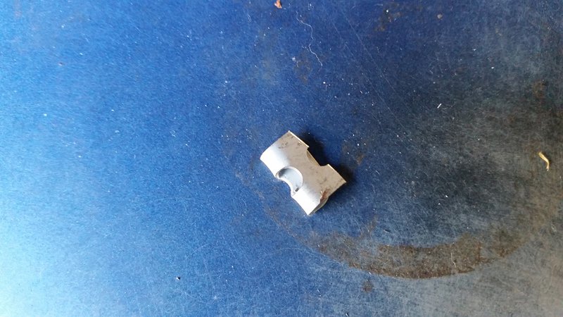

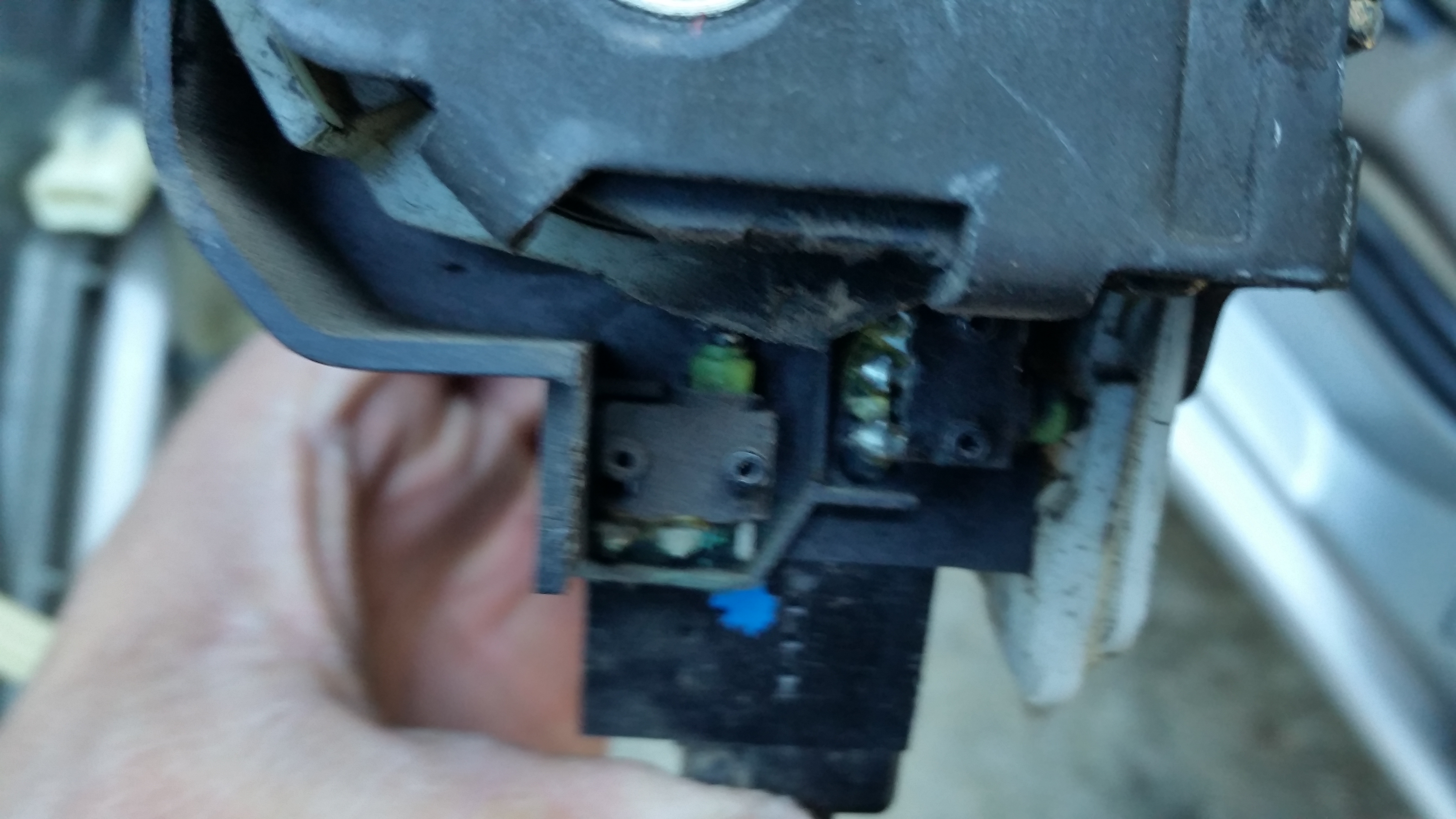

After you have the latch out, you can see in the picture the small green pin switch that senses if the door is open or closed. After many actuations, the plastic parts wear. To fix this, I just installed a shim. In the pictures, you will see the rocker lever that pushes the pin in and our. All I did was get a metal strap, bend it as shown in the picture, Cut it to size, and place it in the position that is shown. I did not use glue but you can to ensure that it stays. I did this two years ago and I haven't had to slam my door closed since then. after its done, just put everything back together again.
