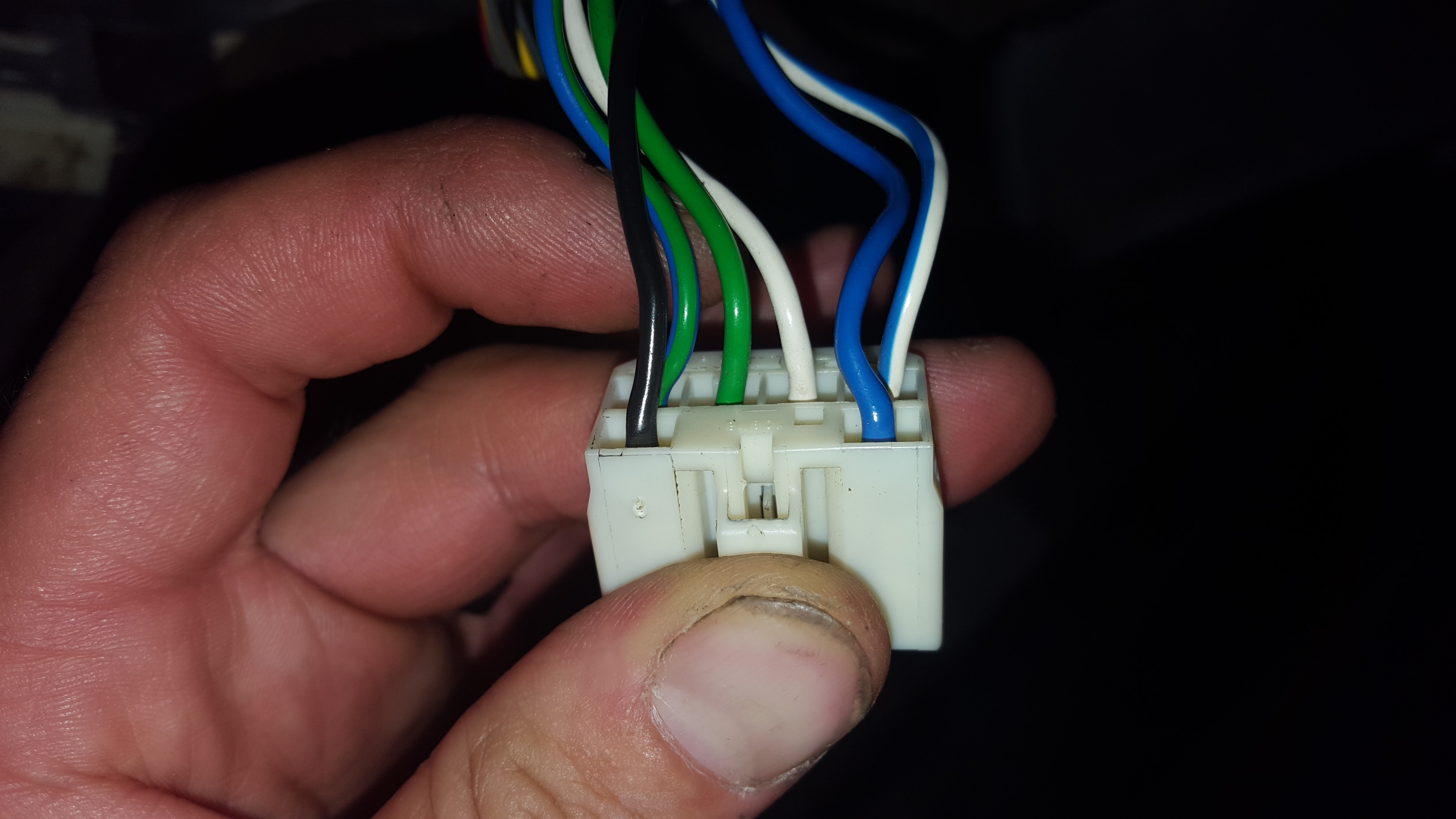

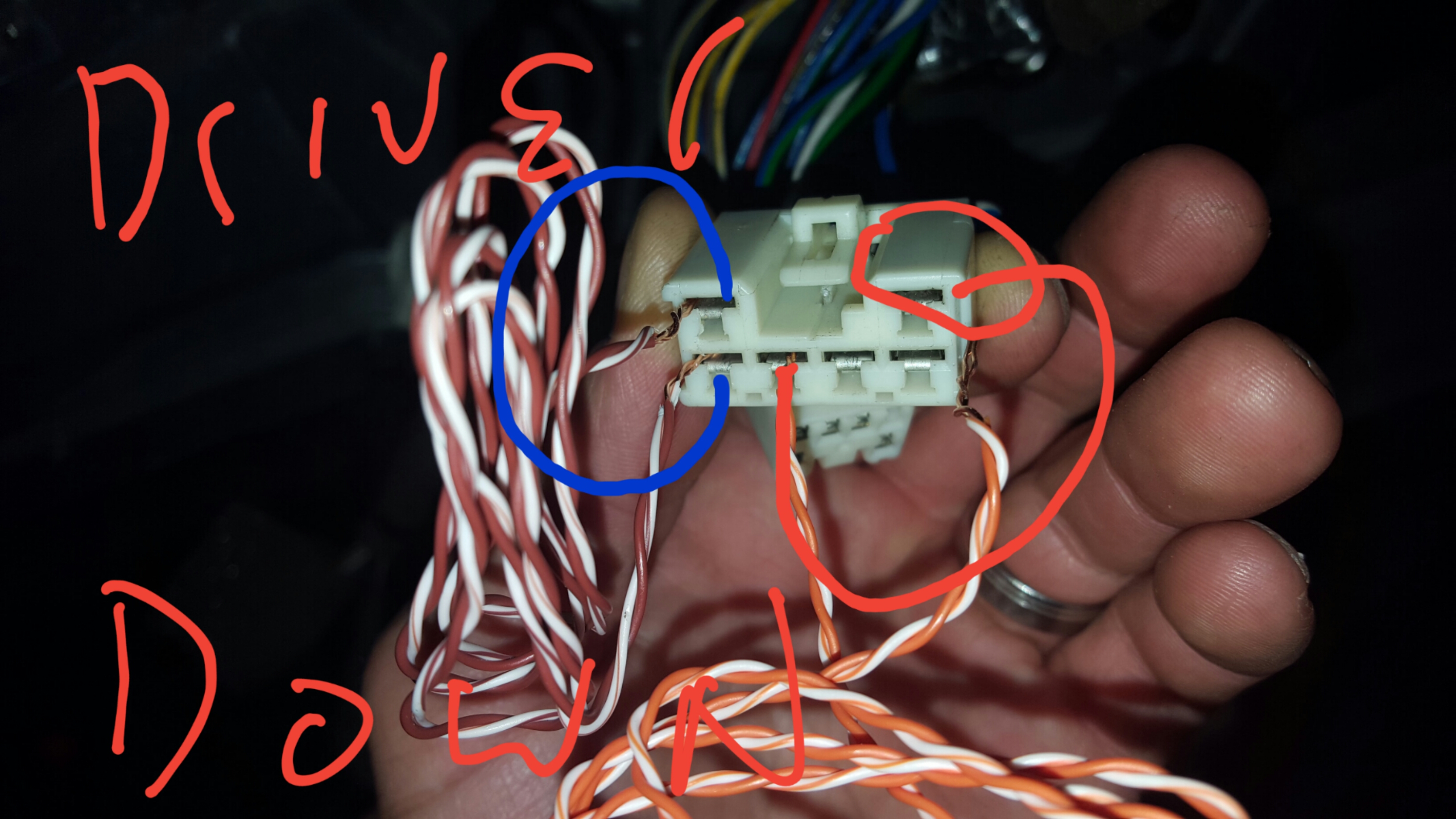

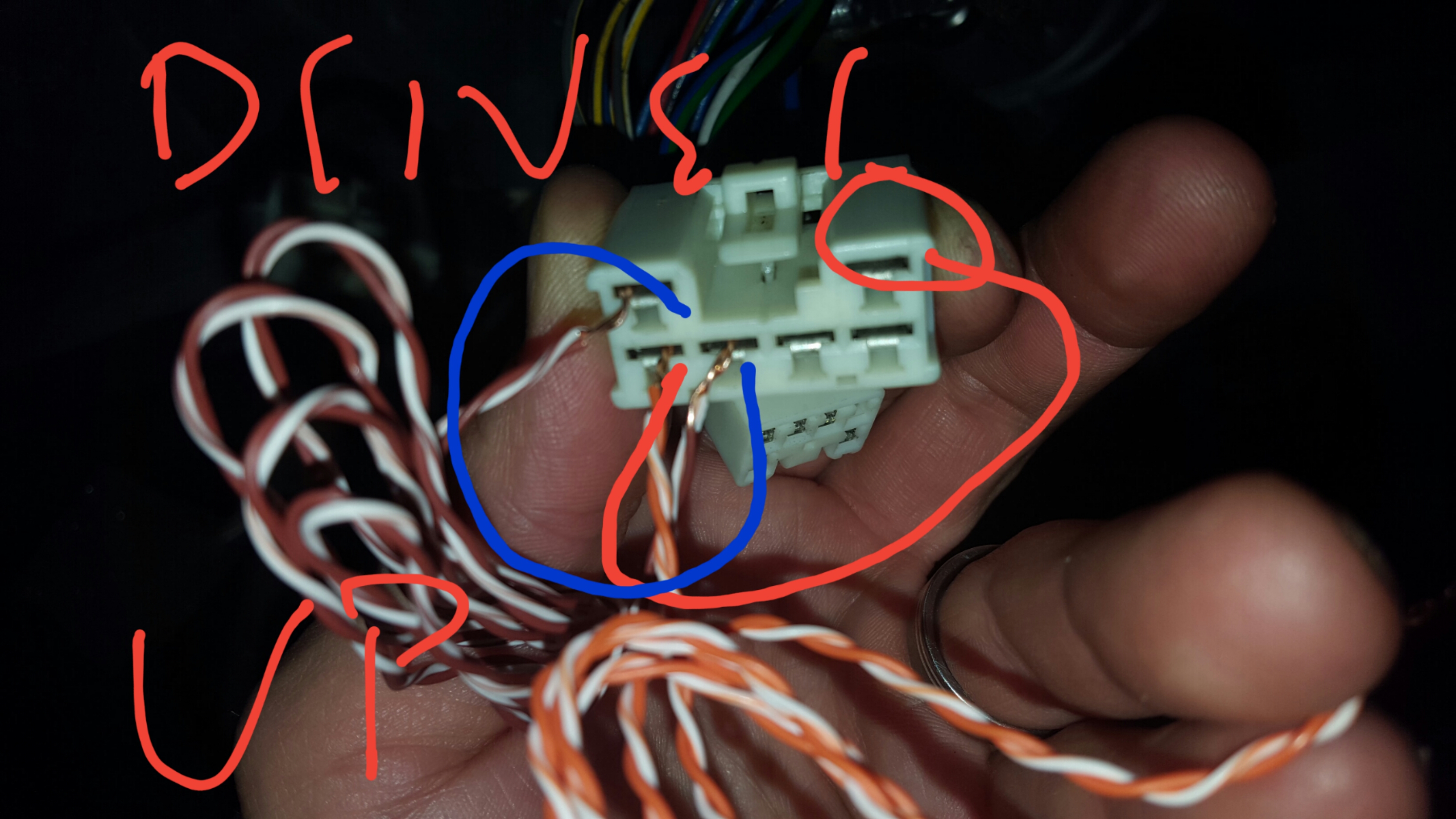

How to bypass. I dont understand the schematic at all!
Here is how to roll it up in emergency.
So mine died too, sunroof too. Swapped fuse 37 for 39. No help. Unplugged master switch and sunroof worked. Tried cleaning, it worked to lower driver window 3" then died again. I pulled the plug off and figured black is ground, blue is power. Jumper in green to black and put jumper in green blue and touched blue for up. Also Green blue to black and green touched to blue for down.
Hope this helps
Hope this helps
