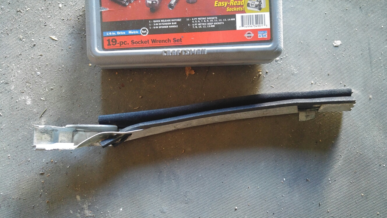

So I finally took the door panel off and found this guide rail loose:
After removing it the window would open and close as normal. Since nothing rattles or moves incorrectly I´m tempted to leave it as is. But usually cars arent built with alot of redundency, so I´m wondering what to do. I guess the rail is supposed to go where the door latch mecahnism is, and I think this is quite timeconsuming to fix. I did the windows on my 72 Lincoln twice, what a pita.
Any thoughts?

Update: i found a link linked in cn90s post linked above. Time to get that part from the dealer or the junkyard.
