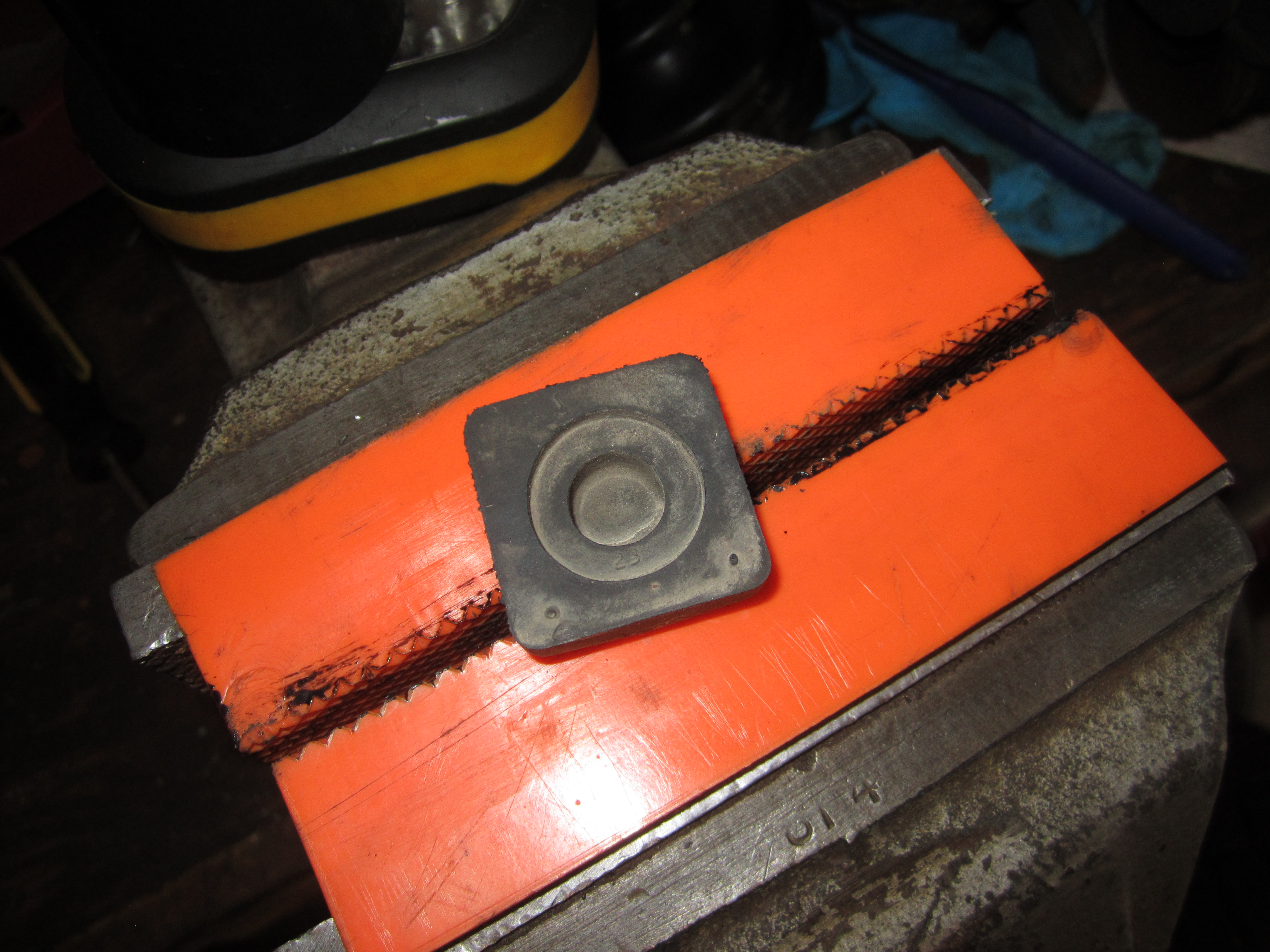

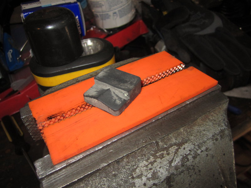

4) What is this? I think it may be a bump stop that sits on top of the bolt that holds the front fender on nearest the windshield. I found it behind the inner fender liner when removing the LH front mud flap. There isn't one on the opposite side. It looks familiar!

Opps forgot to add the mystery item photos:

Any ideas on the rubber piece?

LOL, my favorite rubber piece. It covers the rear fender bolt under the hood, close to the windshield.

Thought it looked familiar. Now just need to find a matching one! Thanks for the confirmation Robert!
