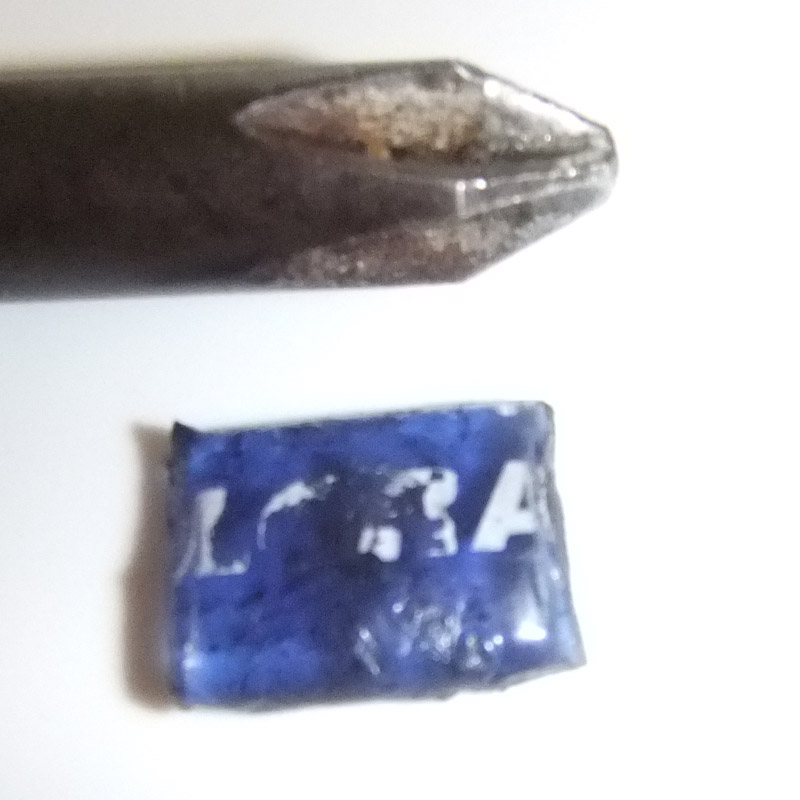

In case you're wandering, that's what I found jammed down into the lock cylinder. Couldn't push the key all the way in. I was expecting it to be a problem with the weather flap but that was ok. Foreign bit of hard plastic (and a #2 phillips for reference)
