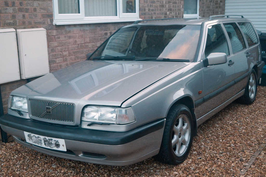

Got given a free 1997 850 10v 2.5 that failed its MOT on emisions
Here is a pic

Welcome to MVS, Mark. What a beautiful wagon. :shock: :shock: :shock:
I replaced your photo with a better-corrected one. English cloudy sky blueness problems in the first ;-).

Hello Mark. Nice detailing job on the paintwork. That was an extremely impressive reconditioning list you've completed.

Thanks everyone , i havent touched the bodywork yet ,
