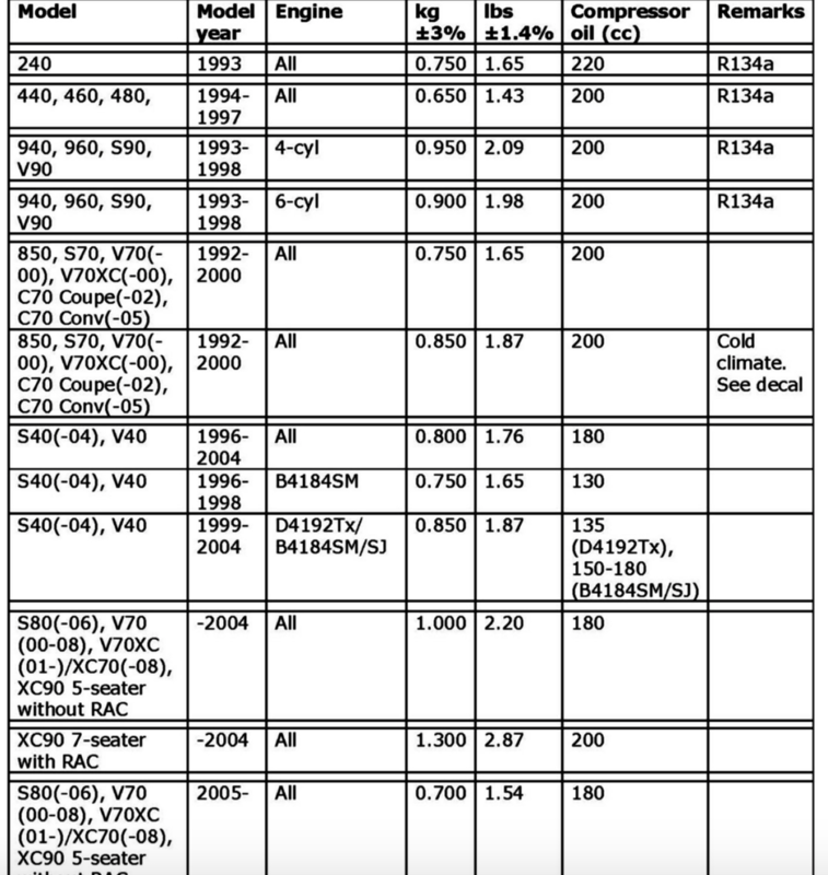

I added 60 cc of oil, and then three 12 oz cans of r-134a.
If you check your R134A capacity I think you will find you overcharged it - which will exactly cause your symptoms.
Even with having the system fully open and the line from the compressor removed? I couldn't find an exact recommendation for the number of cans to use, nor did I think the pressure in the cans made it possible to over charge.

Look for a sticker under your hood with the AC refrigerant specified. I think its about 750g or so?
750g is about 27 ounces.
A little less in warm climates (5-10%), a little more in cold climates (5%)

Looks like 750g for your AC charge in warm climate
