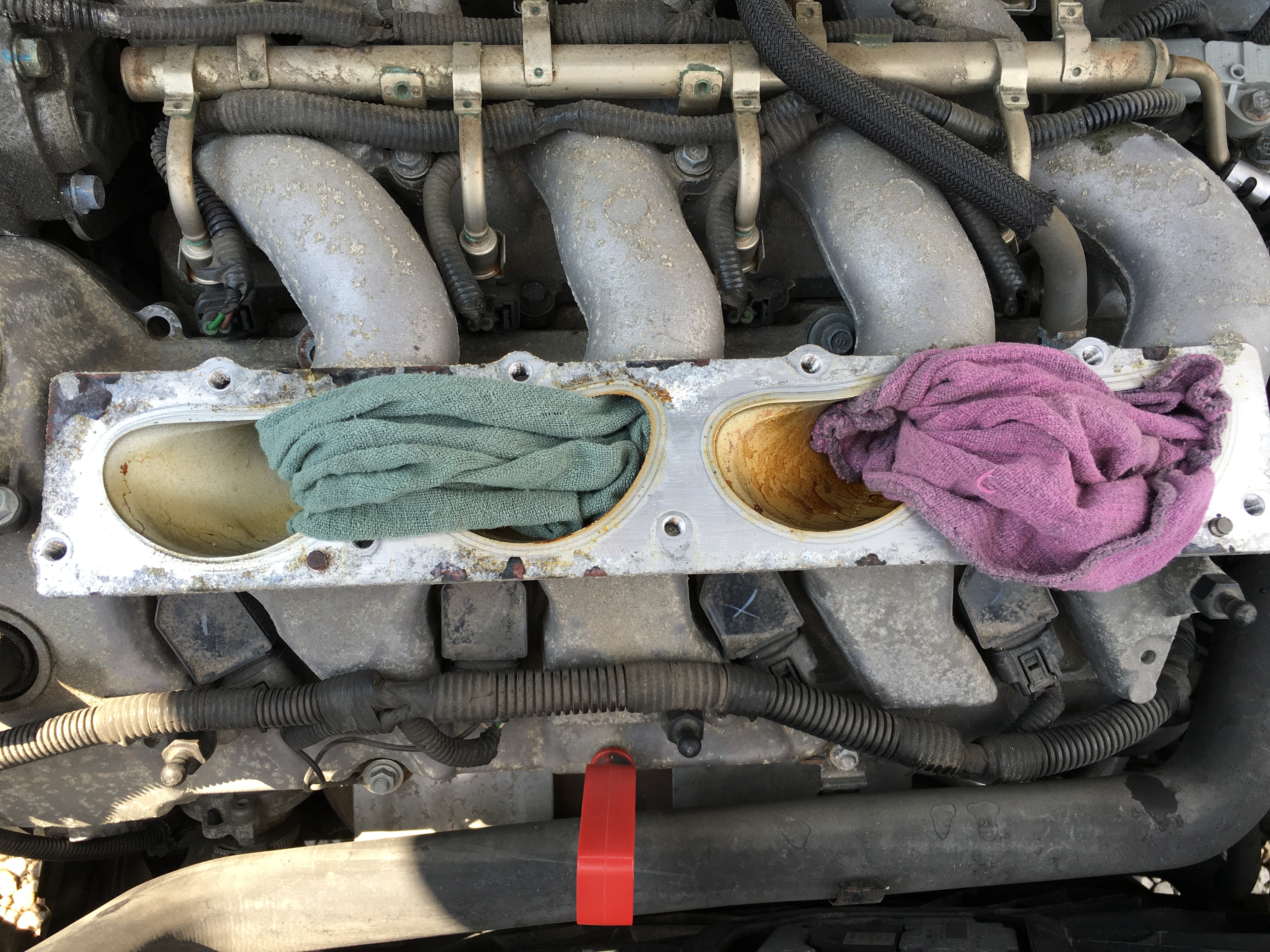

Cleaned the upper intake-just where the gaskets sit. Replaced the short pvc hose and upper intake gaskets.
I turned the key to the 2nd position and off to set the throttle body.
Turned her over and rpms went up passed 1200 and Didnt seem to want to come down.
Pulled the battery terminals to do a hard reset on the ecm
Back to the square one-idle low in drive
I'm going to keep driving it
