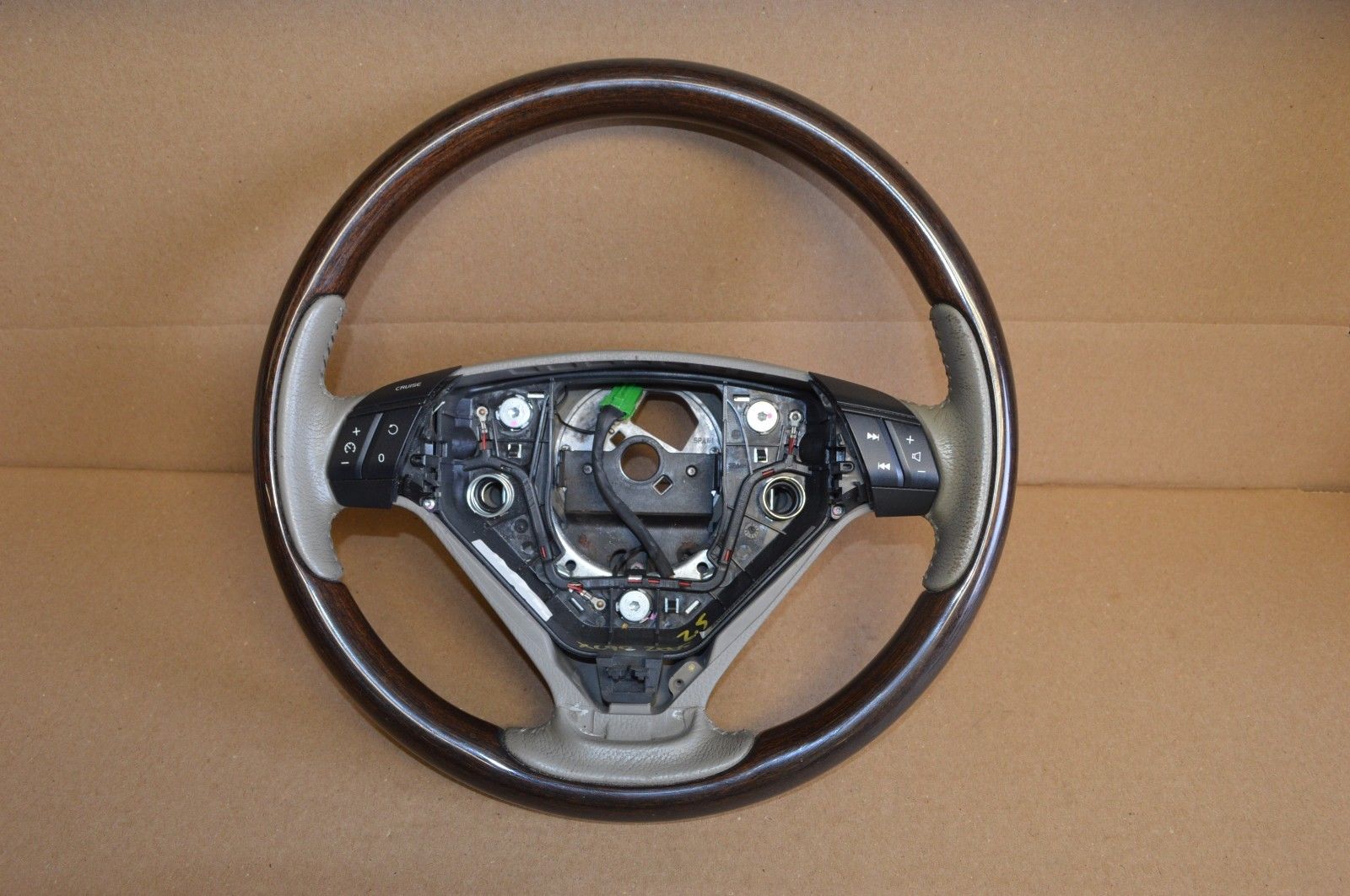

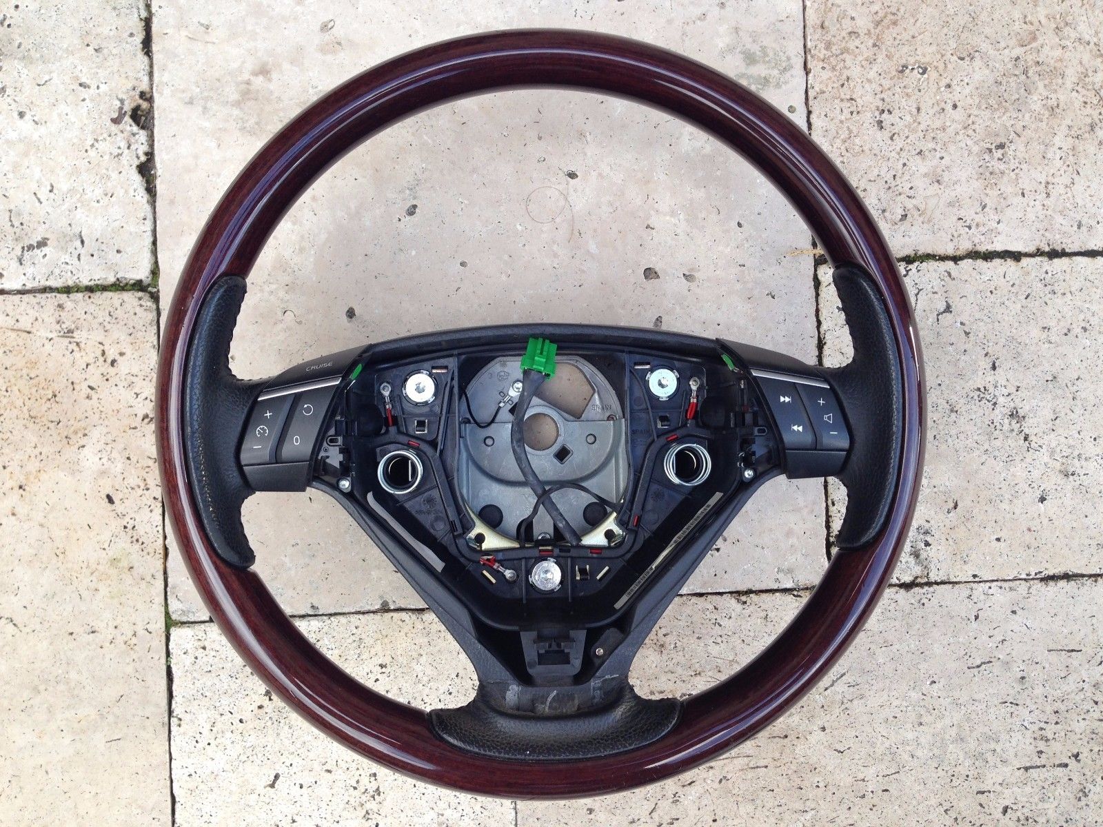

Here's an XC90 style wood wheel with silver buttons and black leather
Here's an XC90 style wood wheel with black buttons and tan leather

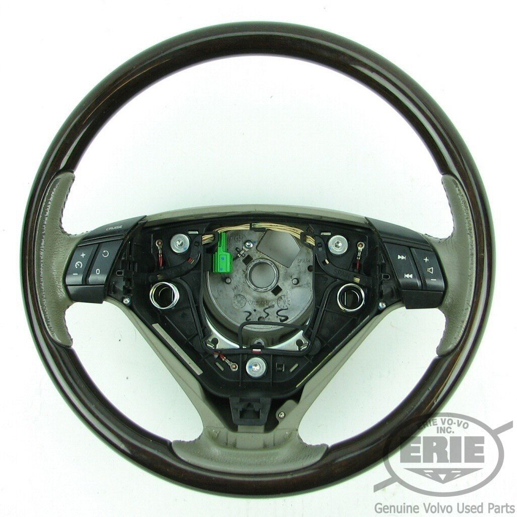

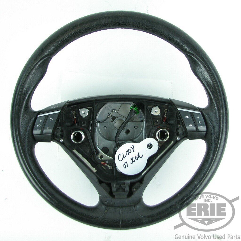

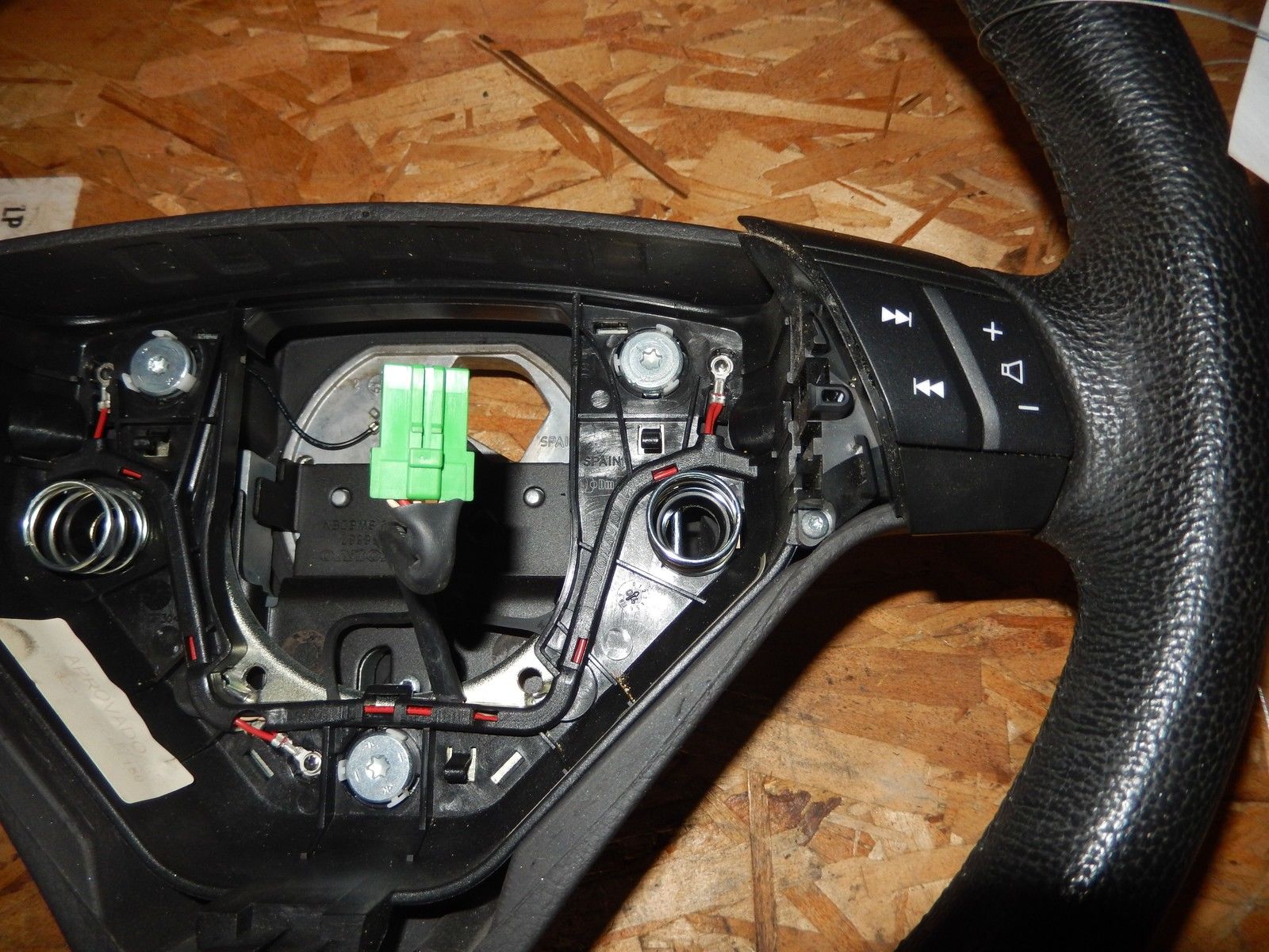

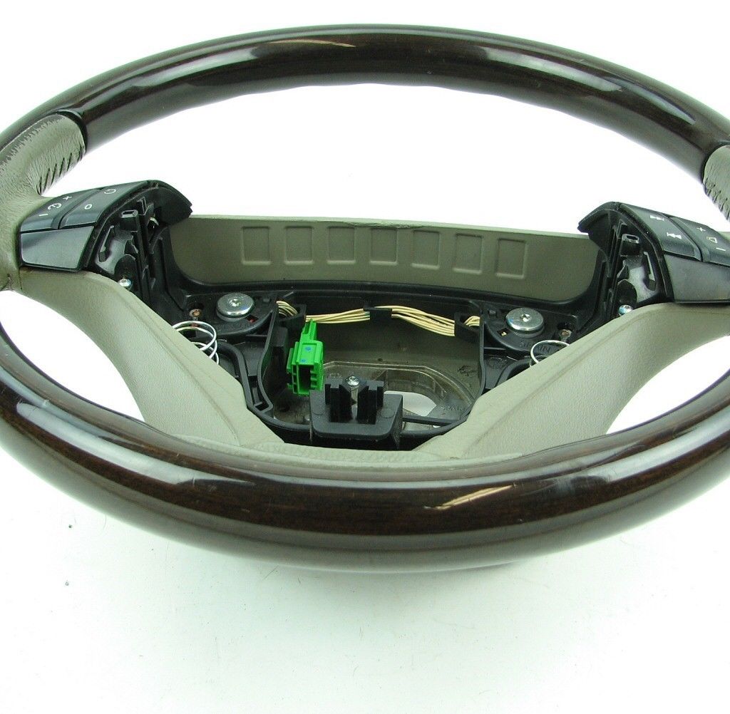

There are a few things to consider before buying things. First, button compatibility. For 2001-2004 S60 and V70's, (and presumably '03-'04 XC90's and '99-'04 S80's, though I can't be sure) this style connector is used for the steering wheel buttons. Here are two good angles of it in a wood wheel, courtesy of Erie Volvo.

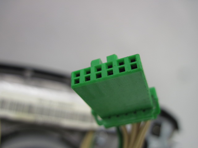

From '05 on, this style connector is used, including for the sweet silver '07+ buttons.
Here's a closeup of the end of the connector
Top down view
All P2 wheels will work, but you'll have to get a different cage/button assembly if the wheel you want has the wrong connector.

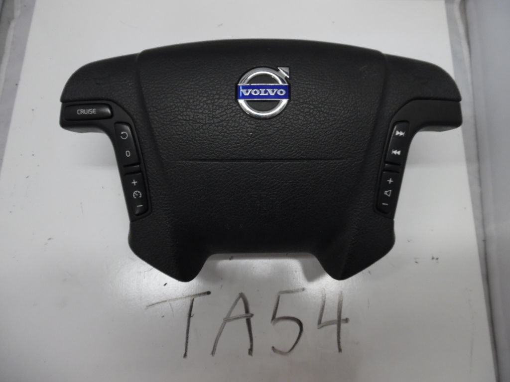

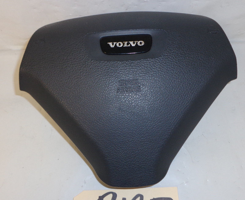

Air bags come in several flavors - '01 to '04 had this square Volvo emblem.
Three spoke example
Four spoke example

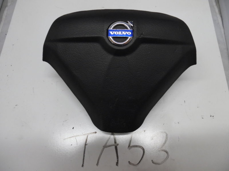

~'04/5+ had this round Volvo emblem.
Three-spoke example
Four-spoke example

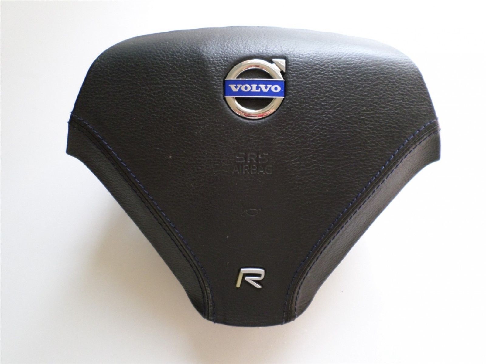

Volvo R cars came with this air bag w/ blue stitching to match the interior

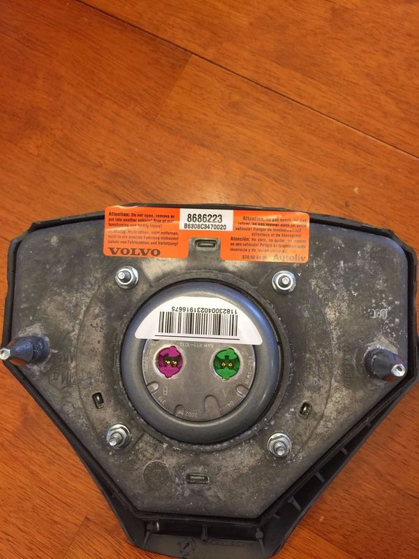

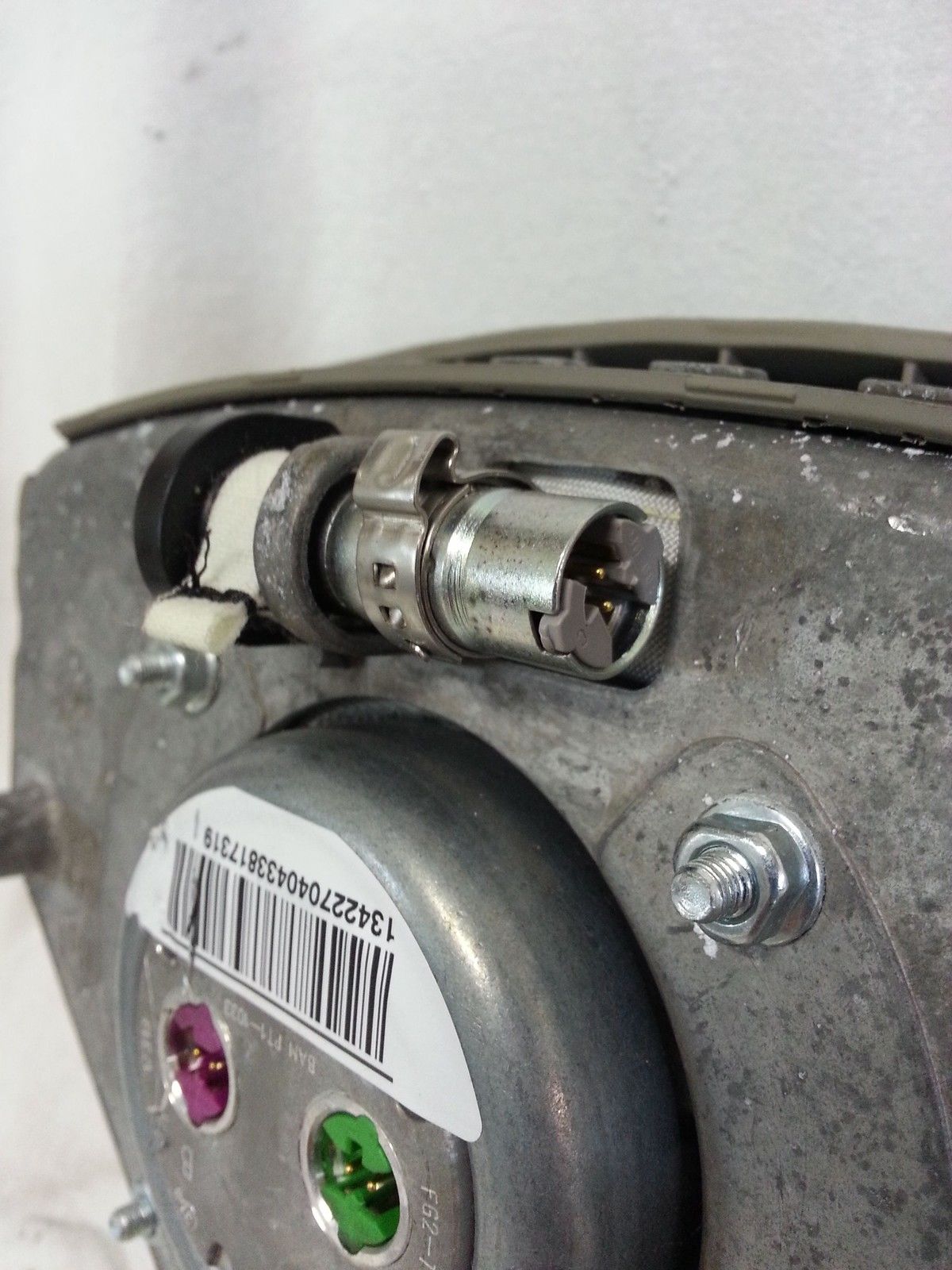

All P2 air bags SHOULD have the same connectors - one purple and one green, with one important exception - XC90 air bag part 8686223 for instance is the same as all other P2 cars, but I believe in 2005 an additional gray plug was added, thus breaking its compatibility with other P2 air bags. Additionally, P2 four-spoke is the same as three-spoke, just upside down.
'03-'04 XC90 air bag connector
'05+ XC90 air bag connector showing extra gray plug
So for my car, since I wanted to go from 4-spoke to 3-spoke with silver buttons, I bought a 2005 XC90 wheel with the right button connector for my '06 V70, another cheap 2007 S60 basic wheel with silver buttons to swap to the nice wood wheel, and a tan XC90 three-spoke airbag, part #8686223. The S60 wheel came with a vibration damper in it, so I swapped that over to the XC90 wheel too.
