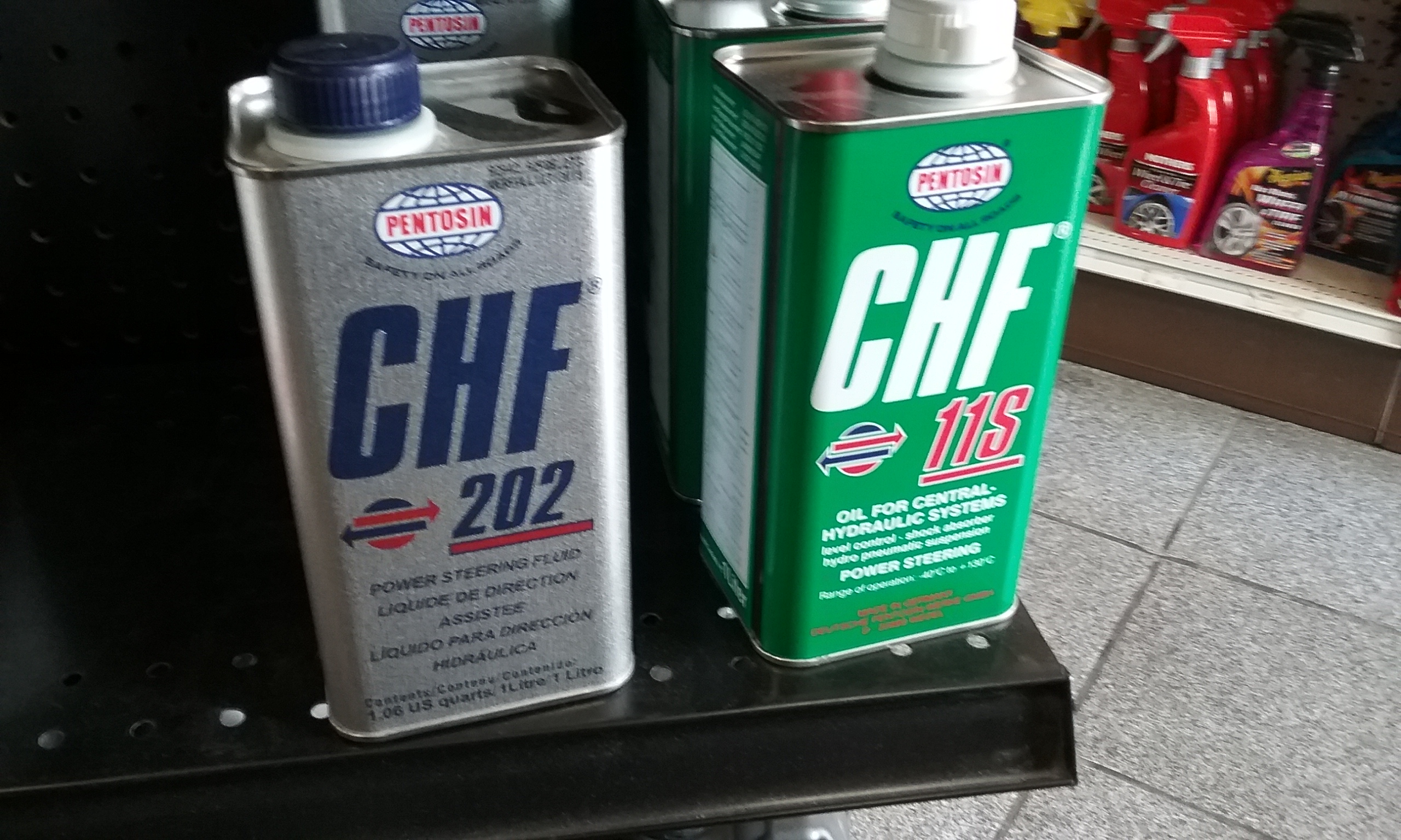

Pentosin CHF PWS fluid, comes in a rectangular green or silver can.

Thanks but too late. I already flushed it yesterday morning. The Petosin is what I was thinking of ending with. I flushed with cheap stuff and will end with something better. Do you use petosin in a 98 model car? The 98 only calls for ATF. I posted this thread hoping to find what people have had success with in a 98 that exceed the minimal requirements of ATF.shiloh51933 wrote:Pentosin CHF PWS fluid, comes in a rectangular green or silver can.
