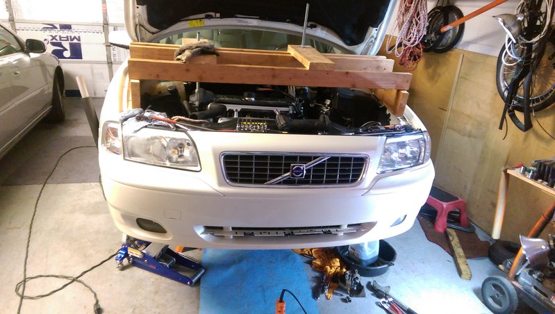

You will need to fabricate an engine support. Here is how I did mine with stuff from the local Lowes.
I use the chain to support the engine and then used a ratcheting strap, also supported by the 4x4 to lower the transmission out after I got it free from the engine.
The ratcheting strap also worked real well, along with a floor jack from below, to get things lined back up when I put the transmission back in.

This works on most Volvo models- I've used it on my 760 for an engine mount replacement, and fits good on S60 and S80, where I have lowered the whole engine / transmission. You need good size threaded rod (3/4 inch to be on the safe side) $10 ; chain links with a connector- $10 and 6ft 2x8 and two or three 2x4's by 6ft (total cost around $30)
The threaded rods should be at least 24 to 30 inches, so you can lower everything down to floor level, where the tranny separation from engine happens You have to unbolt most of the Transmission holding bolts before you lower everything down.

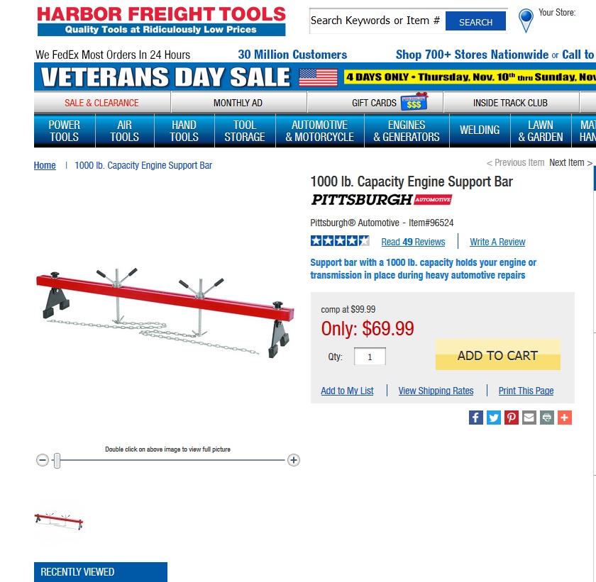

Nice wood work, I like it. But the cost of wood, rods, chain etc. will be more than $50-$60.
FYI, the price of engine support has decreased in the last few years.
Harbor Freight current sells Engine Support for $69:
