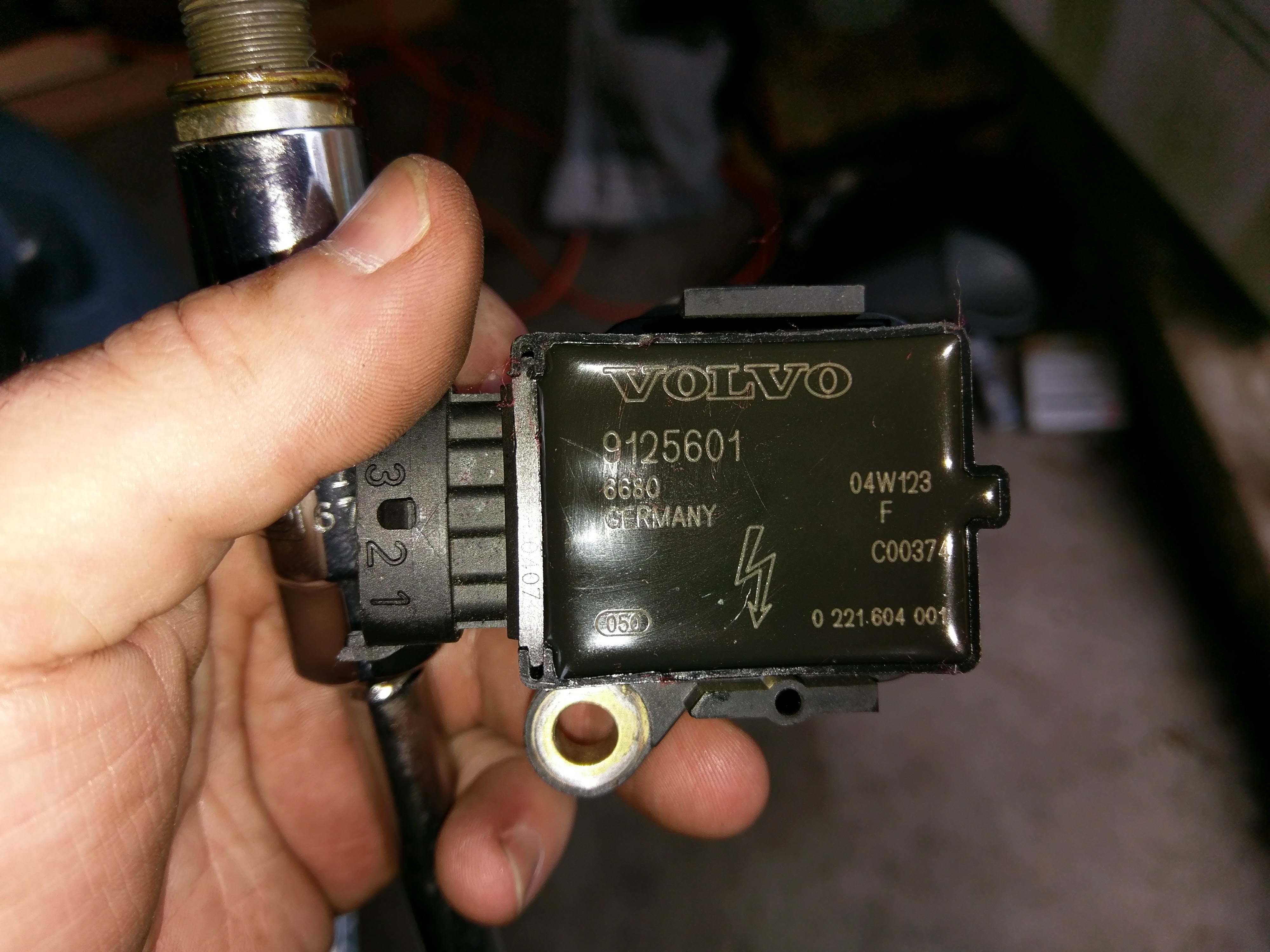

I have no idea how to read date code on the coils. The pictures are attached. I would appreciate any input.

Nice clear photos. These belong as the gold standard for posts!
Those plugs are worn out, so replacing them is good. The date codes on Bosch stuff. Are year plus a toggling month ( I've forgotten the code) but those are original 2003 ( MY 2004) coils so replace the one that one oil soaked as a start. Let's defer the vibration until you get that part. The vibration is still going away when you lift, right?

I had hard starting and vibration in my 04 XC70 at c. 165 K miles. Replaced plugs with genuine Volvo and all coil packs with Bosch. Ran like a top afterward. You're right on schedule for a complete replacement. You can replace a coil at a time if cash is tight, but I tend to do them all at once for peace of mind.
And Steve is right. The date code starts with year '04 and W = week, so I am thinking 12th week of '04, or end of March. Definitely OE. They don't owe you anything. You'll be amazed at the difference on replacement.
