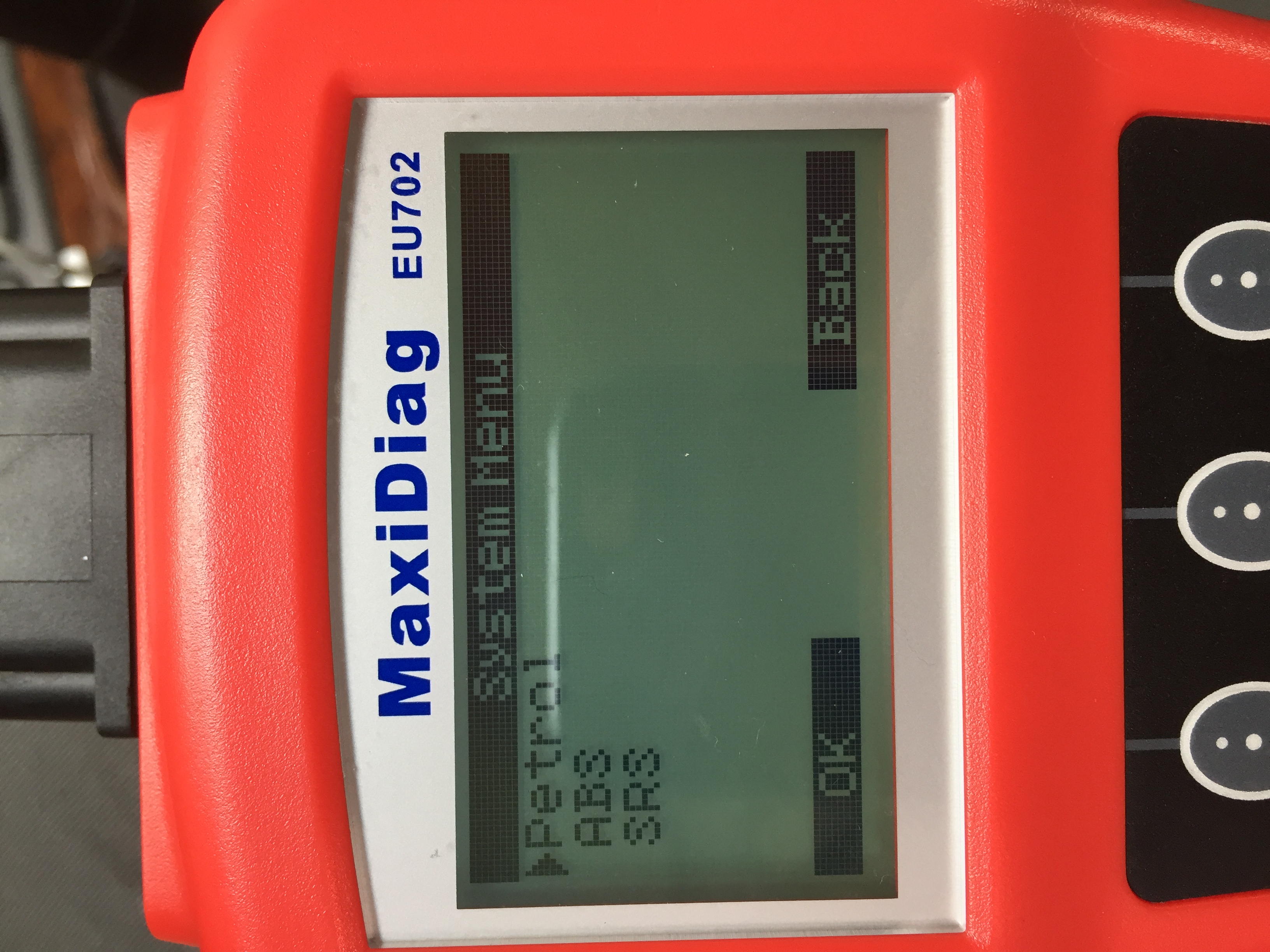

I was able to get the reader to work again and took some pictures. Thanks for your help.
Alan
Here are the pics of the reader. Thanks.

I think you are in the diagnostics system and its got the wrong software for Volvo
Go back to the OBD menu and read the DTC codes and see if you can pull out a Pxxxx where xxxx are numbers from that menu
