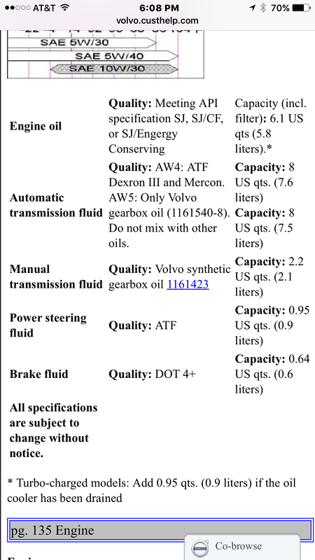

Let's grab the 2000 Volvo manual as the reference here, please

I spoke to one of the parts guys at dealer and he says they only sell the 'green' power steering fluid now (Pentosin?). He used to be a mechanic and he says it is compatible. I am astounded that Volvo just say a 'Quality ATF'. No spec number?
Thanks,
