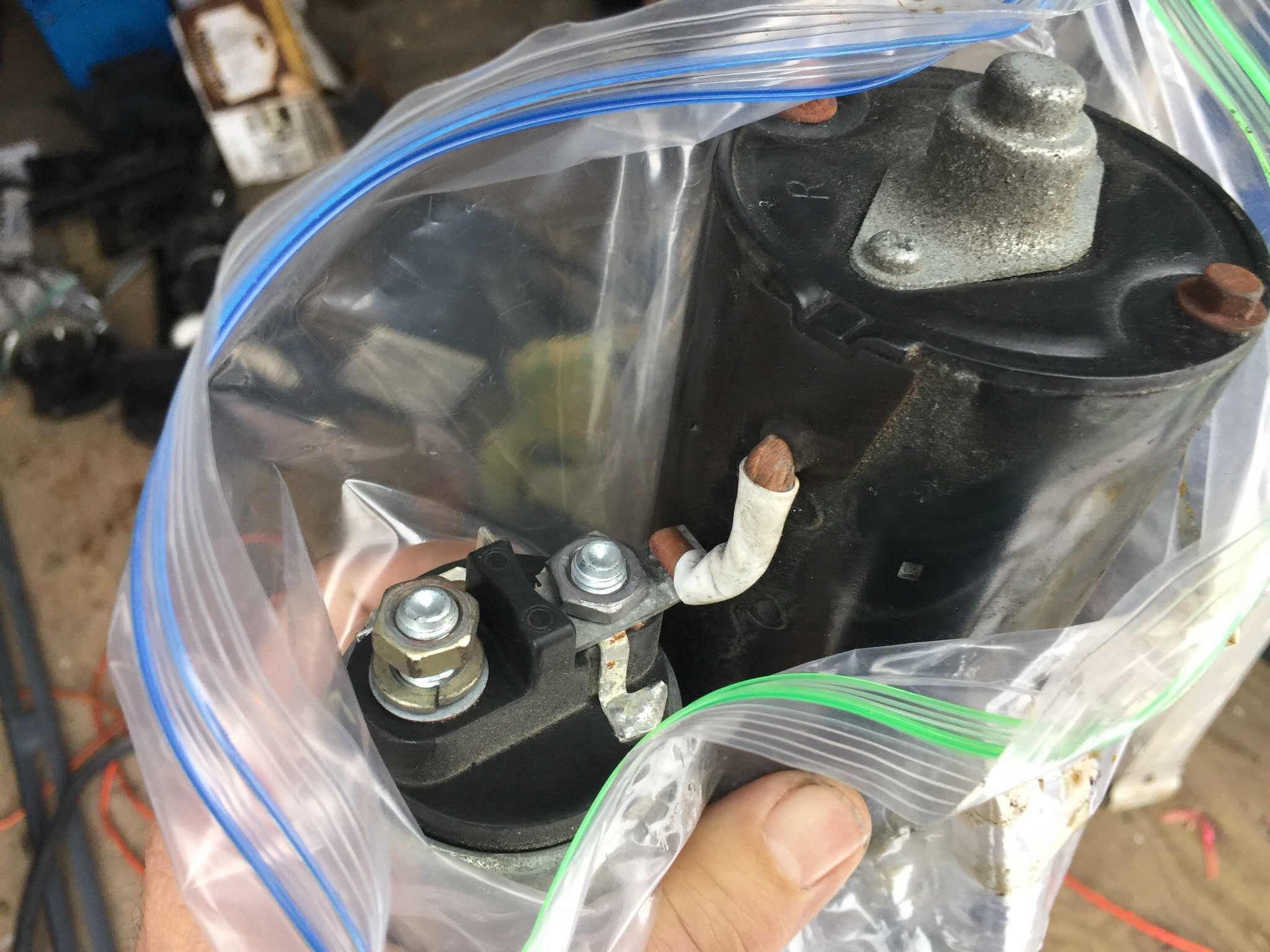

I think you will find this is a bad connection on the starter - between the positive battery wire and the solenoid.
The 'few second delay' has happened to me on two cars and this was cause on both. Since it is reproducible, this makes it scientific.
Im talking about the small connector that carries the current from the solenoid to the actual motor, not the battery cable.

Picture of the connecting pigtail, Zben. See if you can spot it on the starter. It might be under a plastic cover that snaps off the starter.

got it, you're exactly right. i disconnected the blade connection, sanded the contacts, sprayed some wire drier in there, boom v70 fired right back up like she always does (currently 4/4 starts). i must have neglected to clean up that connection when reinstalling the starter post-engine swap last month.
i think i'll pull the starter and clean the contacts better, couldn't really get at the base of the male connection, limited access. i'll be doing a pvc job next month, so pulling the starter won't really add much to the work time.
thanks as always neil and abscate.

That's the starter off my parts car by the way. Score!
