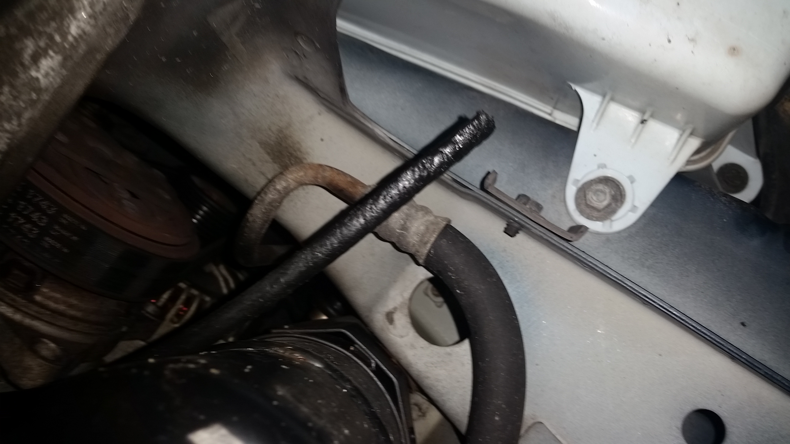

- Overall sluggishness. No ziptang
- I feel a slight vibration coming through the steering wheel when driving. More pronounced when idling. To my ears the engine sounds fine
- There's an awkward jolt if I'm coasting anywhere from 5mph to 25mph and I depress the gas pedal
- P0455 – Evaporative emission (EVAP) system -large leak detected
- P0410 – Secondary air injection (AIR) system -malfunction
- P0300 – Random/multiple cylinder(s) -misfire detected
- P0304 – Cylinder 4 -misfire detected
- P0171 – Fuel trim (FT) system too lean, bank 1
- P0172 – System too rich, bank 1 (System too rich, bank 1)
1. Use a flashlight and some carb cleaner to try and find vacuum leaks
2. Change out spark plugs
3. Volvo Manual says I'm due for a timing belt
4. Check fuel injectors
5. Check fuel pressure
6. Clean out PCV system
