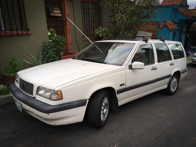

Howdy. I'm in Los Angeles for the winter, so I figured I'd pick me up some wheels to roll around in and take me back to NYC once it thaws. So, I picked up this weathered whale. The photos are hiding cosmetic flaws, but so far it's got it where it counts, and there is just about zero rust. The plan is to spruce it up a bit and just see if it'll get me home. Hopefully it'll go farther in my stead than Varg did.

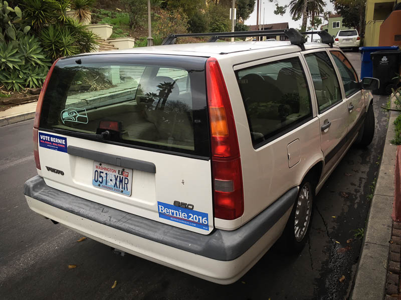

The real cosmetic flaws I see are the Bernie stickers. :)
Nice find! And like abscate said, don't bring it back across the country without a PCV check and known history on the timing belt.
