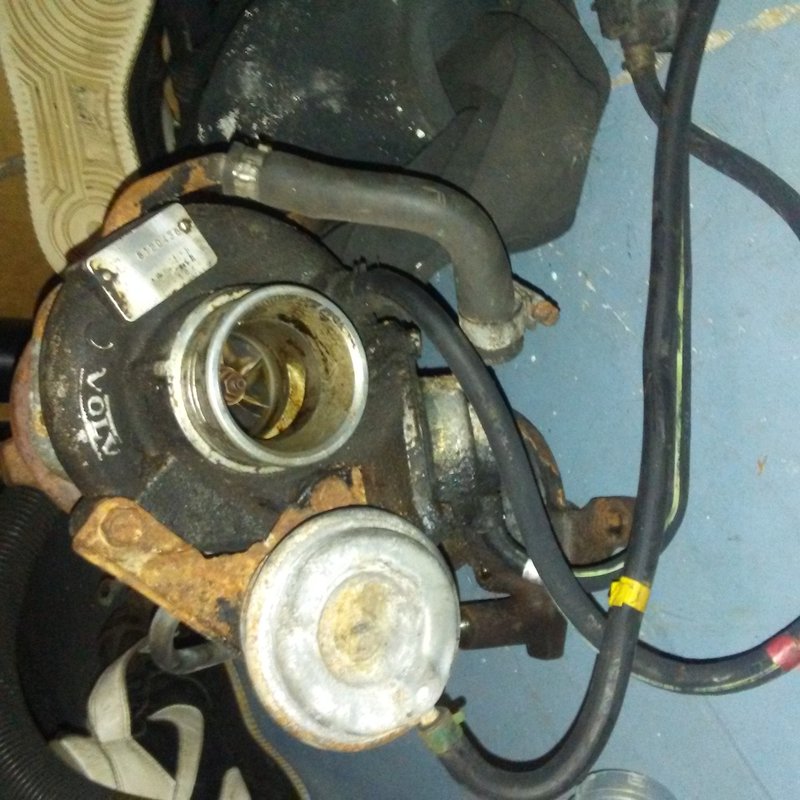

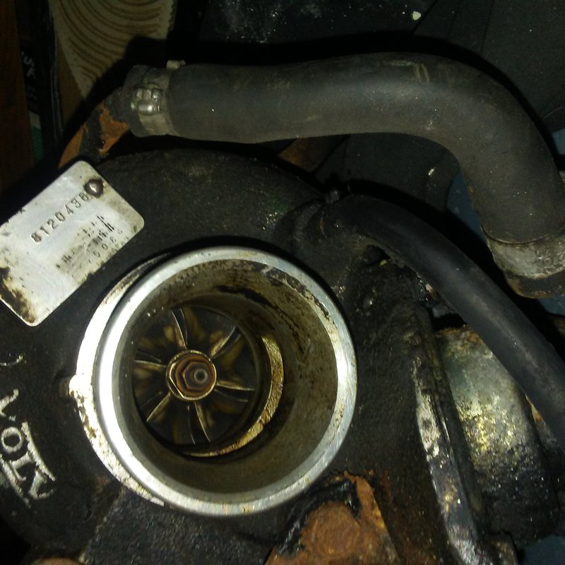

Found this turbo in a 98 v70 at a local pick n pull however the tag with info is completely wiped off, my guess would be a stock 13g turbo but there were other parts in the trunk from different year Volvo's so I'm not sure..Can anyone tell me what turbo this is...thanks

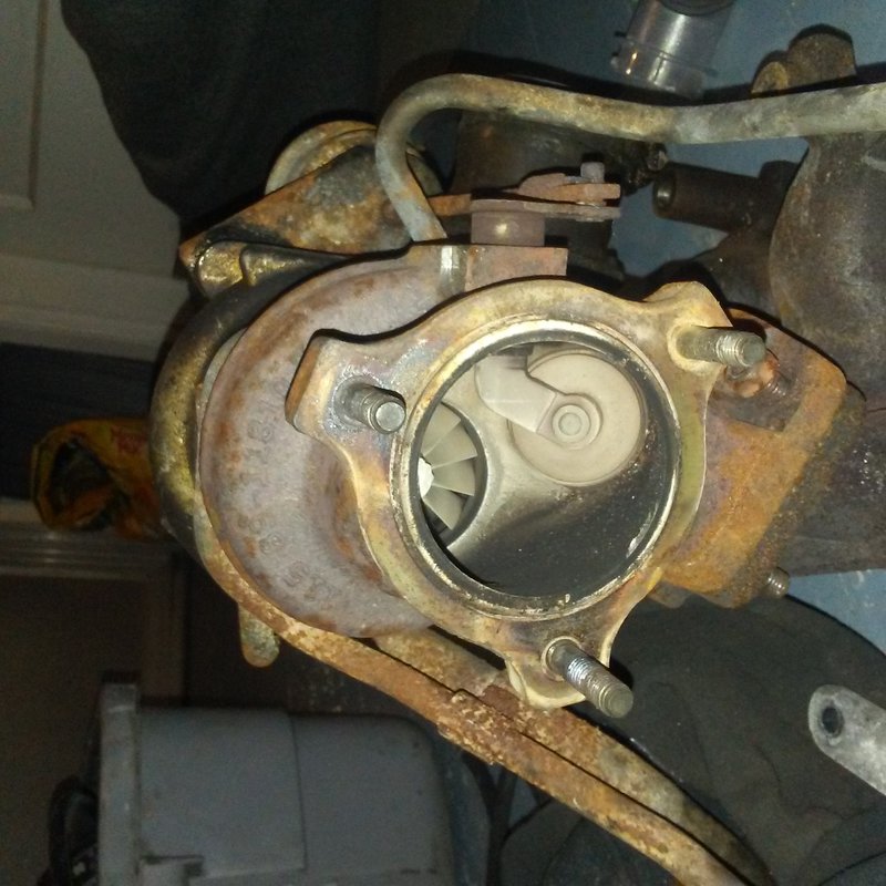

Not without measuring the compressor wheel. The back end looks good.

Its a 13, i just pulled one from a similar v70 check it out

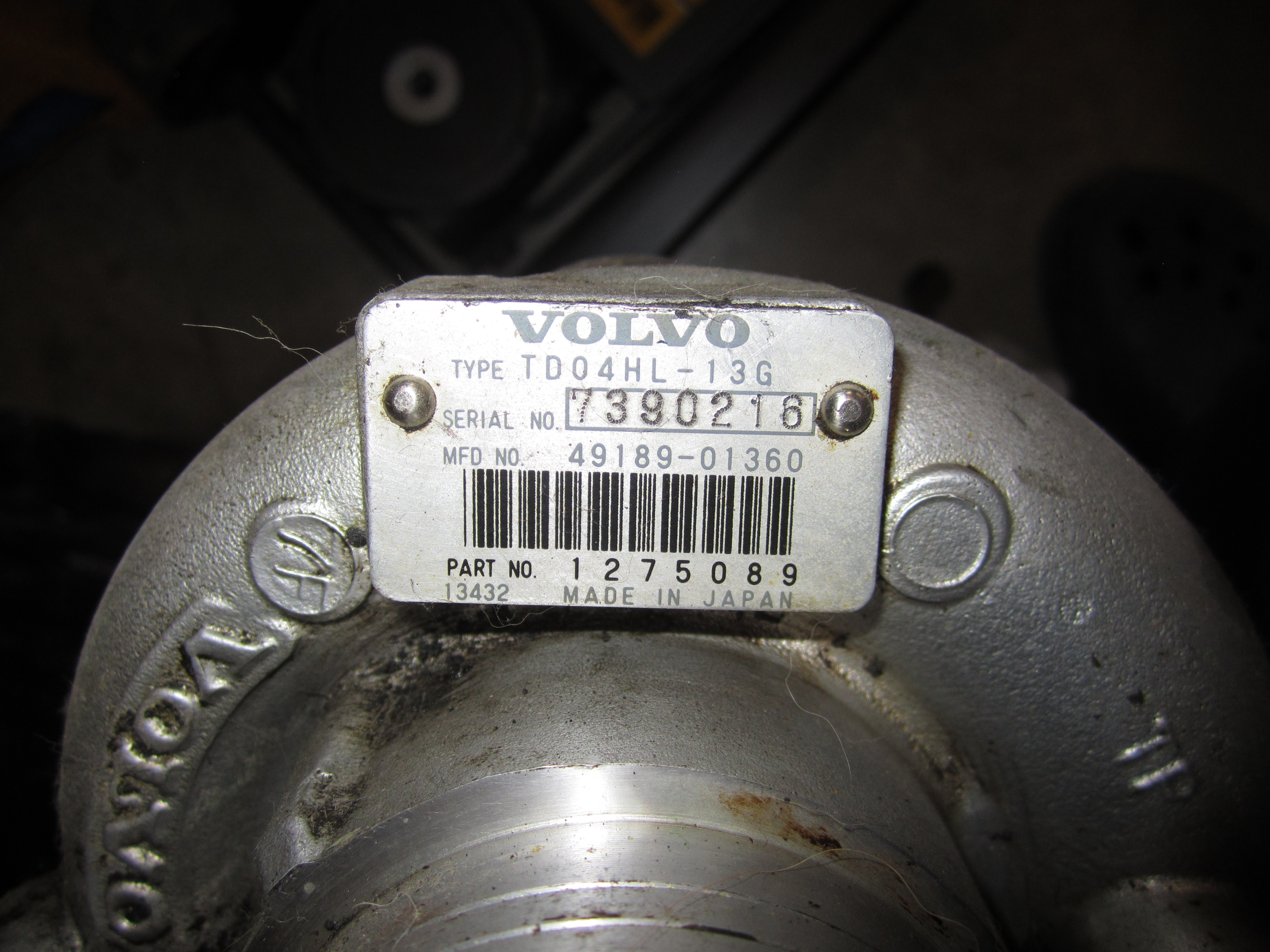

The part of the part number left on the bottom of the tag is the same as on a spare 13G I have:
