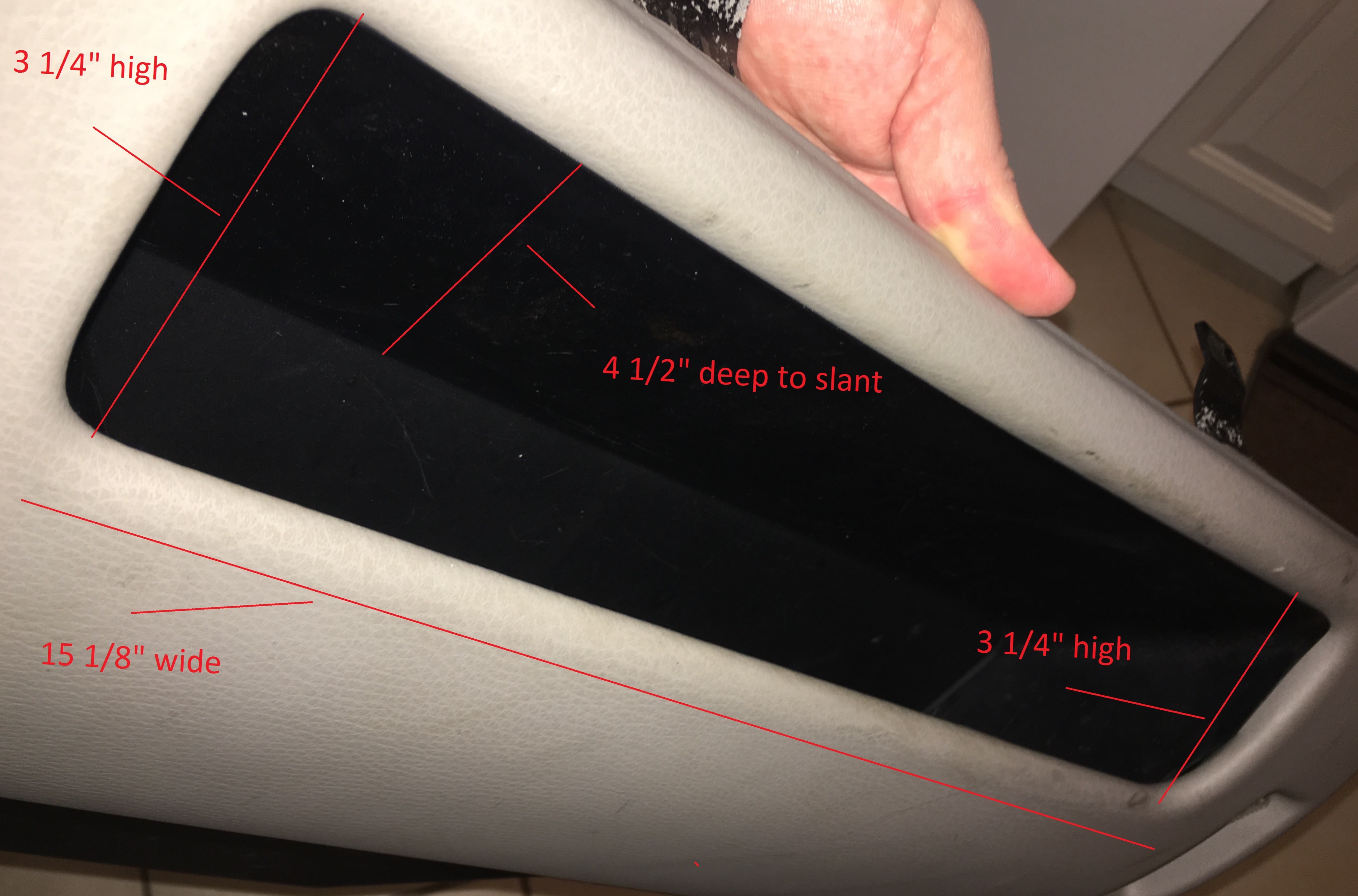

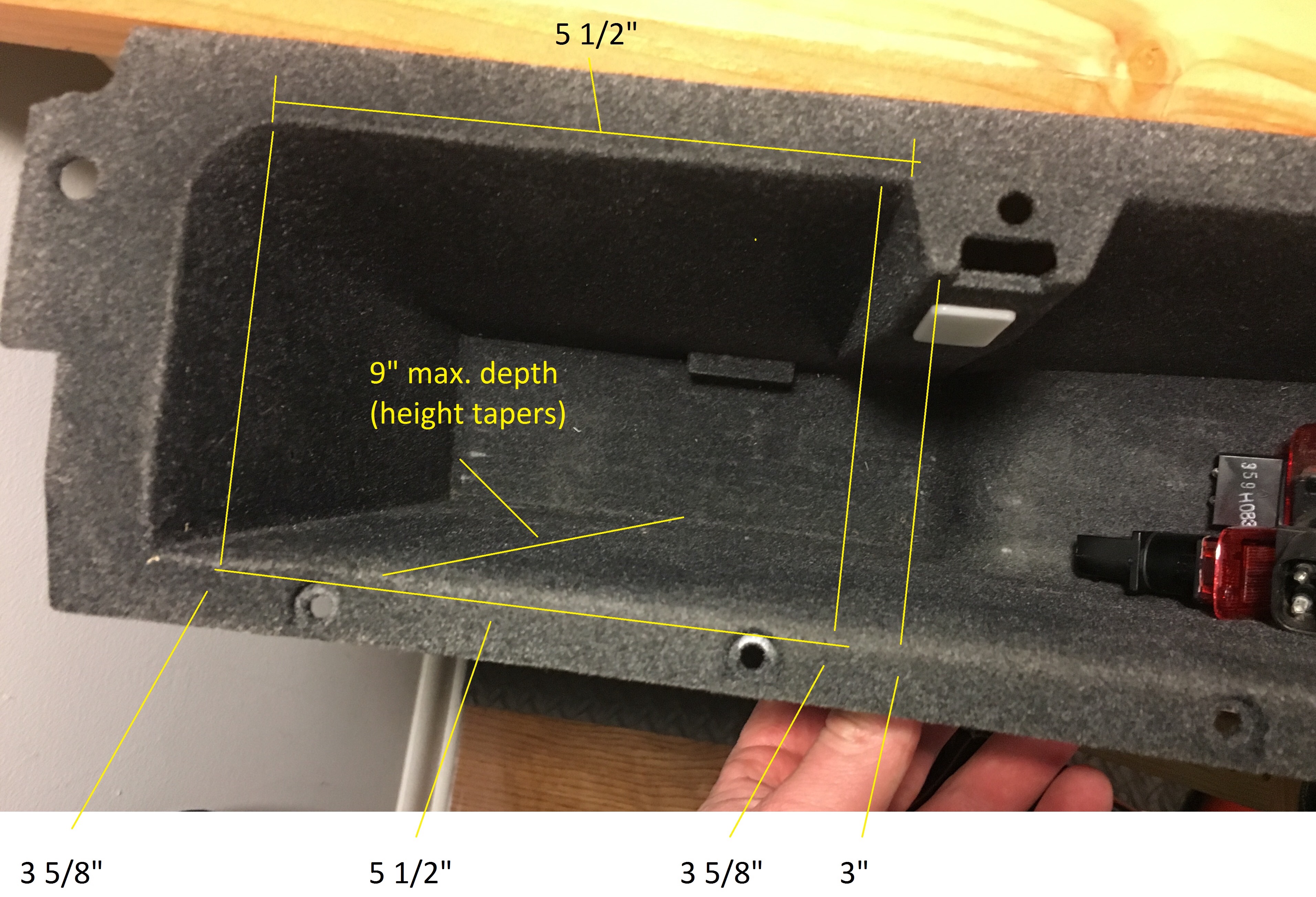

I've been trying to figure out a way to put a CB radio in a P80 chassis Volvo over the last few months. I got my hands on a map holder trim piece and a spare glove box insert and I took some measurements.
While the potential CB project is on hold until I get some more pressing issues squared away on the car, I decided to take some measurements on the two components before I put them in my storage room. This way I will have the photos to reference saved on my phone.
The idea was to mount a micro-framed CB unit into the map tray, or an all-in-one unit like a Cobra 75. I also considered mounting the unit into the left side of the glove box and drilling a hole to run all the cables out the back.
Not sure if anyone has ever needed or thought about these dimensions, but here they are for posterity's sake (lol)

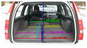

Not mine but handy too
