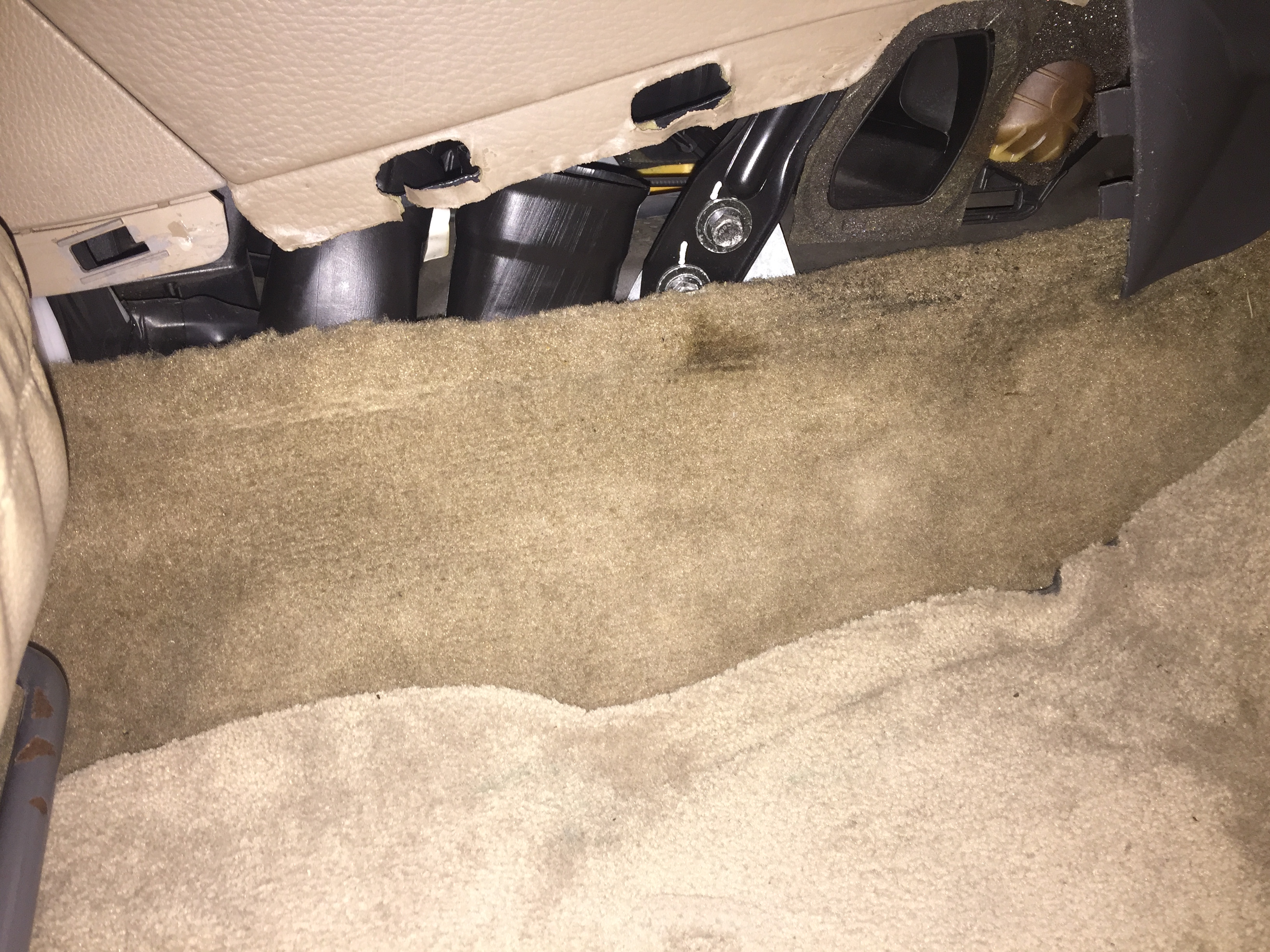

In My 2003 S60 air is not flowing through the vents when having the outside air or recirculating option enabled, however, it works when using a/c as i can feel air running through the vents. Why would it work with a/c only? Also i found this plastic tube by the passenger side close to the Center console and it seems it's missing a duct piece
Help me sort out this issue with the HVAC vents

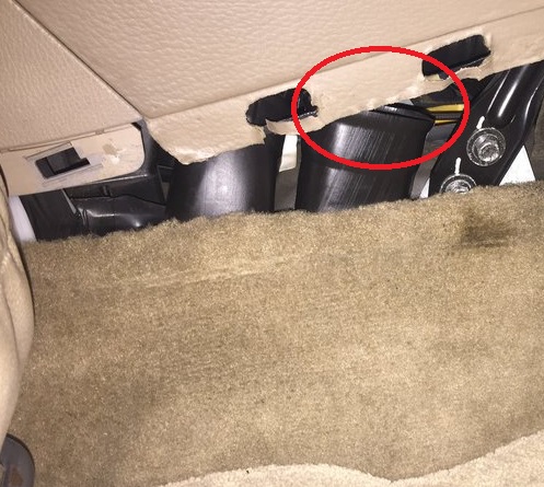

Looks like it got disconnected, not exactly easy to press back on. It's for the floor heat.
As for the climate unit, it may be a broken swirl arm, or the motors need calibrated
