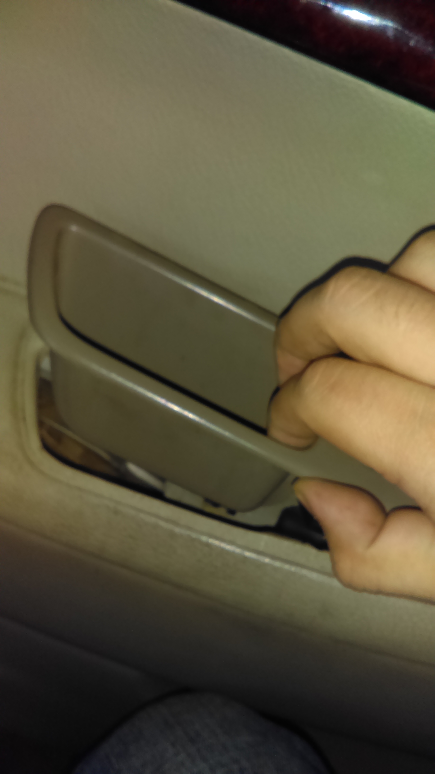

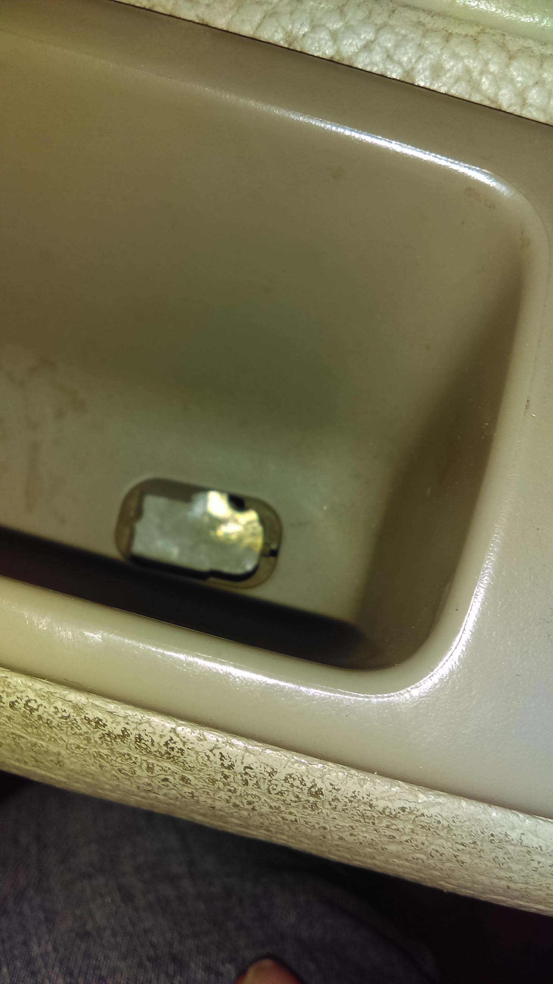

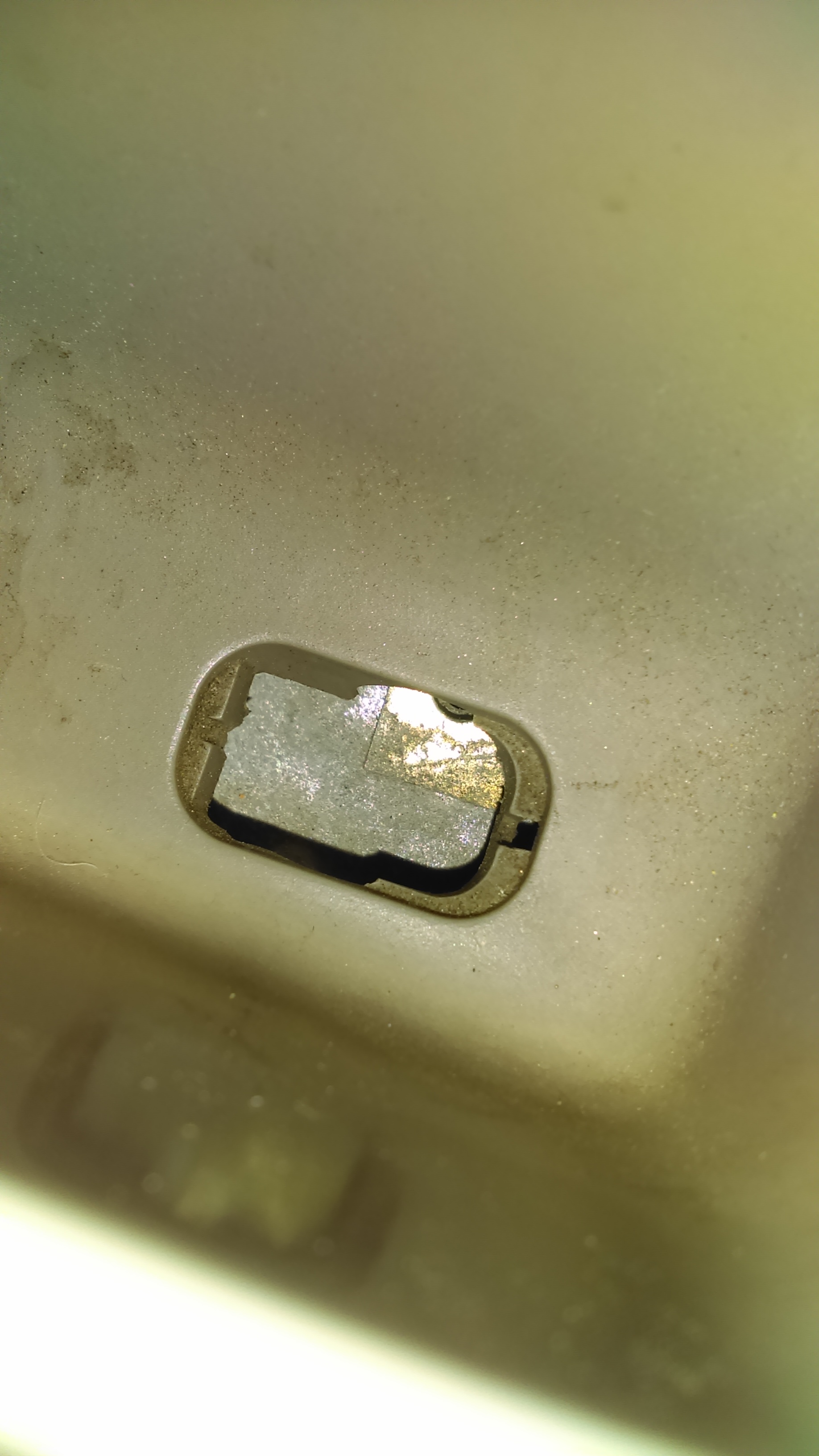

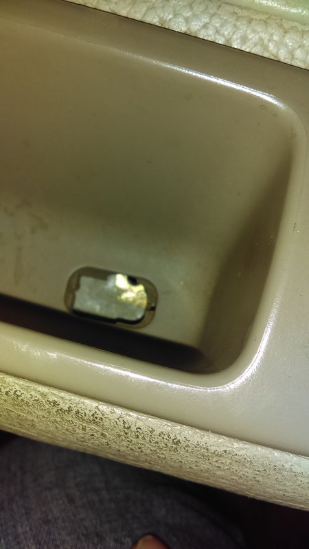

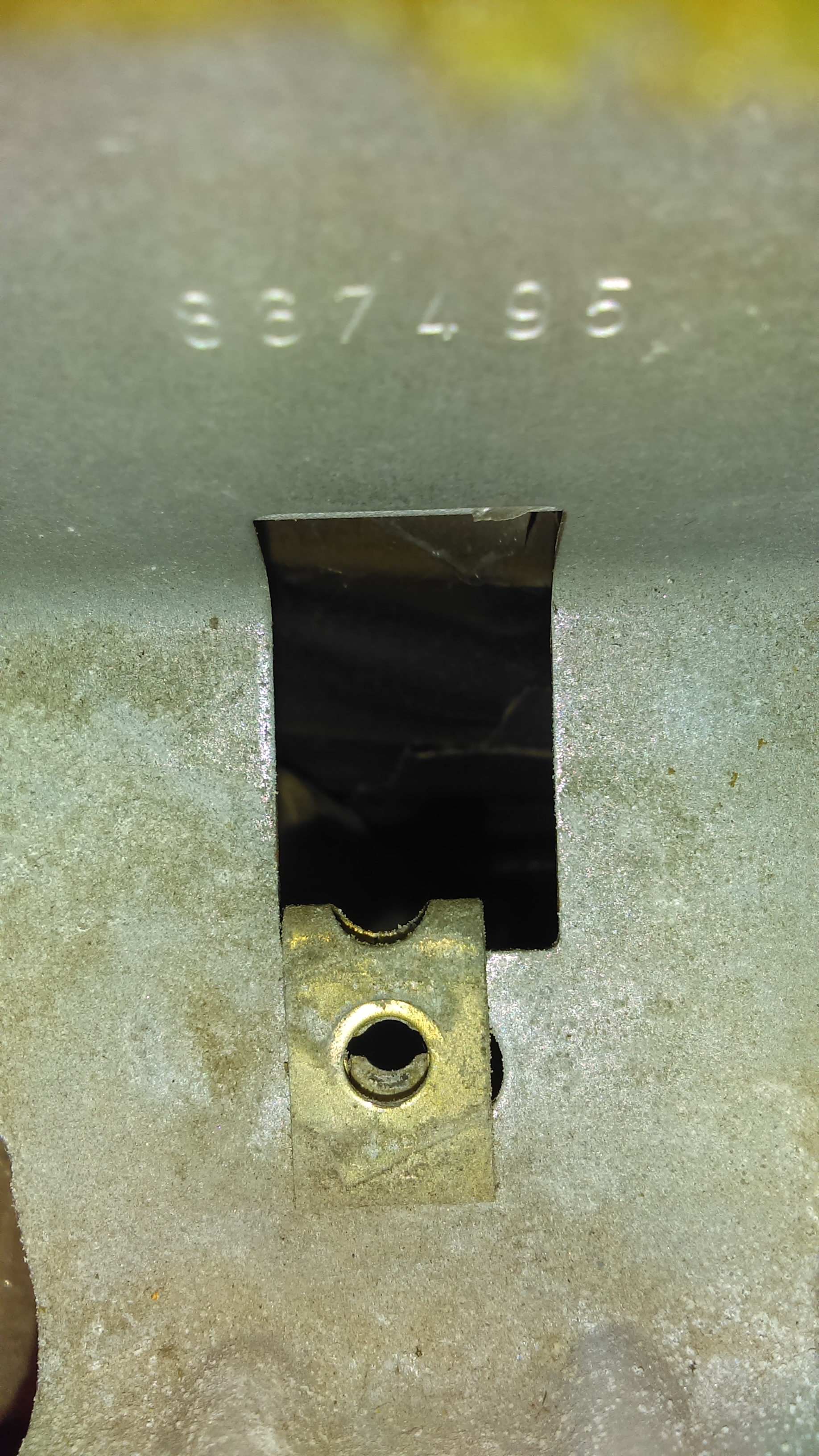

and one other thing not about the cigarette socket, on my doors the panels come out and i was wondering if anyone knows where to buy something to keep them from coming off every time i try to shut my door, i would really appreciated i know these stuff are little things but i just got done fixing my car with stalling problems and now i'm focusing in fixing the small things and making my car more comfortable. i have pictures of what i'm working with i'm in the process of cleaning the entire car since the car was sitting in my garage for 2 months don't mind the dirt thanks again.

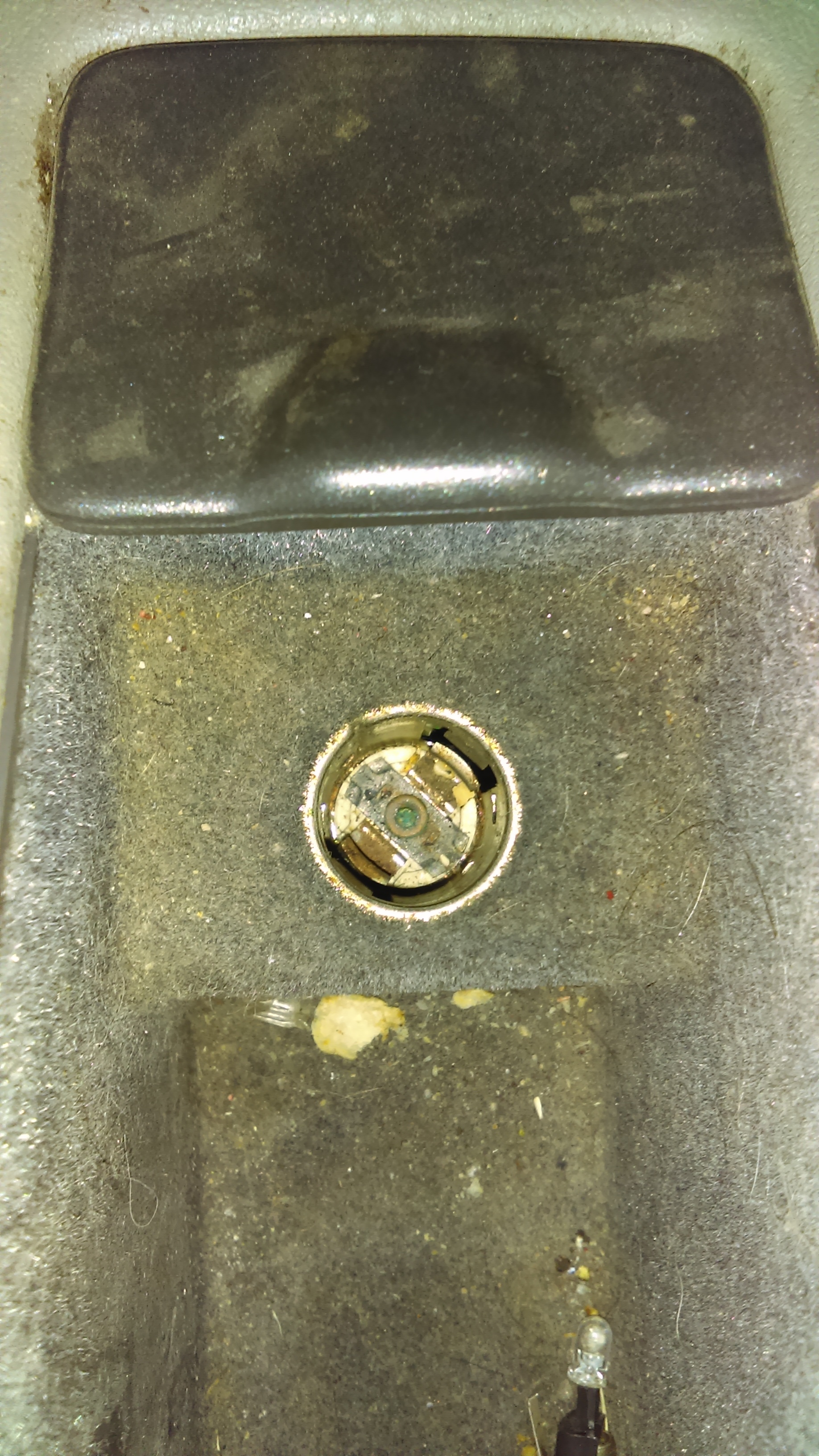

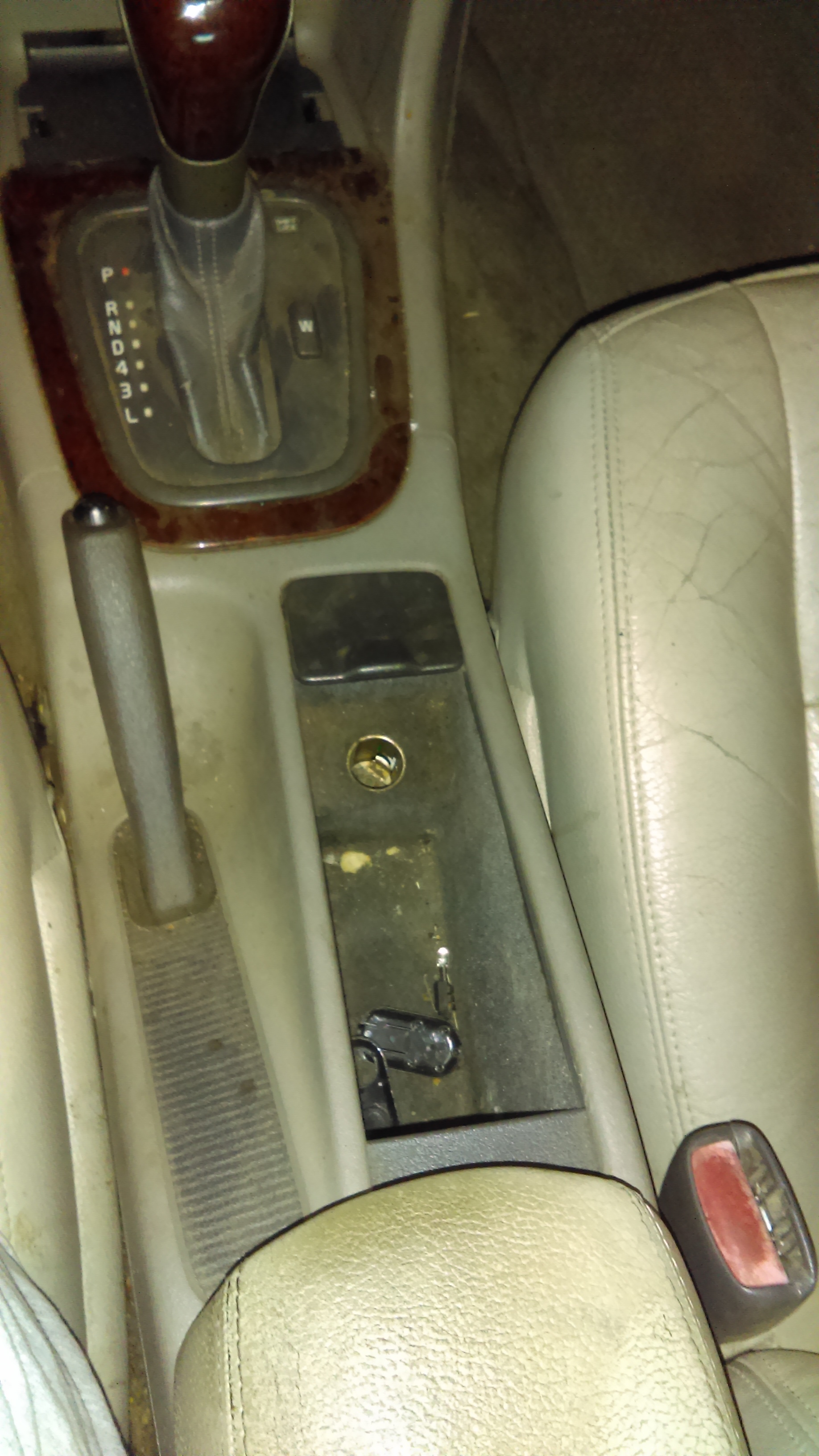

hello everyone i have an s40 2001 my cigarette lighter plug isn't working i have check the fuse and wasn't burned out but i decided to replace it anyway but still no good so i was recommended to just replace the socket itself but there's a problem i don't no where and how to remove the center console so i can replace the cigarette plug can someone please explain how to remove the console, its not an urgent repair but i would like to be able to charge my phone in road trips. thank you

IIRC...it's been a few years, but I don't recall it being very difficult to remove the console:
Pull the cover from the bottom of the armrest compartment - there should be 2 screws there;
Pull the "wood" shifter surround and I think there are 2 screws there;
Pull the rubber mat that is lining the slot under the radio and push the two tabs toward the center (or maybe there are screws there too(?)).
From there, I think the console just lifts out.
Like I said, I don't remember it being very complicated.
