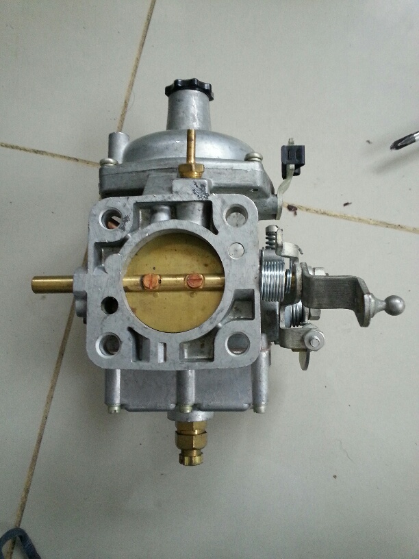

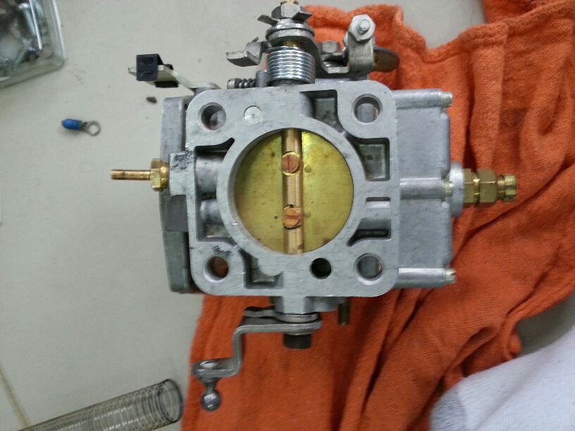

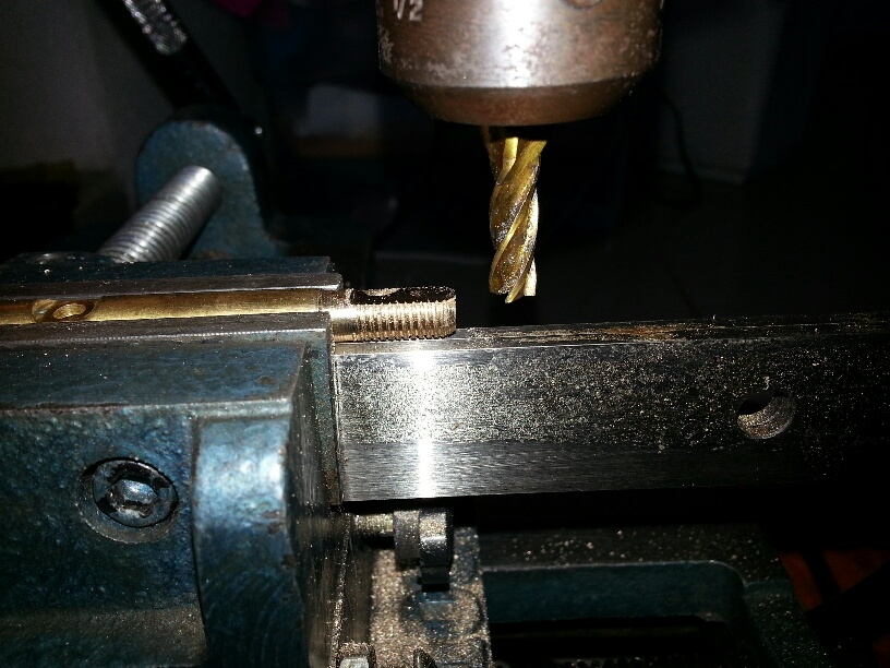

Hello im working on same conversion...found a NOS Zenith stromberg at ebay from a Rover too.
You must change accelerator linkage side...remove copper pipe (use a 3/8 drill) and a vise grip..to prevent deformation,, it allows you to remove without damage.
Today i will install and test..but im sure that mixture will be too rich.. (rover is 2.6L).
check this pictures,..will help you maybe..
regards
Rodolfo
Guatemala, Central America

93Regina
Posts: 2813
Joined: 18 Jan 2014, 19:11
Year and Model: 93:240/940
Location: Sunflower State
Been thanked: 65 times
Post by 93Regina »
claymore850 wrote:im sure that mixture will be too rich.. (rover is 2.6L)
If there is an available vacuum port on intake manifold, one might attach one end of a rubber hose to this vacuum port, and the other end to a gasoline filter, like a Fram G1000. Ideally, the vacuum port would be in a central location.

claymore850 wrote:Hello im working on same conversion...found a NOS Zenith stromberg at ebay from a Rover too.
regards
Rodolfo
Maybe the metering rod and/ or metering jet can be swapped over from the original carb. British Leyland tuning guide shows a main mixture adjustment under the plastic cap.
