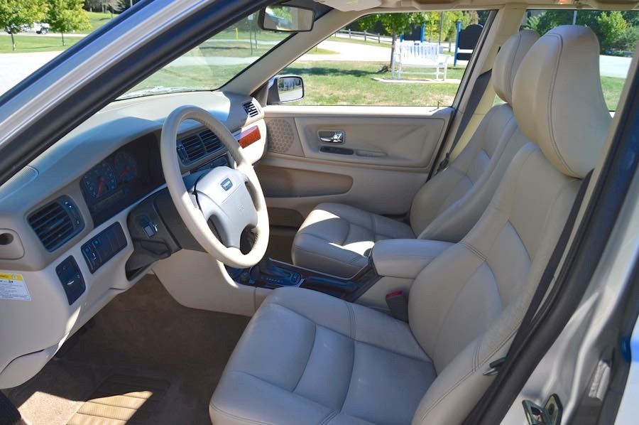

We are doing mine now the hard way on my 2000 S70 time capsule with 30K miles
I found tan V70R leather door panel inserts. (By their design, these never come apart). I had them refinished to match and now we're "mating" them to my perfect existing outer panels.
Not for the faint harted! Two weeks, two doors completed! *(&#$(*$^&*#^$&*# slow and tedious.
In a week or so, these 4 panels will be PERFECT!
