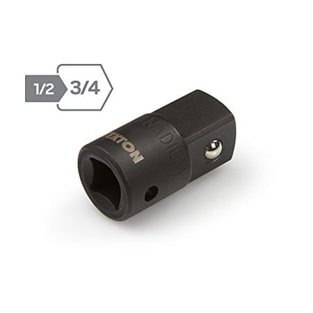

Just changed my tensioner today, and this combo worked great. I used a 1/2" to 3/4" socket adapter and a 19mm open end wrench. The drive part of the adapter is long enough to go into the tensioner and leave just enough space for the wrench.
I tried using the adapter on a 1/2" ratchet a while back, but that didn't work since there is no room in the fender for the ratchet head.

bmdubya1198 wrote:Just changed my tensioner today, and this combo worked great. I used a 1/2" to 3/4" socket adapter and a 19mm open end wrench. The drive part of the adapter is long enough to go into the tensioner and leave just enough space for the wrench.
I love this. But I think it costs more than a couple of quarters... :D

Haha, true, but I already had the tools on hand. I don't even know what that adapter cost, but it's a 3/4 inch and it's from Northern, so it probably wasn't cheap. I actually tried the quarters and vise grips first, and I bent the heck out of the quarters. As long as they're still worth 25 cents if material is missing :lol:

I would add that I needed to grind just a tad off of two sides of the adapter to make it slip in so much easier. Such a small tad that even though I own no 3/4" sockets I think it would still be usable in one. Perhaps 0.5mm off of the two sides.
Biff bam boom with a 3" portable grinder while I had it mounted to a breaker bar. Three 850's in the five Volvo fleet now handled. The 745 manual turbo and 780 are so much easier to work on!! ♥
