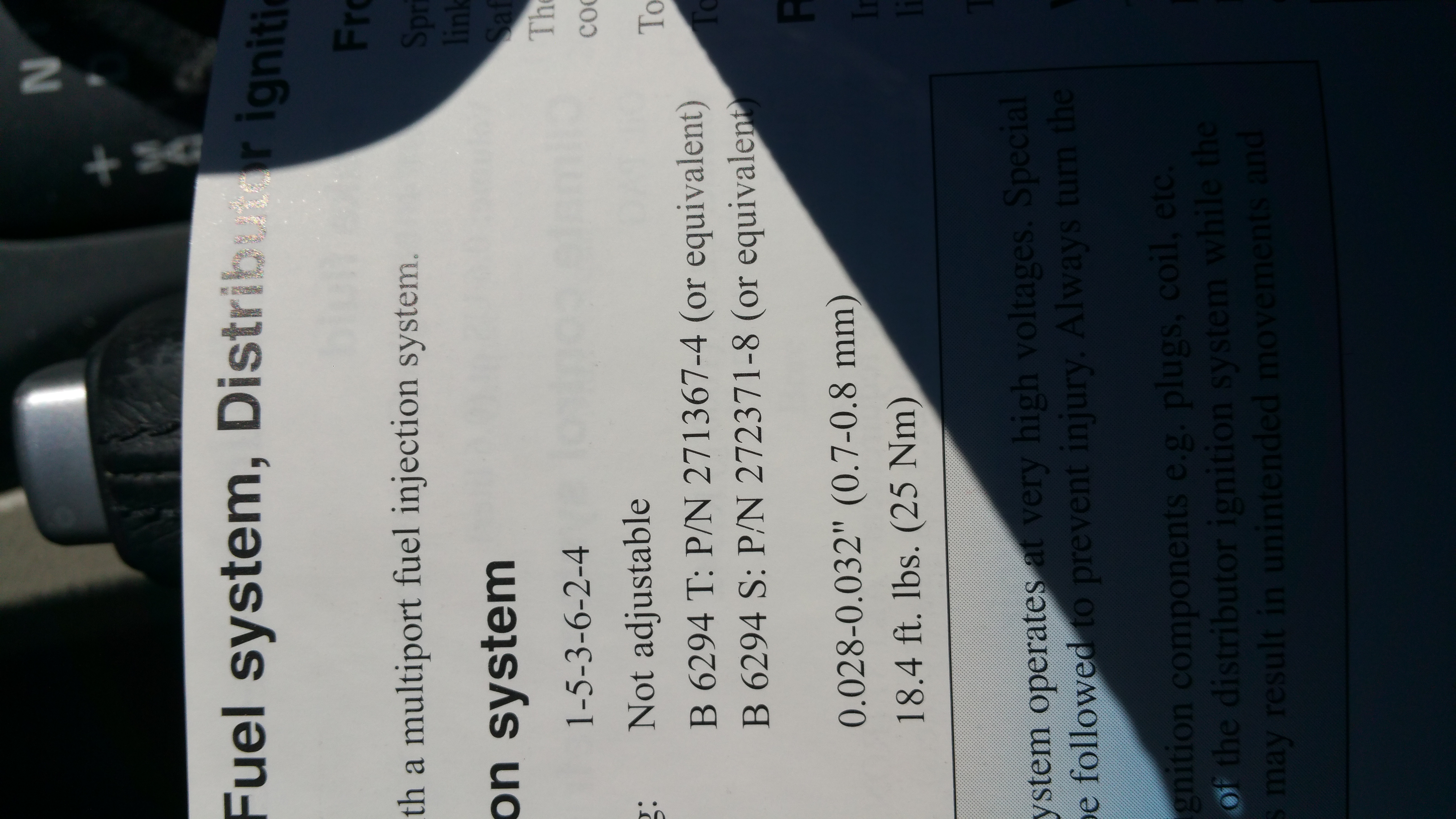

The correct Volvo part number is in your owners manual. I have seen all removed plugs from all Volvo cars I have owned but the 850 which locked up less than a year old and the S90 which was a total at three weeks old. None had platinum plugs and the V70 GT had the high pressure turbo. Here is a picture of the plug number for 2004 S80 2.9 and T6 from my manual. Look in yours and then cross reference the number rather than trust a non Volvo retailer. June

What factory retailer? My information is from the FSM like I originally stated. The FSM stands for factory service manual and platinum plugs electrodes don't really look much different than copper. I think your talking about Splitfire spark plugs or plugs that have multiple ground electrodes. Your owners manual isn't specifically for the S80 T6 model, it also applies to the N/A models. I'm pretty sure the S80 T6 is a 2.9L V6 engine and the factory Volvo plugs are platinum. The non-turbo Volvo's don't use platinum plugs and the Volvo plugs are Bosch plugs. This is the information that I'm getting from the FSM, this is why I started this thread. Copper conducts electricity better than platinum and is usually better in high performance vehicles but erodes faster. Check out this thread "spark plugs: copper vs iridium vs platinum ff#32".

Just to satisfy my own curiosity I called my Volvo dealer and asked what type of plug ie platinum, copper, etc original equipment plugs are. I was told Volvo does not use platinum plugs in the modular engines but they are basically copper plugs branded by Volvo for Volvo Service replacement. In this car I have seen two sets, the factory that came out and the first service replacement set. I always ask to see the old plugs to see the color and condition which I was taught tells if a cylinder is not right. Both sets of platinum plugs I have seen are clearly different looking at the electrode than a standard plug. Once in dad's Buick and a set out of my sister's 2007 Chevrolet Impala when it was 100K old. If you really want to know call your local Volvo dealer parts department, that is who I was referring to in my previous post because your dealership is Volvo's retailer. June

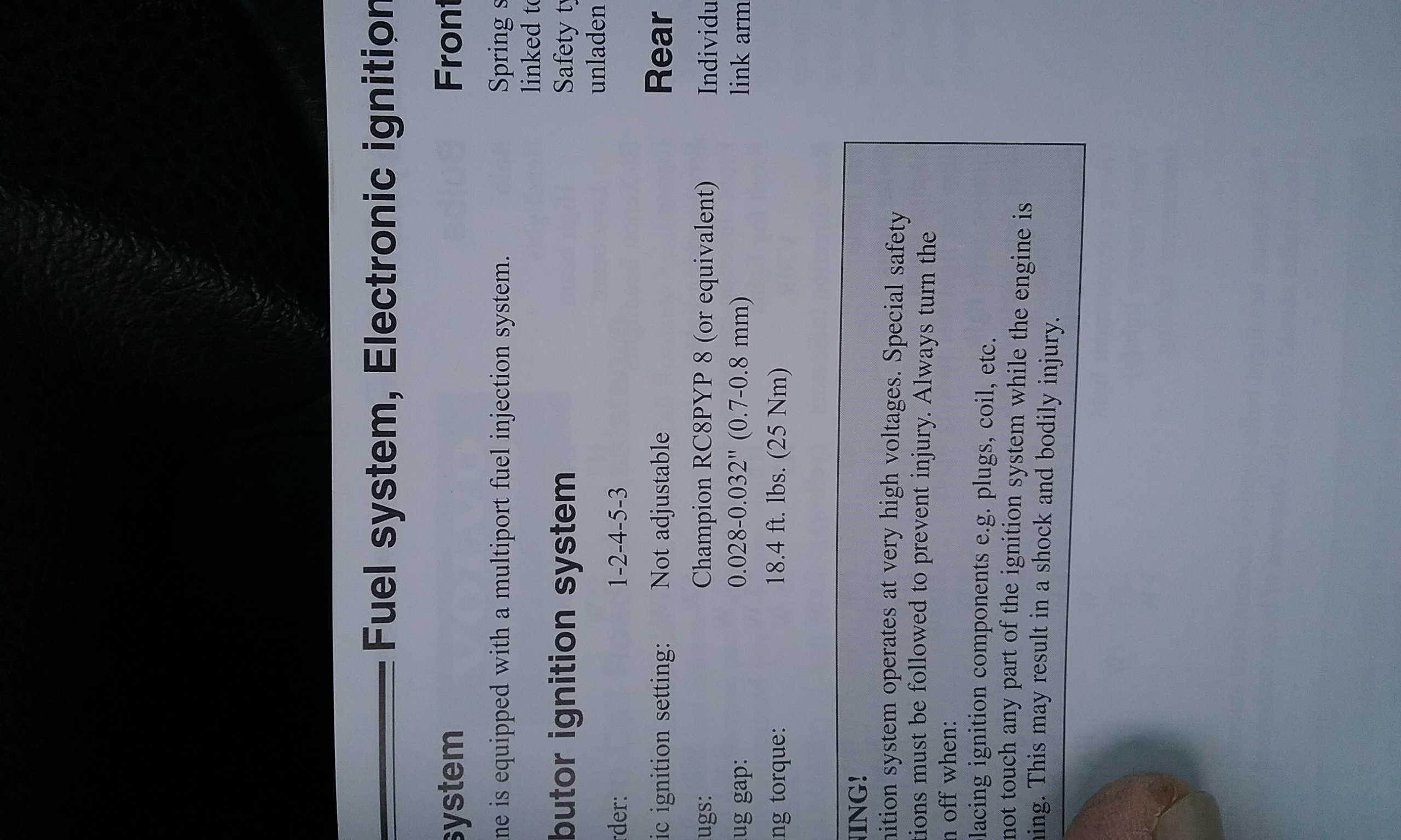

2004 Volvo XC70 Owners Manual
They no longer make that Champion Spark Plug but it was a double platinum plugs and now Bosch makes the factory plug.
