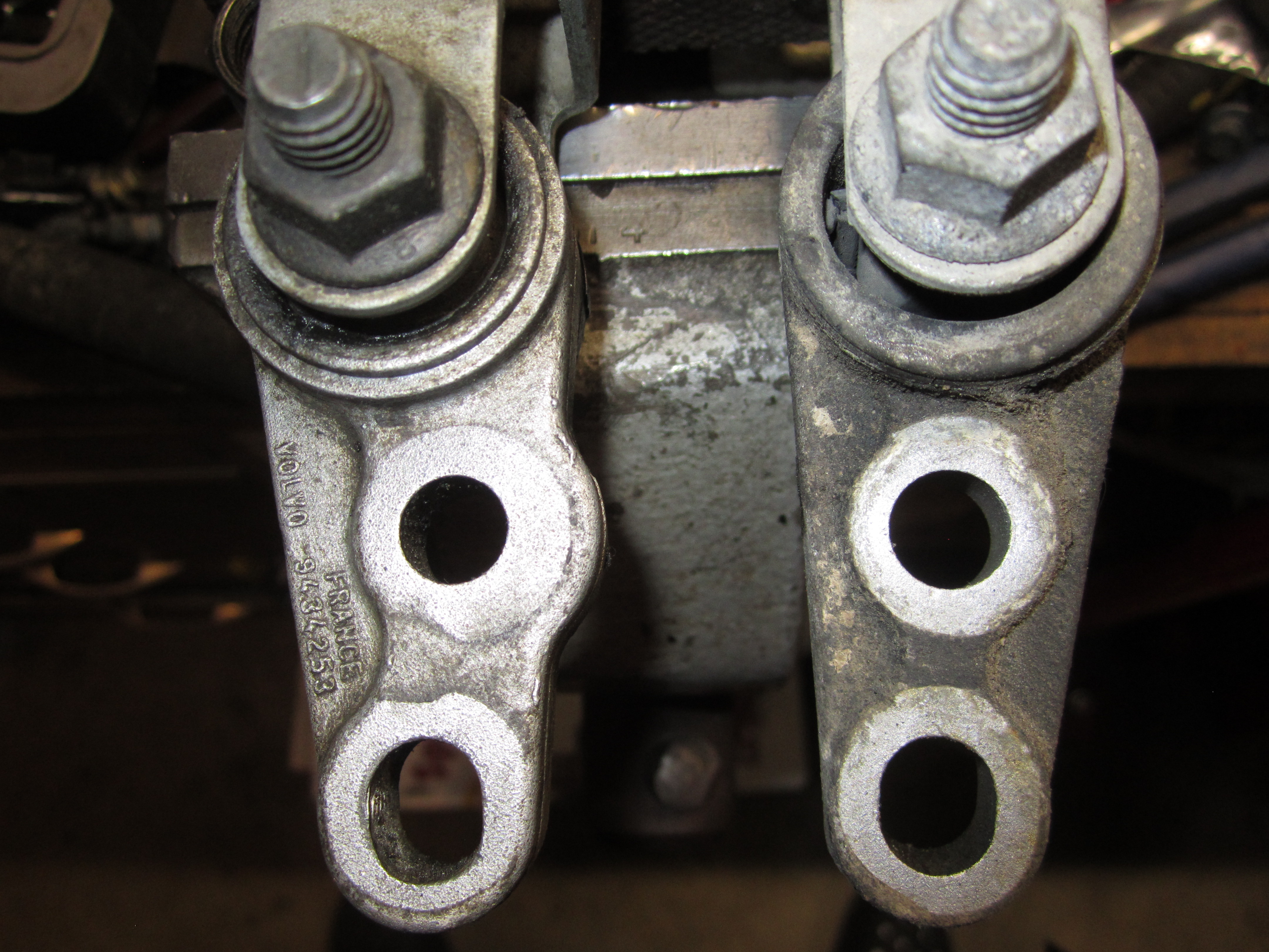

To try to help the debate, I pulled the lower (broken) torque mount from my 2000 V70 NA FWD today and compared it to one of the old AWD versions I have and took a few pictures to try to help others see the differences.
Some of the differences I'm not sure I can explain why and if they may make any difference, and most likely none at all.

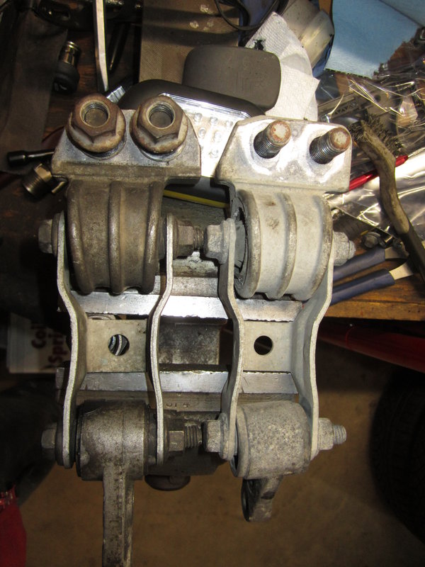

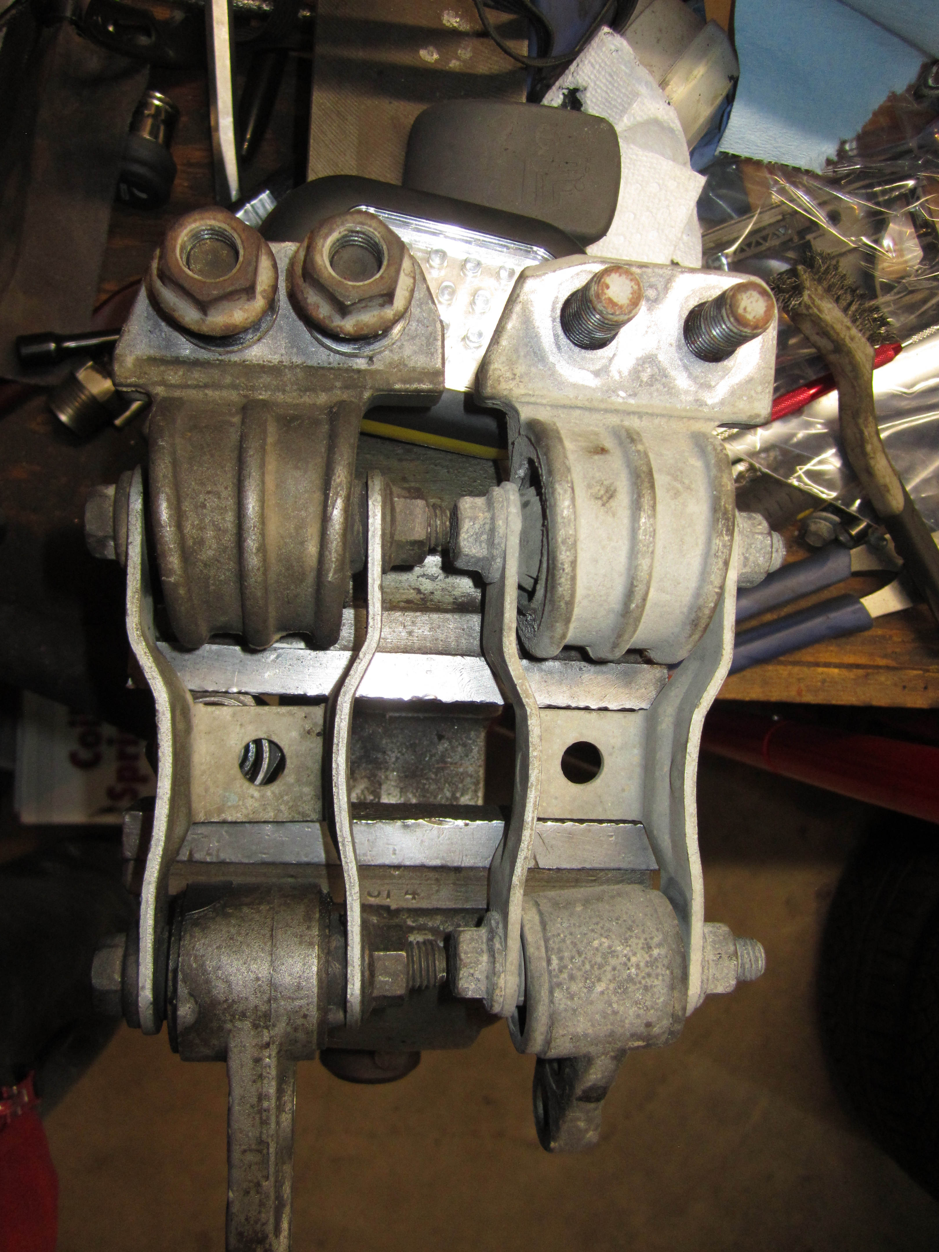

Upper mount in picture is the FWD version. Only differences seen from this view is the shape of the front mounting section where the 2 studs are mounted. Not really sure if this would really make a difference. When viewed from the front they appear to be offset the same, so can't suggest why the difference in shapes unless there is something on the rear of the front cross member that determines the shape. In this case I think the forward portion would work on an AWD. The center portion between the bots is also the same. The front portions do have different Volvo part numbers which differentiates them.
Again FWD version is to the top of the picture. You can see the difference in the 2 bolt holes on the rear sections.

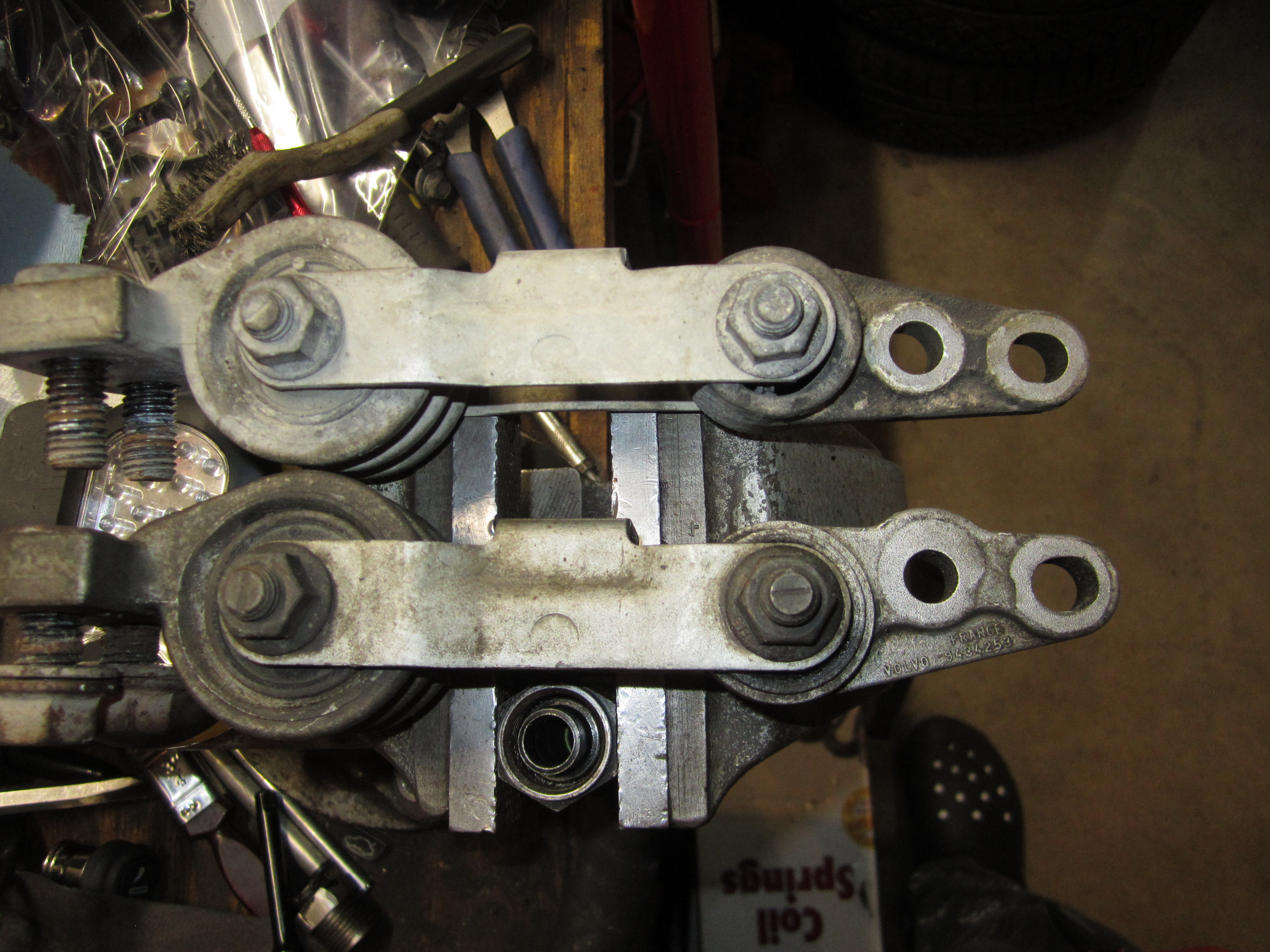

Close up of the differences in the rear portions

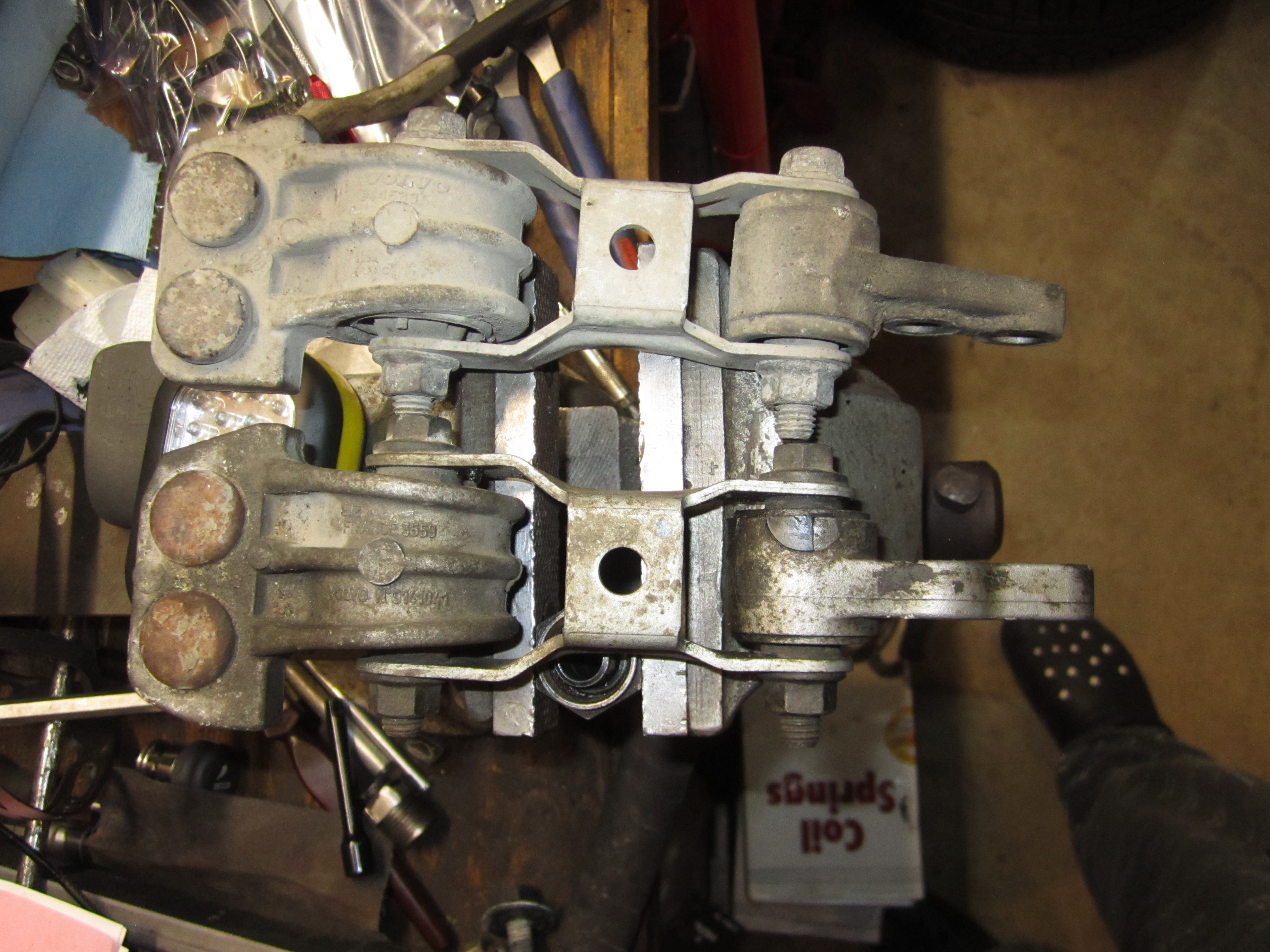

Viewed from above the mounts. RH one is only sagging as the rear mount has torn on the FWD version.
I cannot see and dimension differences between the 2 units or their respected bushes. There may be differences in the rubber stiffness but this I can't determine.

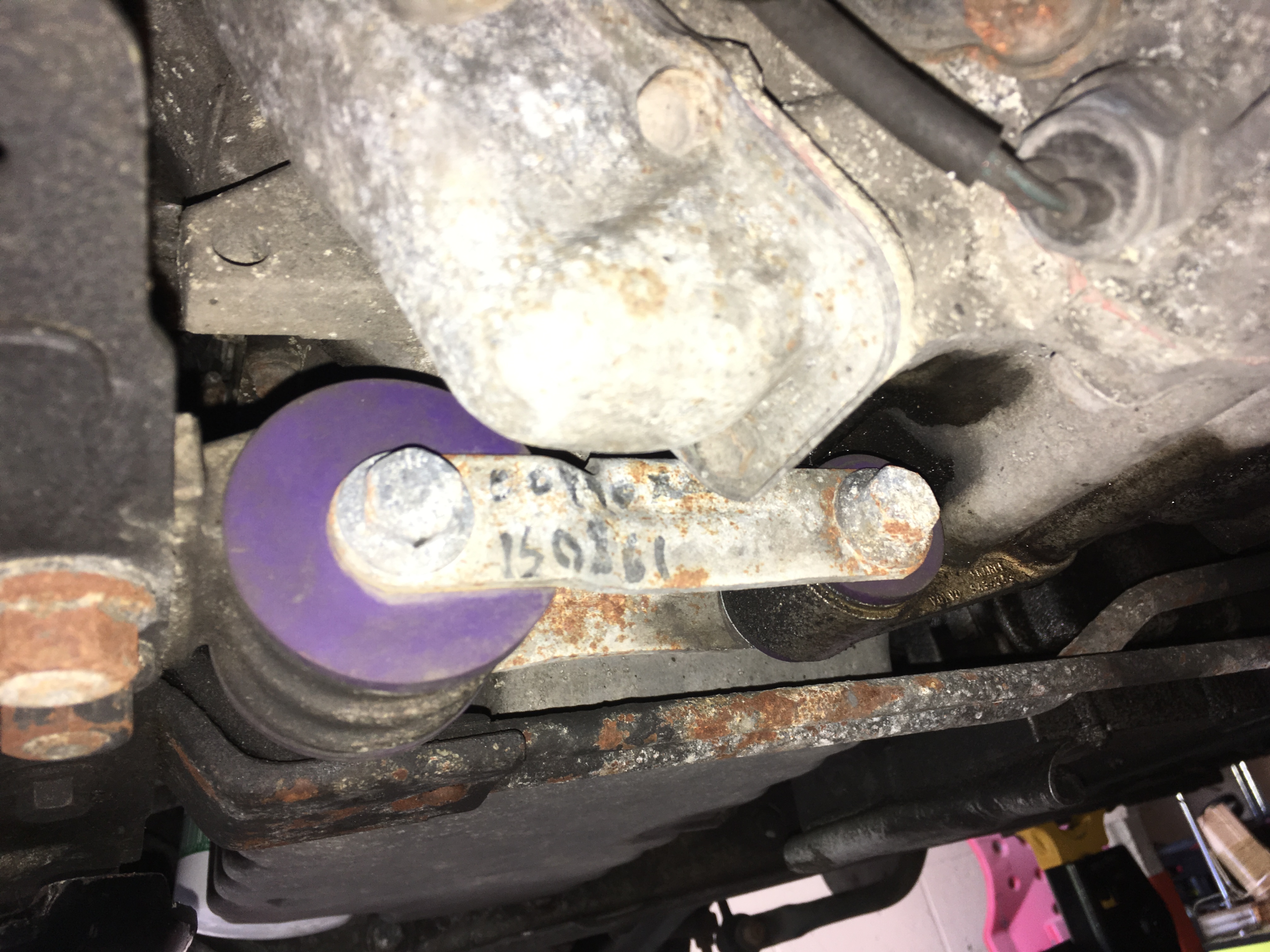

Thank you for taking the time to follow up on this. Can you find some time please to post a link to what/where you bought these parts (I know Powerflex but part numbers are always the best!!).

BigRed good to see you are still out there! How do you find the shift changes with the Powerflex bushes? Are they a bit rougher and do you get more vibrations through the steering? Thanks for the part numbers, I have a few lower torque rods that need new bushes to keep as spares or pass on!
