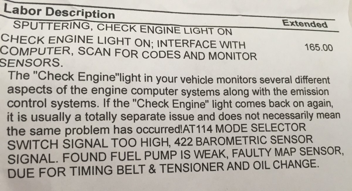

I recently bought a 98 V70 T5 with 201K. It wasn't running when I got it and the seller told me that it needed a fuel pump and gave me the diagnose report from the mechanic. I replaced the fuel pump with a new after market cheap fuel pump for 33 bucks and also replaced the MAP sensor with a used one. Now the car starts but dies in 1-2 seconds. I am thinking that maybe the MAF sensor is bad because I had a similar issue with my 2000 S70 and I fixed it by replacing the MAF sensor. I am attaching the report from the mechanic, do you think replacing the MAF sensor would be a good shot? Any other ideas? Thanks in advance.
I forgot to add, I scanned the car with my OBD II scanner after replacing the fuel pump and during the replacement I had the battery disconnected and charged so I am thinking that disconnecting the battery may have reset the codes because I am not getting any codes now.
