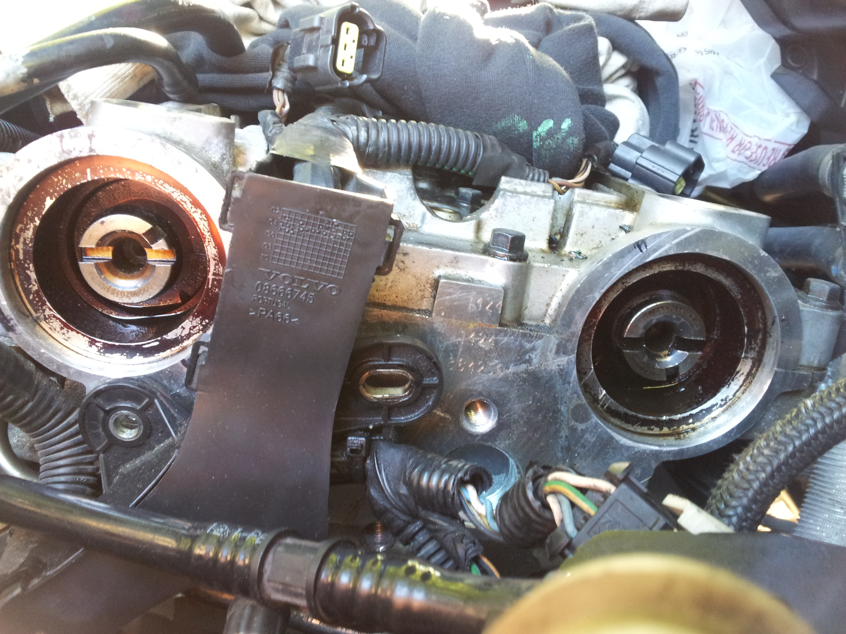

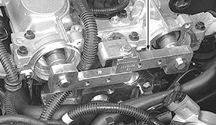

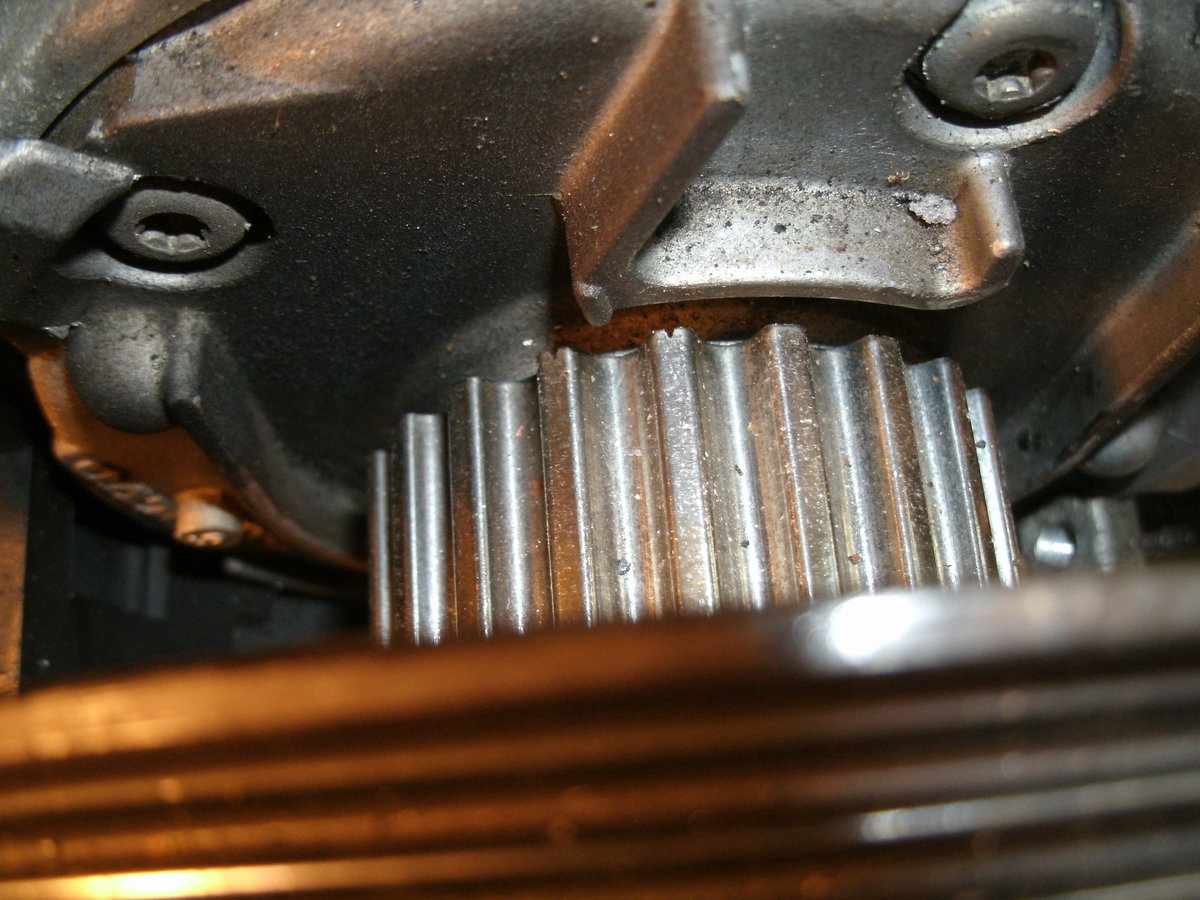

First look at the opposite end of the cams (the drivers side in US) after removing the rubber coated plug on the intake, and on the exhaust- removing the cam position sensor cover and the cup inside, and notice both cams have a machined slot cut across the end of the cam, offset from center, one offset above the middle of the cam center, the other below, (because it is a 4 cycle engine). These slots should be aligned or following the horizontal seam in the camshaft cover. You should lock each cam in position with a special tool so you keep the cams in proper timing, and back at the front of the engine (passenger side) look down at the crank timing-belt cog and you'll see the timing marks (2 grooves stamped into the top of 2 adjacent teeth on the inboard corner or edge of the teeth that needs to be aligned so they straddle the mark on the crankcase. Those 3 alignment actions- locking the intake cam, locking the exhaust cam and aligning the crank to TDC mark, make for a successfully timed engine. Theres a couple steps to take care of when installing the tensioner and belt, rotating the engine a couple turns to be sure no slack existed between gears/cogs to throw off timing, this is when you want to have your new timing marks on the cam gear already re-established, and the intake cam gear bolts set at mid slot.
Further there is a tool in my ebay-purchased volvo timing tool kit but I dont use it, a stubby bolt of sorts, that you push through a port in the crankcase at the left / driver (US) side- that fits into a notch in the flywheel locking the crank at TDC. Its a pain to get to, requires removing starter, etc. so BEFORE I remove the timing belt- I just make sure the crank and cams are turned to the exact position so that the cam locking tool fits right into place, and if you dont mess with the crank- (unlike the cams the crank doesnt tend to turn on its own) then everything will remain in factory timed position, with marks on the crank timing belt cog and crankcase lining up.
