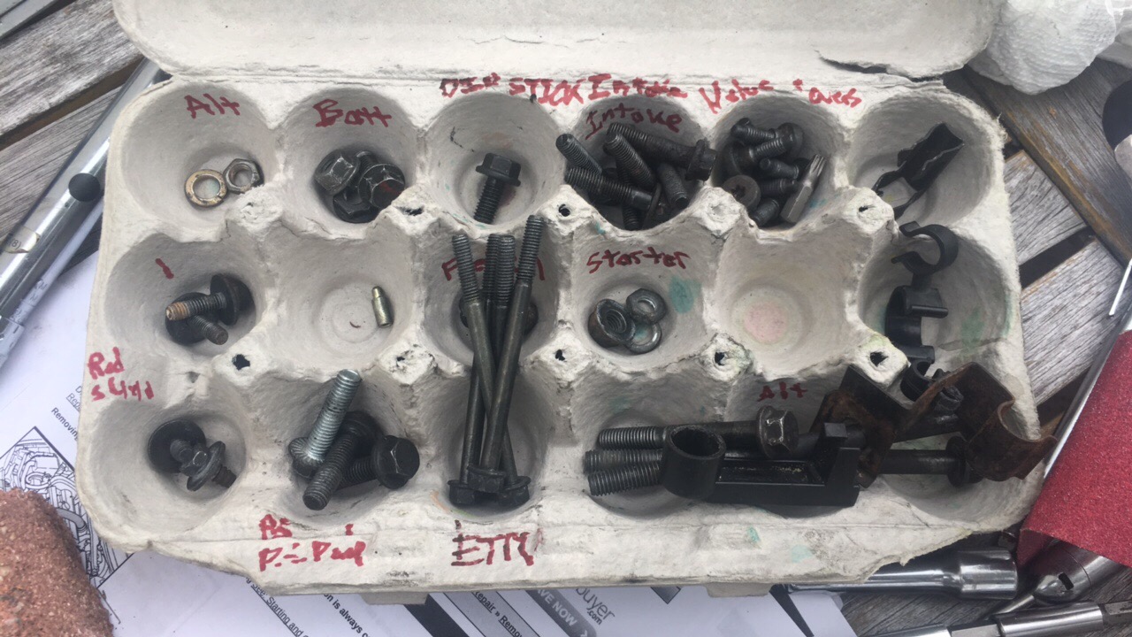

3. I used this organization method for all screws and nuts that I removed in the process of the job. Made things a LOT easier. I kept it on a work table a little bit away from the car so that it wouldn't get upended. Yes, I know my handwriting is bad. Incidentally, as I put bolts back in, I gave each of them a good brushing with a wire brush to remove any debris from the threads.
Screw Organization.JPG (272.17 KiB) Viewed 6072 times

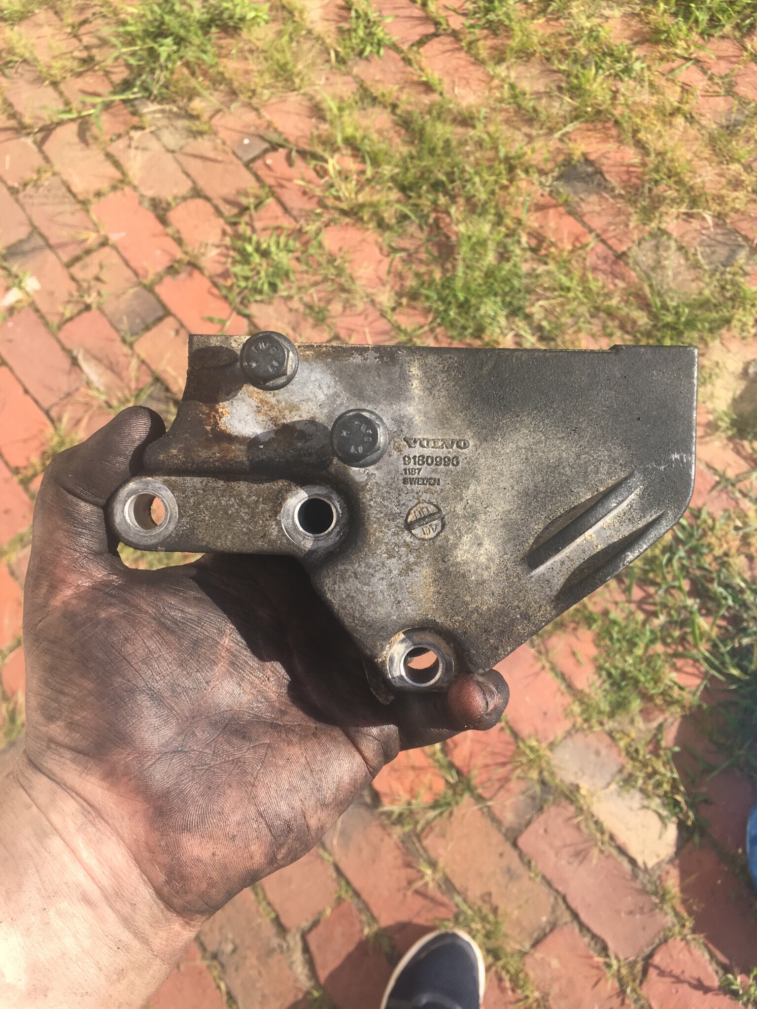

8. The banjo bolt on the other end of the crankcase hose, back by the turbo, seemed like it was going to be tricky, and I spent a while figuring out ways to get at it. Then I realized that it was actually just covered by a removable plate held on with some pretty huge bolts. Once I took the plate off, it was pretty easy to get at that bolt. Based on my observations, the purposes of the plate appear to be: a) To serve as a mounting interface between the engine block and a bracket that consists of an engine lift eyelet and a guide channel for the turbo hoses, and b) To serve as a mounting interface between two of the engine mount bolts and the engine block. I have since replaced it and torqued it down pretty hard, which I felt comfortable doing considering the beefiness of the bolts and the fact that it needs to support the engine mount.
Here it is:
engine mount plate.JPG (886.27 KiB) Viewed 6072 times
The banjo bolt was tucked right behind that area on the right of the plate where there are no screws.

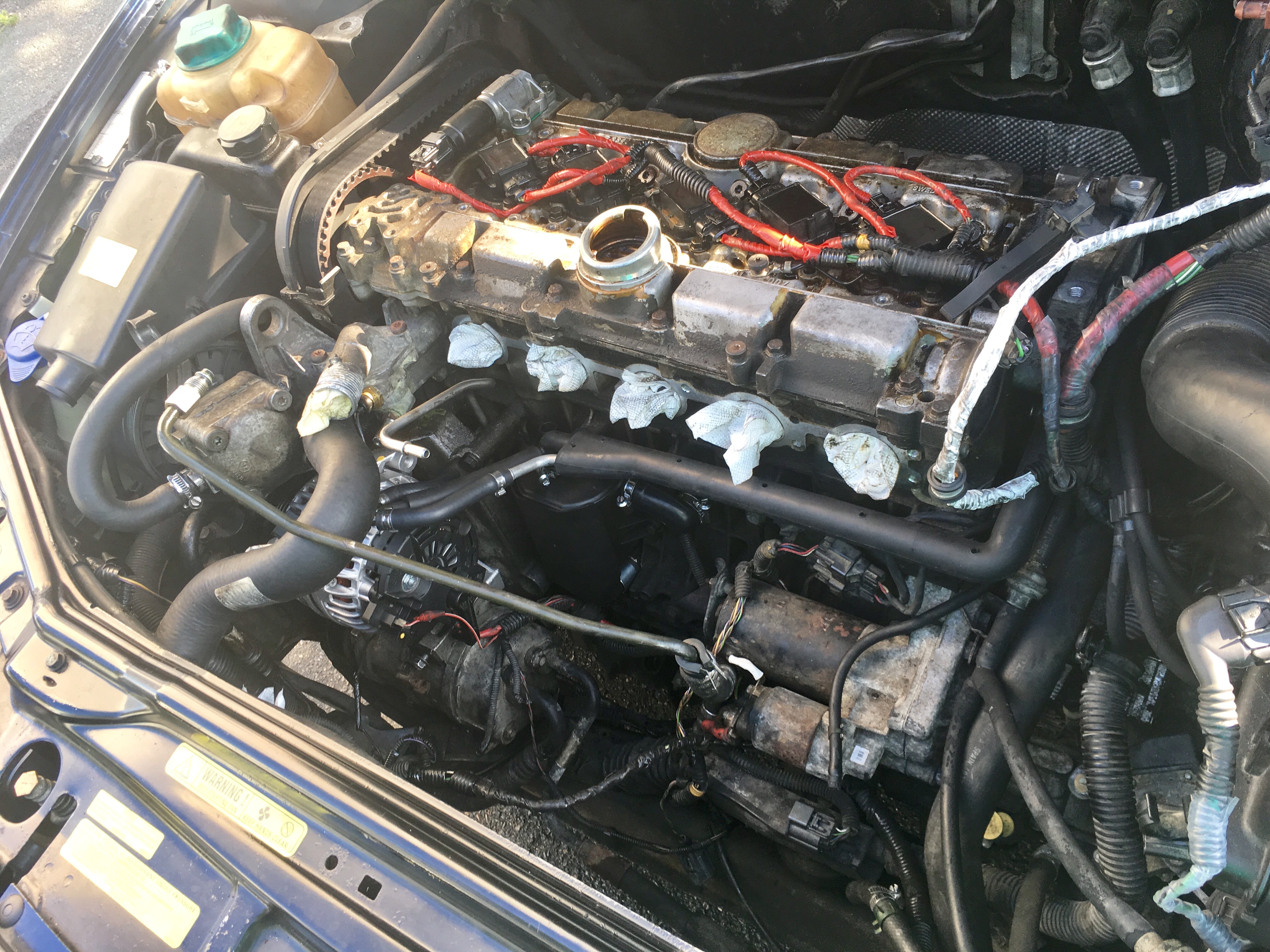

12. Here's the current state of my engine bay:
PCV system is all in place and hooked up except for connections to the intake, etc. I'm taking a break for tonight, and tomorrow night I hope to finish up by reinstalling and connecting the manifold, throttle, and injectors, and then all the other plastic pipes and components I had removed. I haven't decided whether to try starting the engine with the cracked ignition coil, or hold off until the one I ordered from eBay arrives on Friday.
