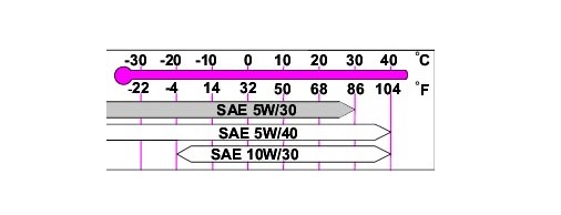

In my part of the USA it can be over 90 F (33 C) after midnight.
Volvo does not suggest 5w30 for our climate for my year.
Also note many car manufacturers spec oil for best MPG when a slightly heavier oil might be better for engine protection
- v70_oil.jpg (20.22 KiB) Viewed 3387 times

The above pictogram is very common. It seems to indicate that 5W-30 oil is not good enough above 86F. However, the oil is actually heated inside the engine by the engine heat way past 86F. More close to 210F or so. So the outside temperature doesn't have that much impact on the actual engine temperature. I'm going to dare and say I'm not sure what the chart is actually about. I get the idea about cold oil grade chart - the first number in the oil grade (0W, 5W, 10W and so on), that makes sense to me, but not sure how the hot oil grade is being related to ambient temperature given the engine is cooled down already quite precisely with the coolant and radiator fan.
