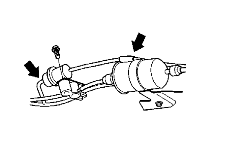

Ah, on the bastards...
It does not have an FPR like the -1998, but it returns fuel right after the fuel filter on the rear passenger side of the car.
Alldata reports you remove the tank to service it , if needed
