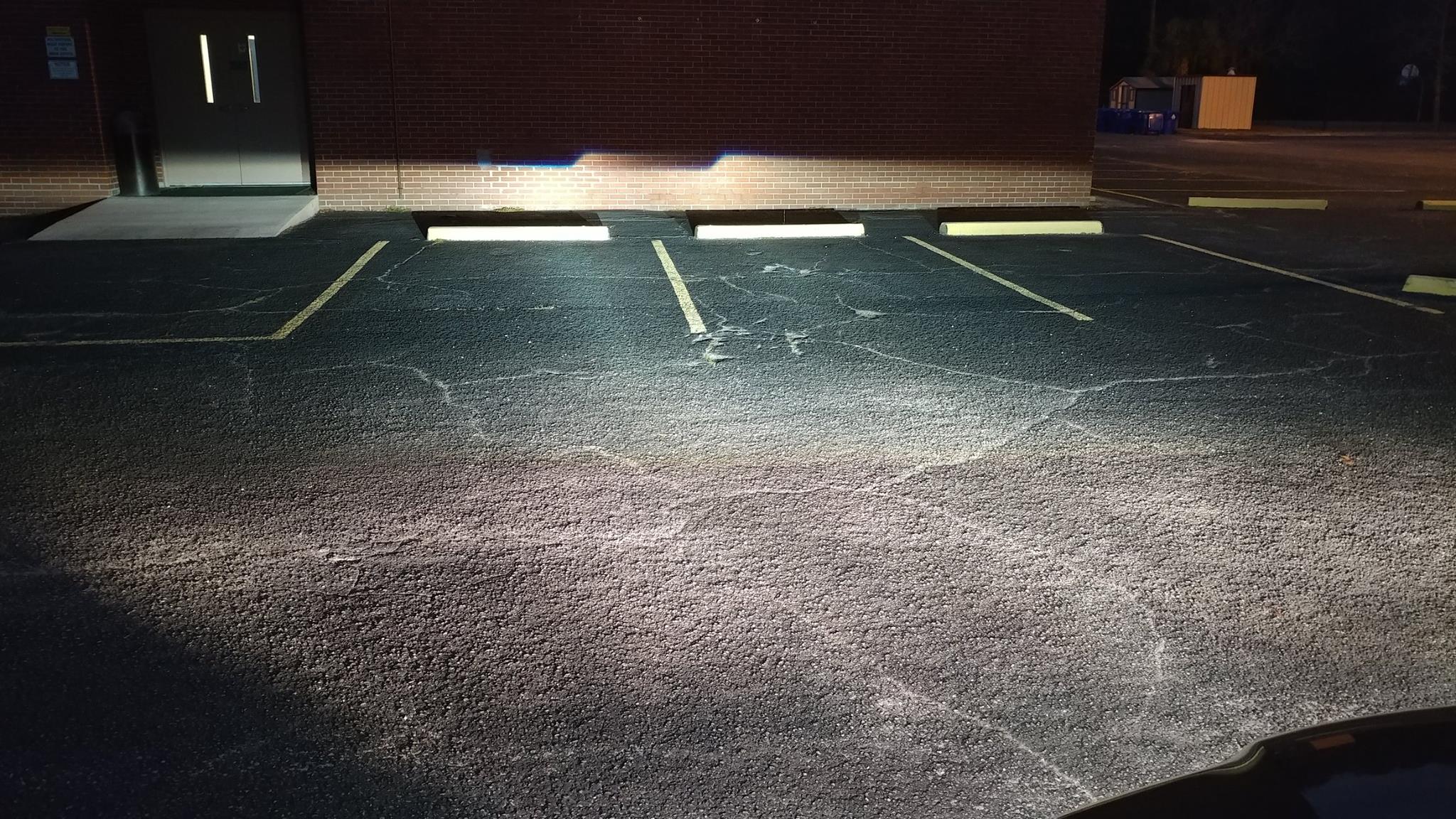

Recently I ordered a set of 4 H7 55W halogens. A quick test drive afterwards revealed something was off. Not quite what I was expecting. This evening I pulled both HDLT assemblies and removed the lenses for a reflector inspection.

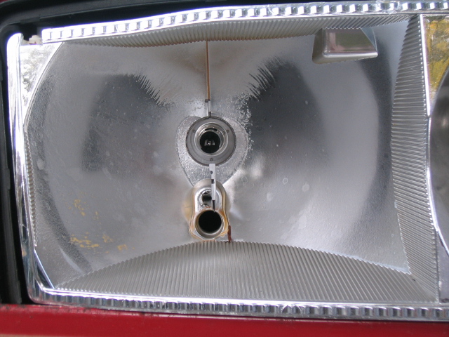

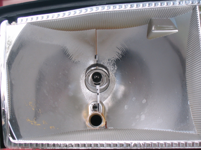

Not good:
I have "speckled" aluminum rather than "shiny". Rough to say the least. Still, the sled just passed her 20yr mark out of the factory and the old girl has done well. Mileage is around 222,201 mi.
I have one OEM Volvo lens and one generic replacement. Originally both light assemblies had the levels and wheel/gear assemblies on top for adjustment. I lost the driver and it was replaced with one without either 'feature'.
I suspect anything in a junk yard will be as poor as mine, given the age. The 'jewels' are very nice, but $$$$ new. I've read several HDLT threads and generic 'replacements' are available. They don't use H7 bulbs though and I don't think I can get my $$ back as mine have been turned ON, though they don't even have 30min on them.
