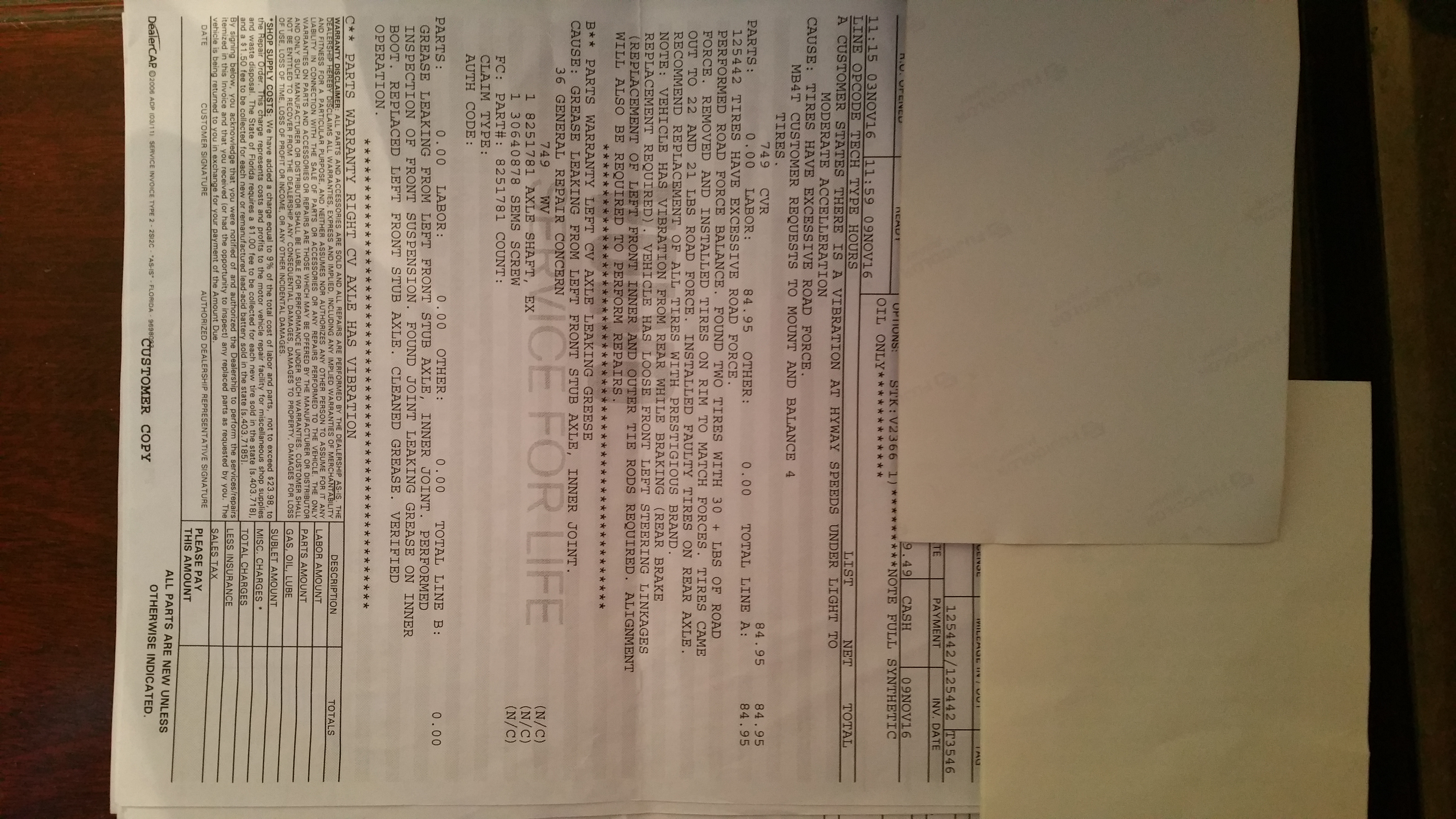

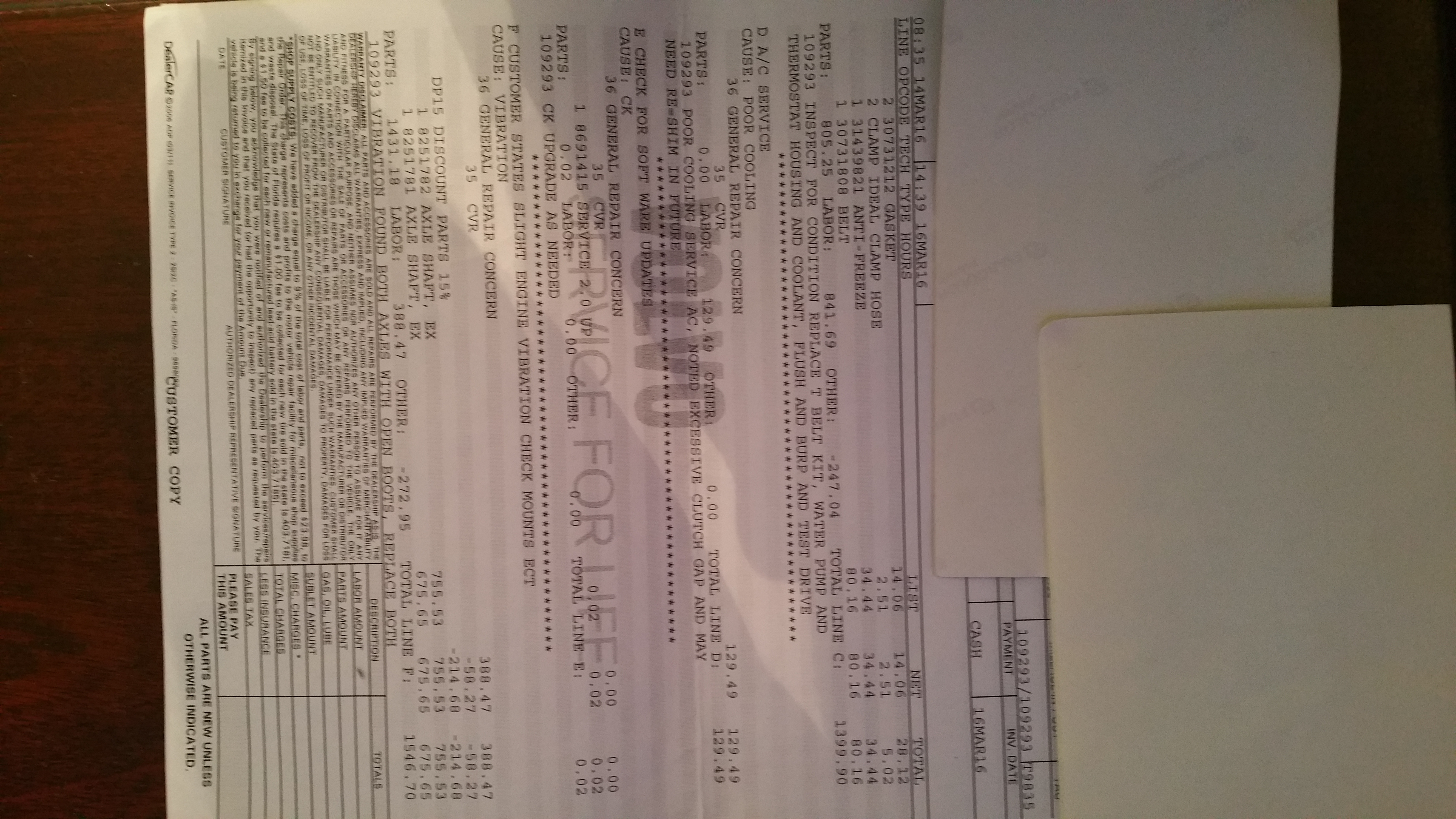

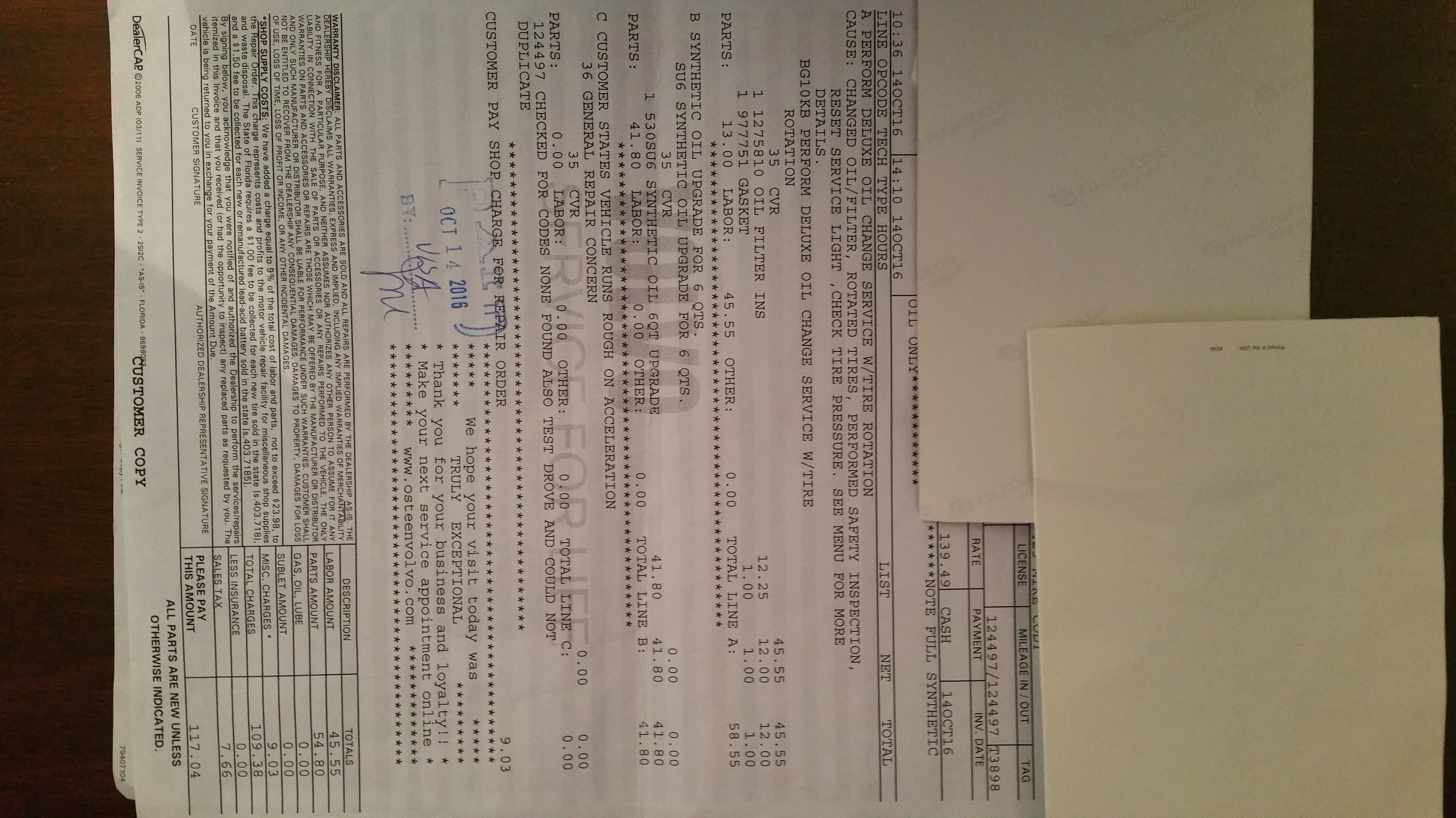

I took some photos of the original axle replacement at 109k bill and notice I thought the engine misfired but axles bad then at 124k reported misfiring no codes found, than 125k it is written on the next two tickets as torque vibration, but I still was complaining the engine was misfiring but advisor wrote it as torque vibration, also notice I specifically said only after a hour drive on highway misfiring starts. It looks like they felt it was from the inner joints and on one of the tickets a engine mount was replaced which I wondered how that could cause a misfire, but I figured Volvo knew best. Then the ticket the axles were warranty replaced. I was convinced something was getting hot like in the old days when cars had sparkplug wires and one went bad it would miss when hot under load but be fine cold. It really shocked me that axles could cause no vibration then after extended highway driving suddenly start causing the car to buck like a misfire. I am quite sure my mechanic hates my car and probably me for bringing it in. I left the dates and mileage uncovered but did cover my personal information I hope that does not offended anyone, these are the tickets fore my 2004 S80 T6. Juneartistjohn wrote: 05 Sep 2017, 07:17 Thanks. Never would have thought this was related to an axle. Have replaced both in last year, but could have gotten a bad one I suppose. Frustrating.

Withholding your personal information from unknown multitudes of psychotic Volvo owners on the internet? How could that possible go wrong??
Thanks for sharing that info.
