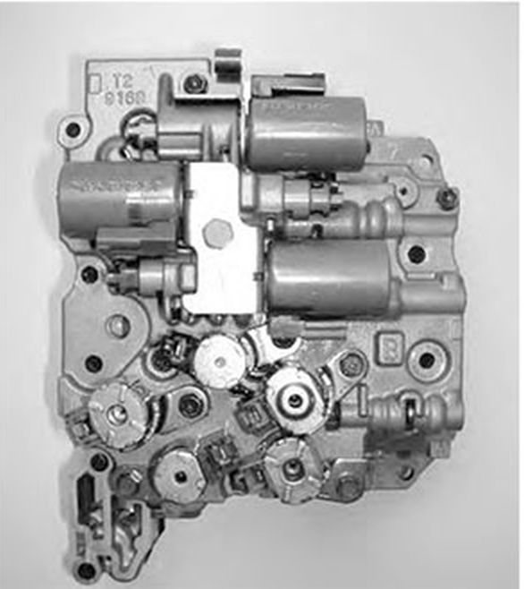

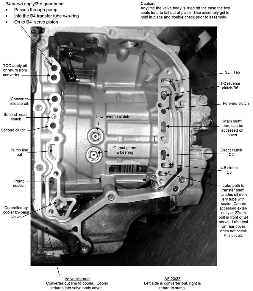

Solidar wrote: 13 Sep 2017, 16:25 Any idea where this port might be located, and if its able to be cleaned out, or if it has a replaceable part? The fluid I drained the first time was pretty dirty, so I may be able to assume that the port is clogged/gunked up with crap.
The port in the valve body is at the lower left of the block (when installed in the car and facing the engine bay)
It's in the bottom left corner of the valve body
Valve Body
Valve Body
Valve Body.jpg (56.27 KiB) Viewed 2250 times
Here's where that port interfaces with the transmission
Trans interface
Trans interface
Trans interface.jpg (189.76 KiB) Viewed 2254 times
