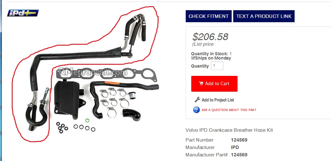

- If you suspect high crank-case pressure, you can gently lift the oil dipstick a bit so excessive pressure can escape.
- The car is bone-dry now, maybe you lost so much oil now that nothing comes out? Did you check the dipstick?
- The PCV overhaul can be complex: besides replacing the parts you mentioned above, one has to check the return port to the sump.
Also the vent that goes from the oil trap to intake is not included in the kit you mentioned (see photo below).
- Anyway, you need a Volvo specialist.
