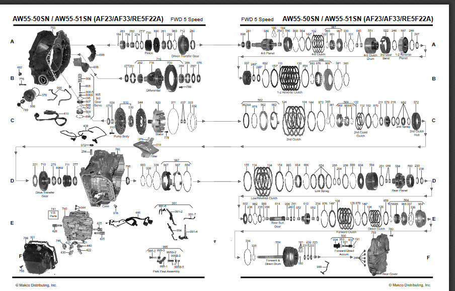

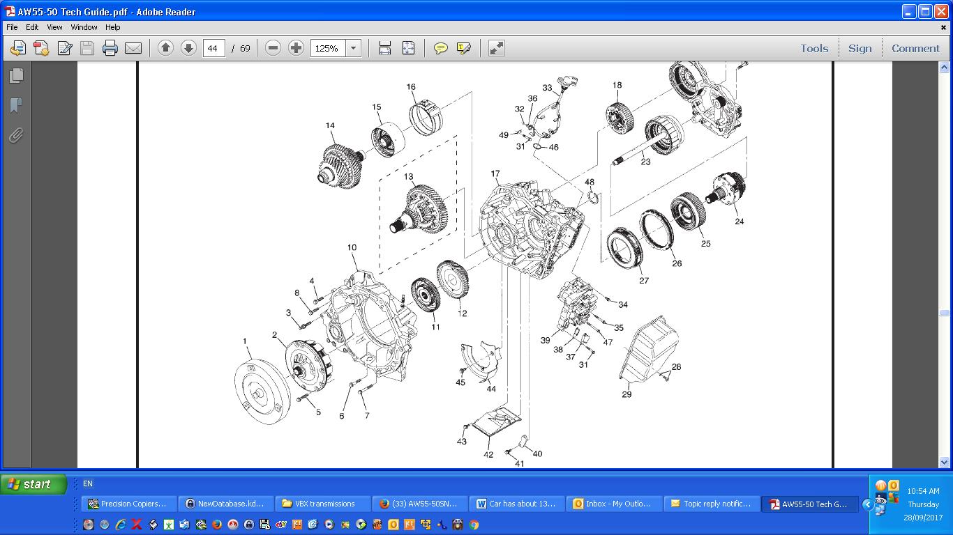

I tried using the exploded diagram to try to establish it's location within the housing but this is as good as it gets. It's item 42
I know that once the case is split the filter comes right out. Item 10 split from item 17
Also I recall seeing it once the C1/C2 gear set was removed when I had one on the bench
If we can snake one of those flexible magnetic dropped bolt recovery tools into the filter it might even be possible

Here is more detail
55-50 Pic.jpg (173.61 KiB) Viewed 16202 times
