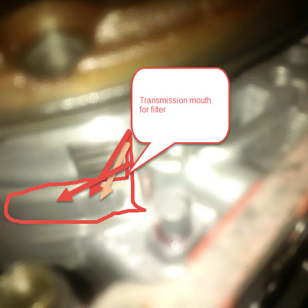

cuhfs
Posts: 645
Joined: 31 August 2011
Year and Model: 850,XC70,XC90,S60,80
Location: New Jersey
Has thanked: 17 times
Been thanked: 28 times
Post by cuhfs »

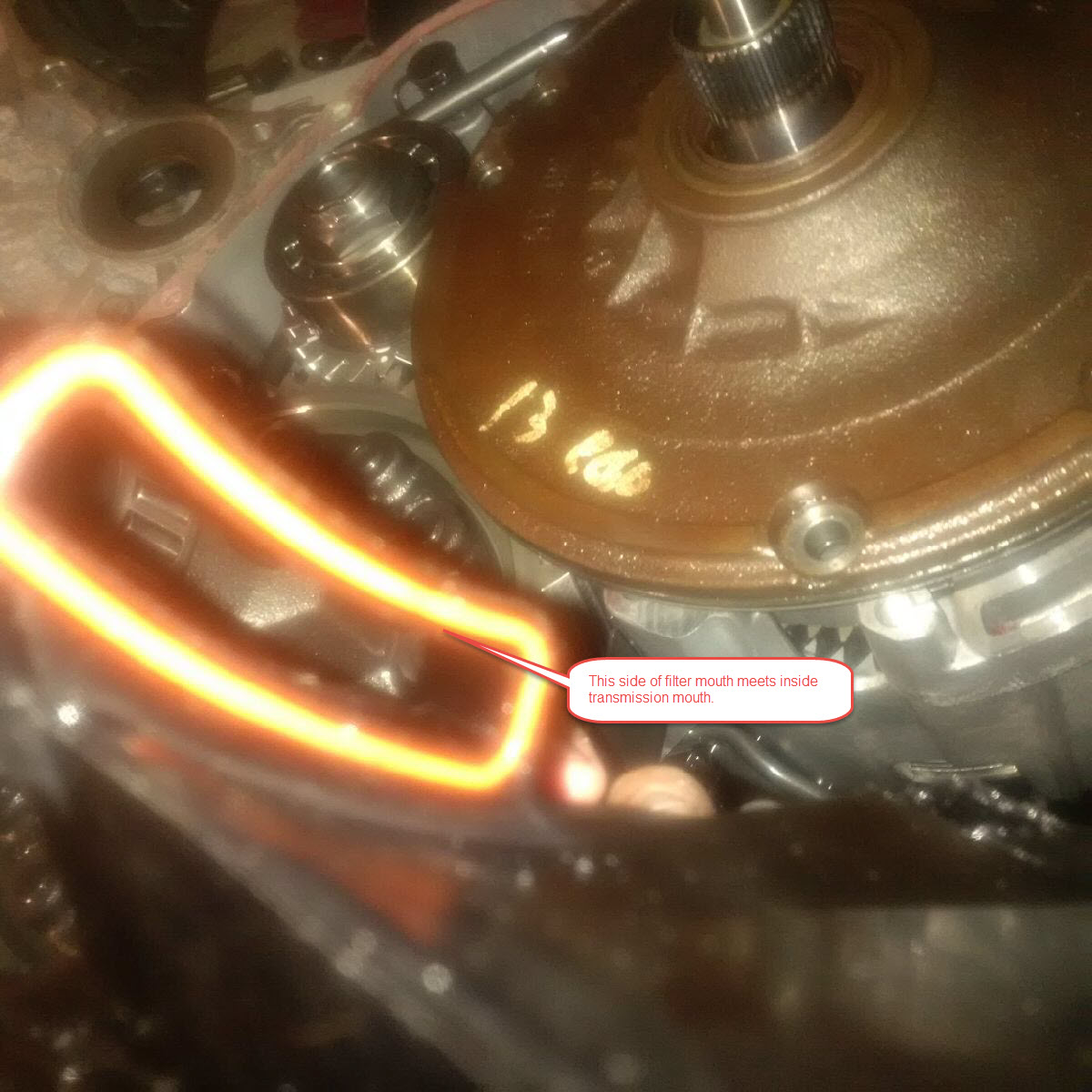

Hard to explain,..Trying to show you... it all does not flow into the filter. The intake is not shown just the neck / mouth where it meets inside the transmission. Its open on both sides so it appears to me that some fluid is not filtered. The fluid can come into the filter from the bottom intake or from the backside of the mouth.
Trans Mouth.jpg (172.57 KiB) Viewed 6061 times
Inside mouth.jpg (46.09 KiB) Viewed 6061 times

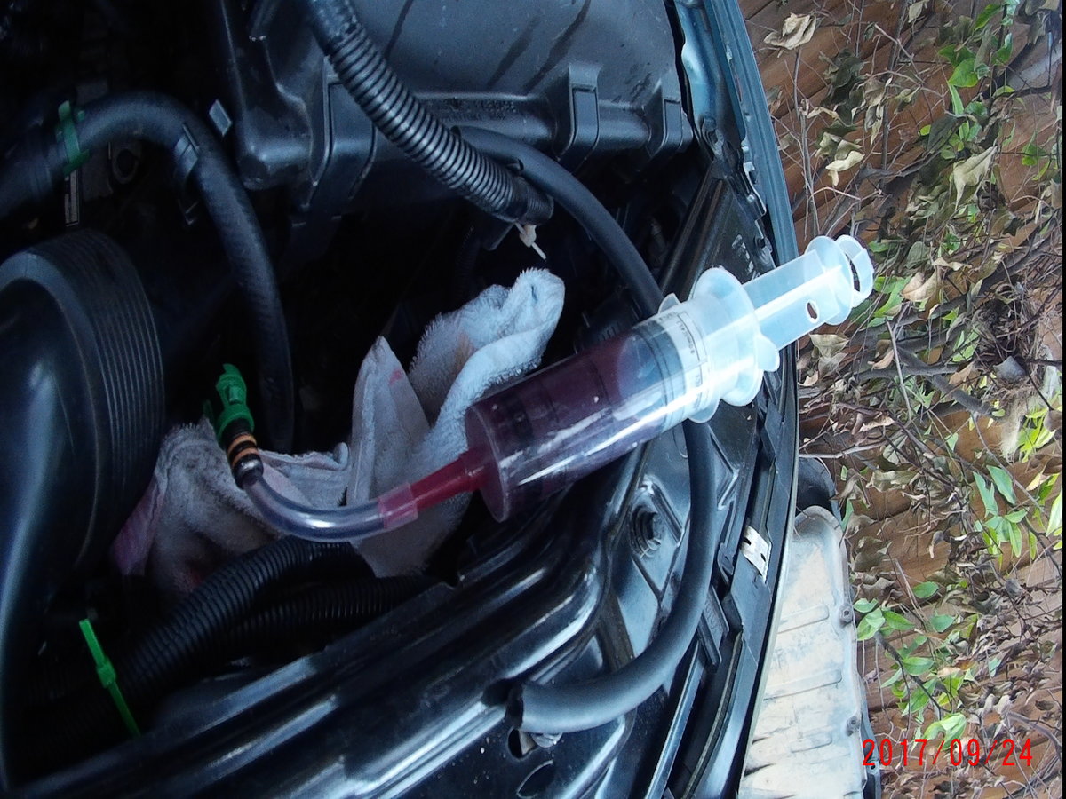

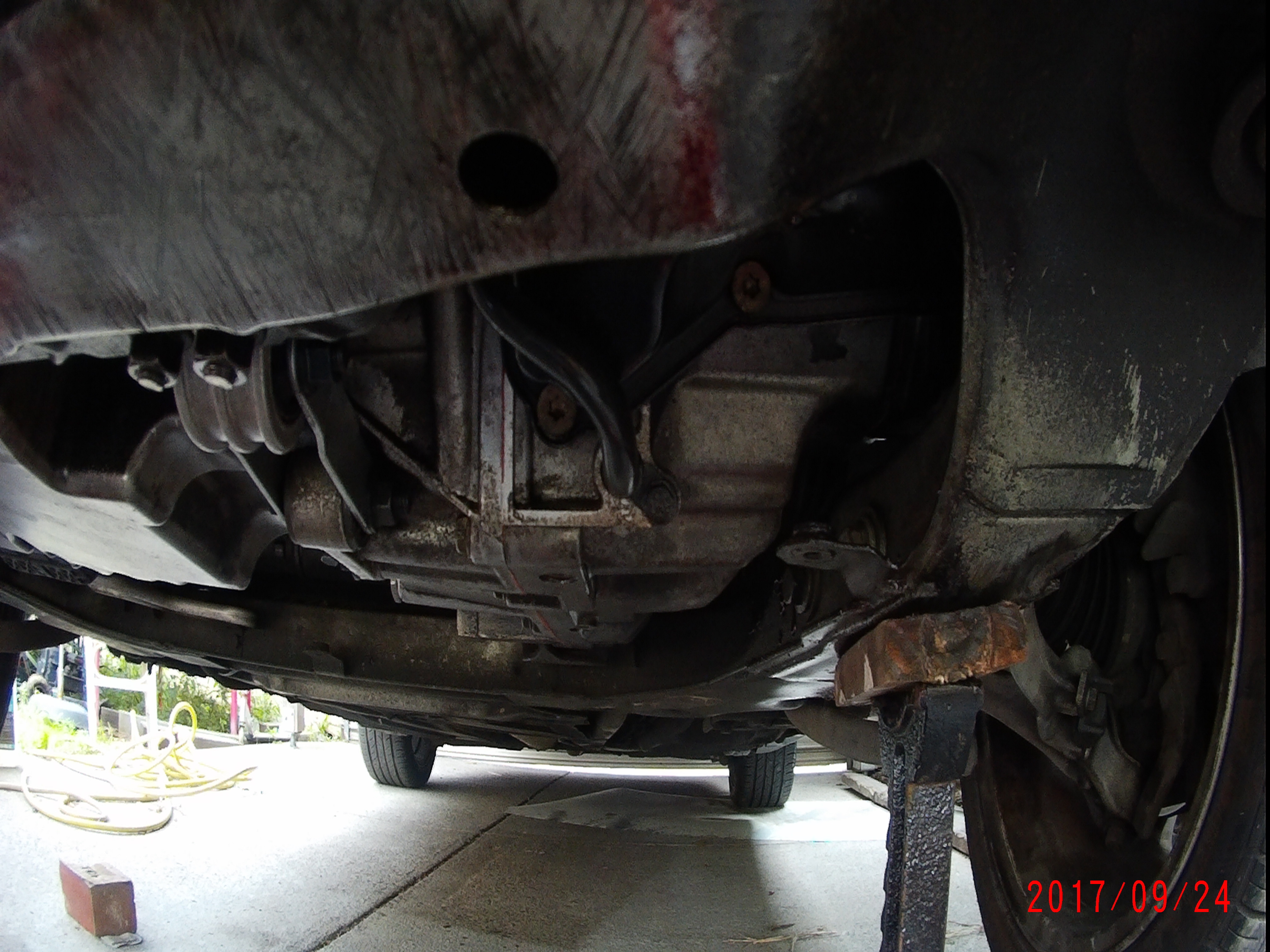

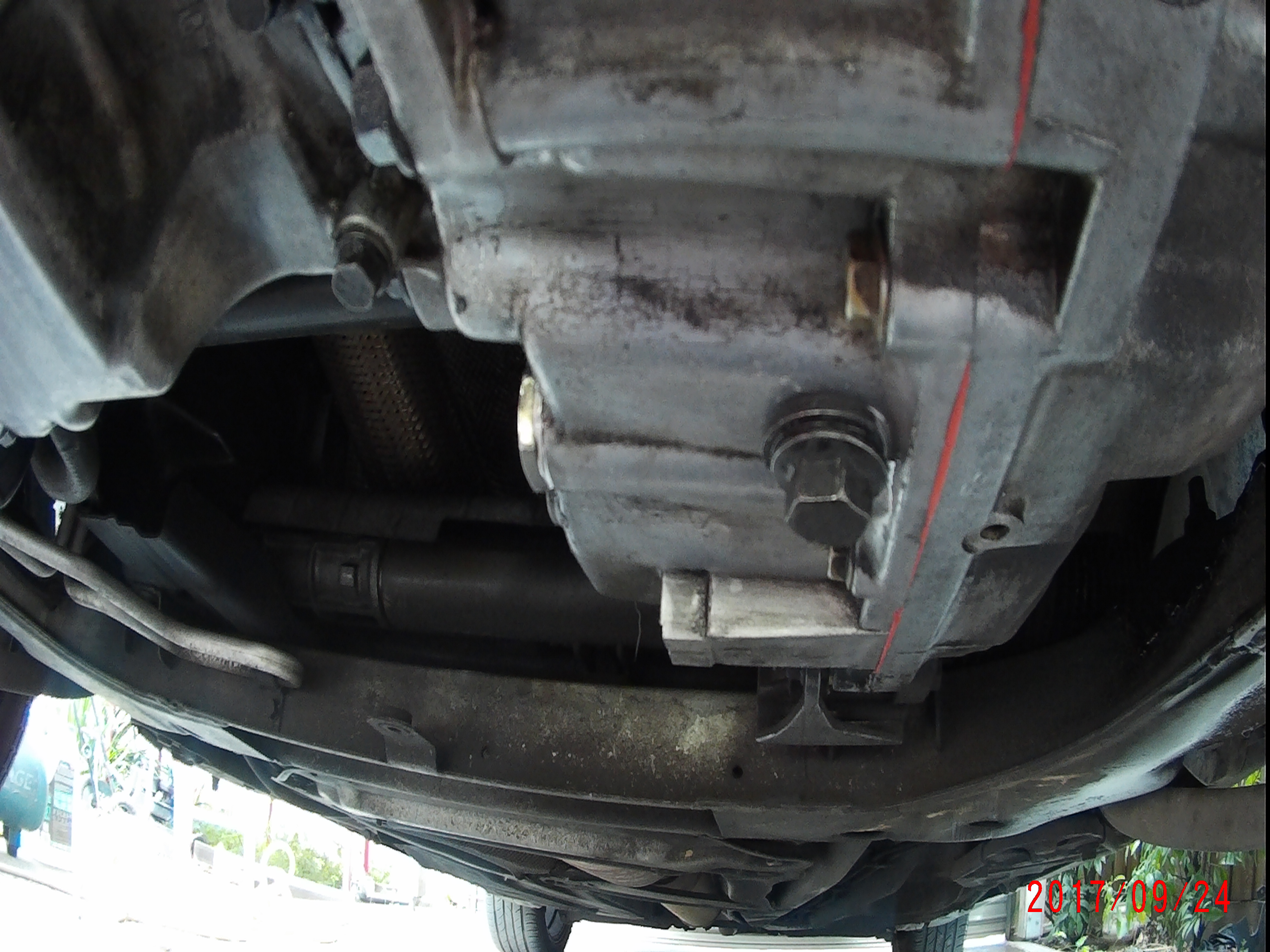

OK job is done. Hole was drilled in bell housing. I used a syringe with 80ml fluid twice to backflush any large pieces back into my 8mm hole then drain out.
First I went to 8mm hole then poked my skewer through then felt resistance. Pushed a little harder until something gave way......I suspect this was the filter mesh as another 200ml of fluid gushed out. I continued to push upward through the intake port of the filter and skewer was going all the way into the transmission. The skewer is about 14 inches long so I'm pretty sure the filter has been pushed aside.

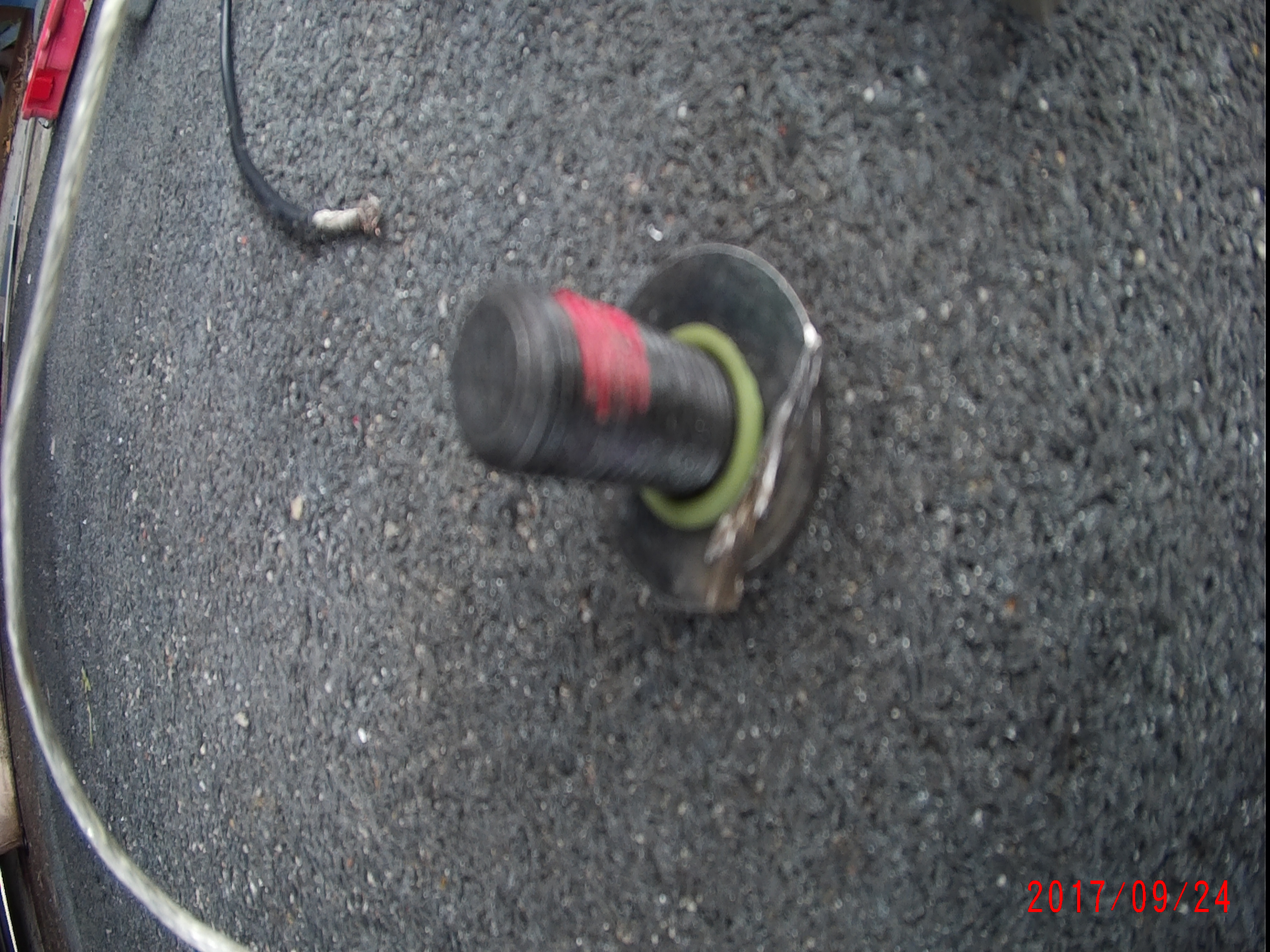

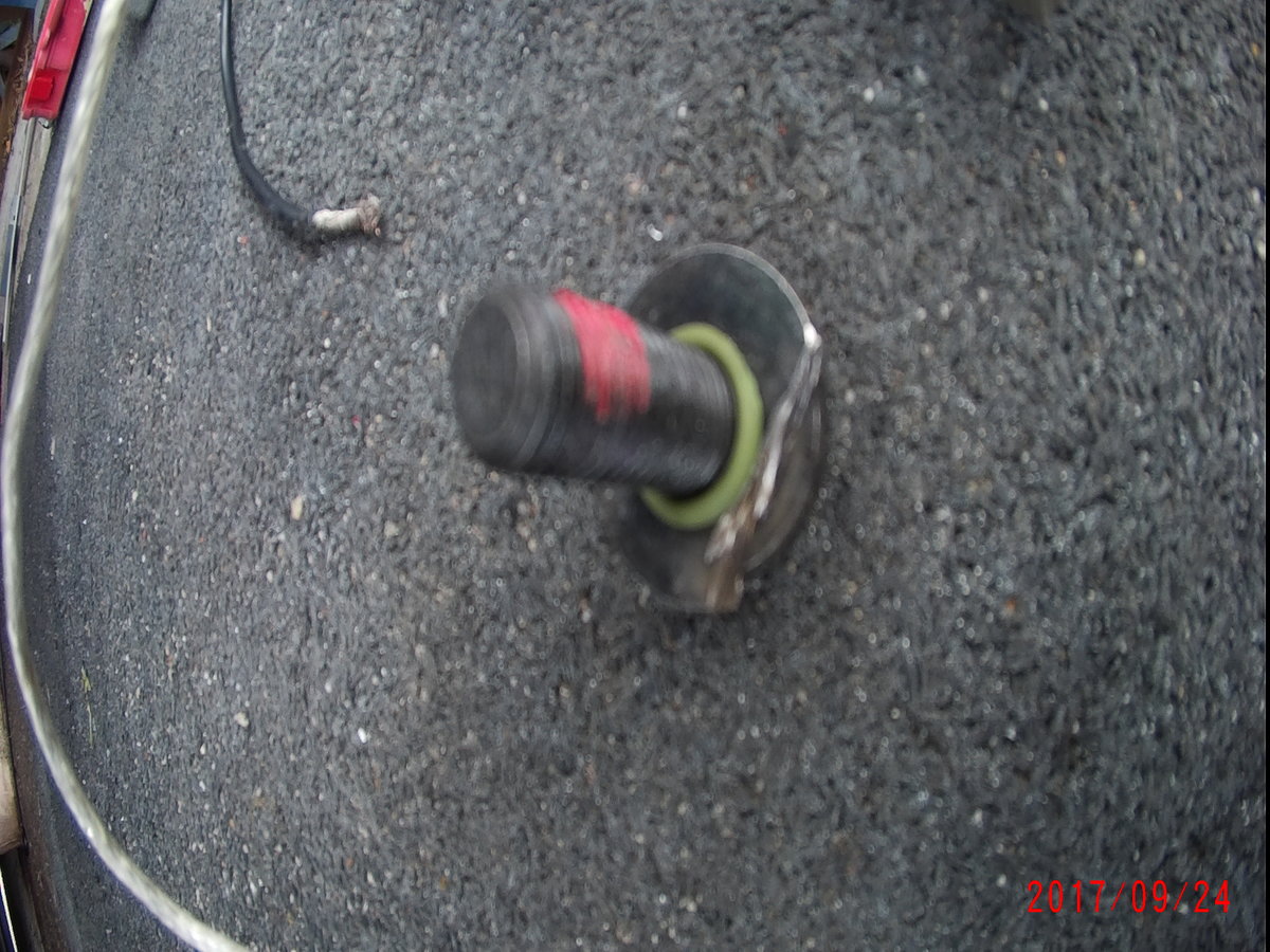

Increased the hole size to 10.4mm which was perfect for my M12 x 1.75mm tap. Again used syringe to get any more pieces created by the tap but most of the pieces were running down the tap through the four ridges on the tap.
I now have M12 x 1.75mm bolt in there with a M18 crush washer capturing a rubber seal where the centre space is between bolt and crush washer.
Had to Dremel the large washer as there was a slope in the casing to overcome
Using a syringe to add small quantities of fresh fluid to wash filings back to the newly drilled hole
Fitted bolt with M18 crush washer added between O ring seal and bolt
Cooling line entry point is only about 1.5 inches above the sump
