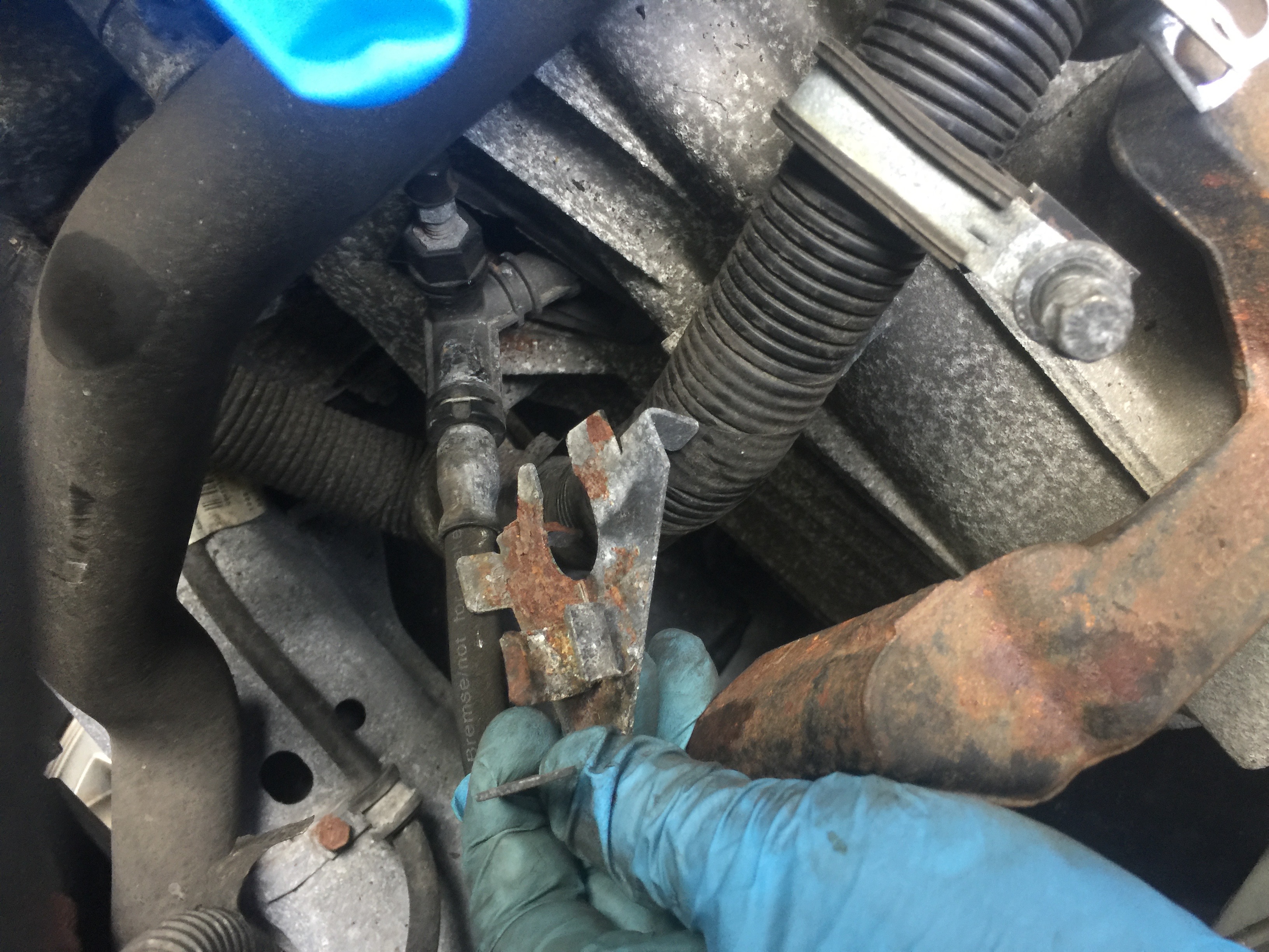

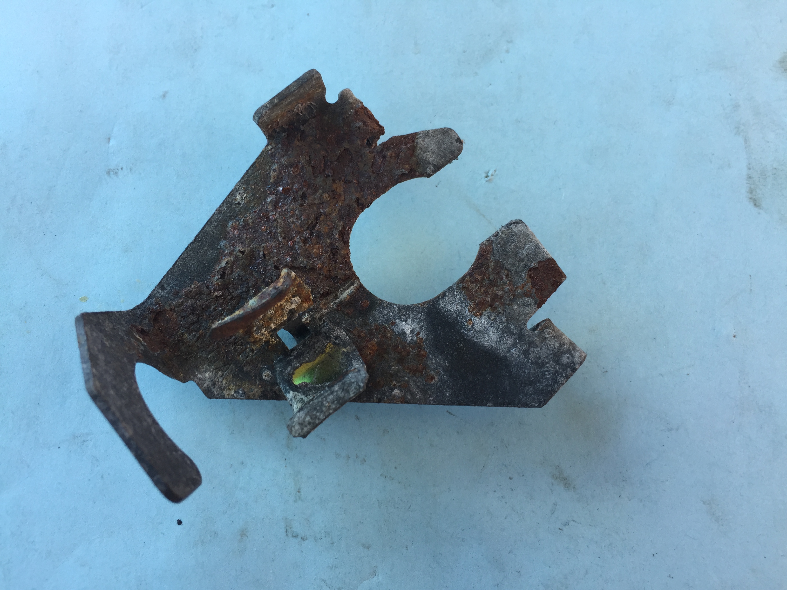

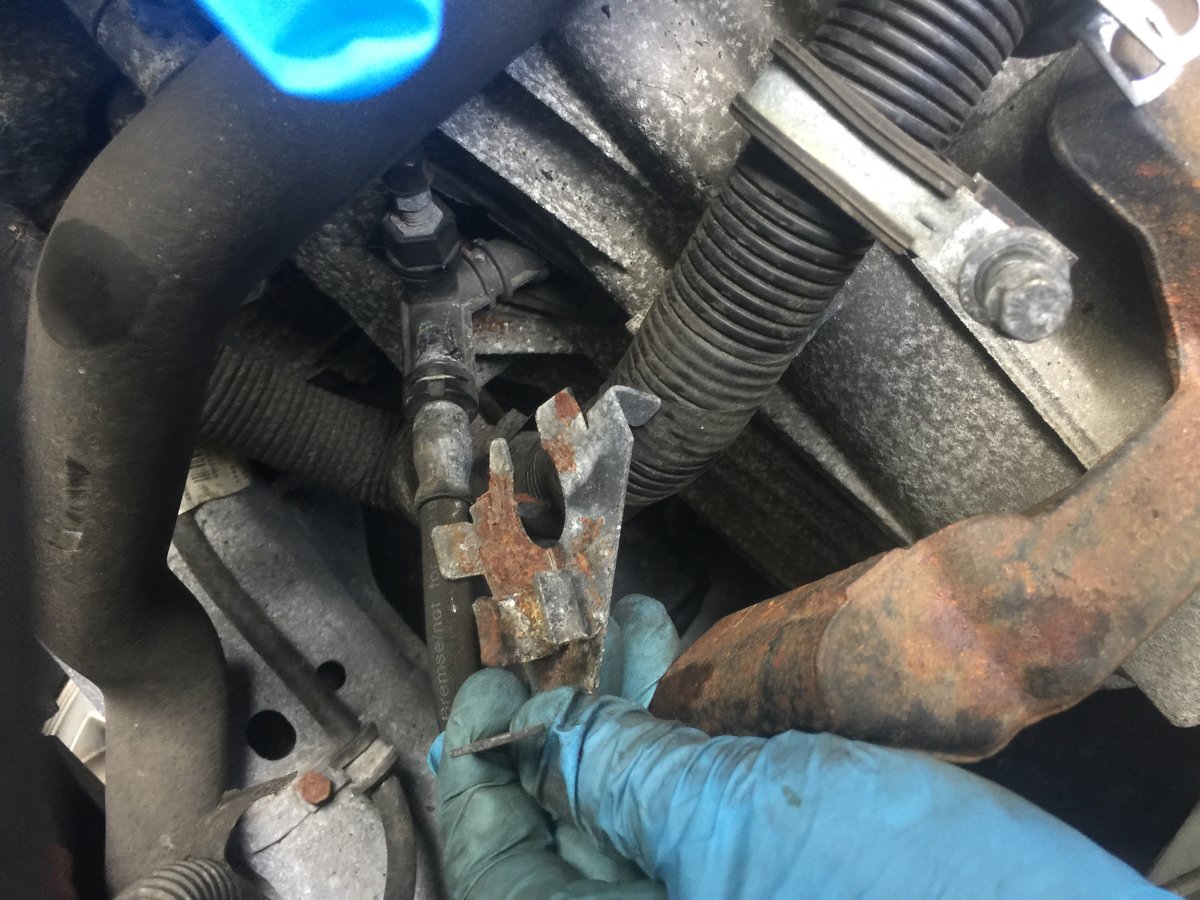

I also Have one bracket I can't Id.....anyone help?
On edit - it helps when you shoot pix as you go..

I think I have it - clutchslave cylinder mounting bracket - outside the trans case - PTL

Did you find out where those miscellaneous parts belong?
