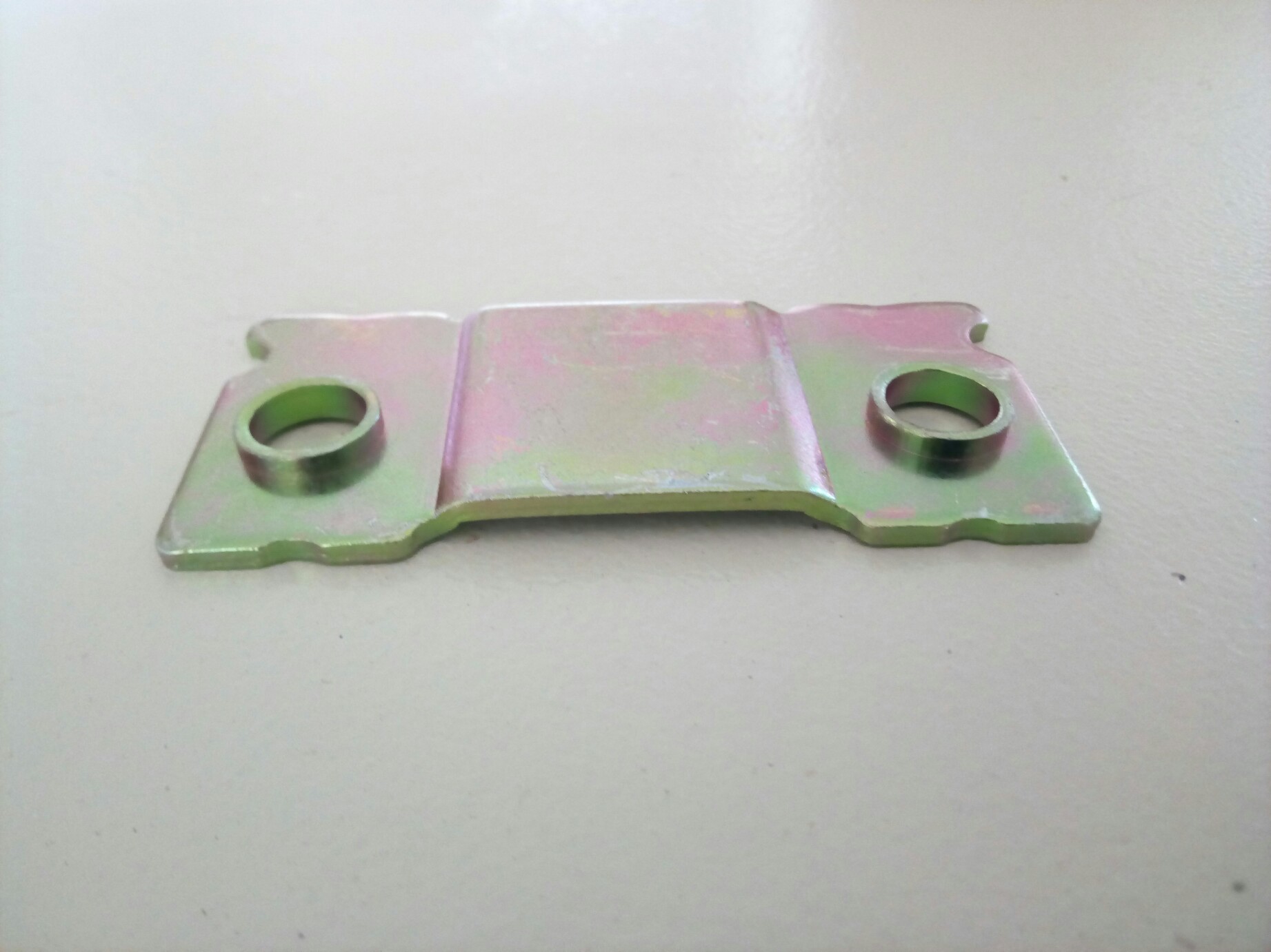

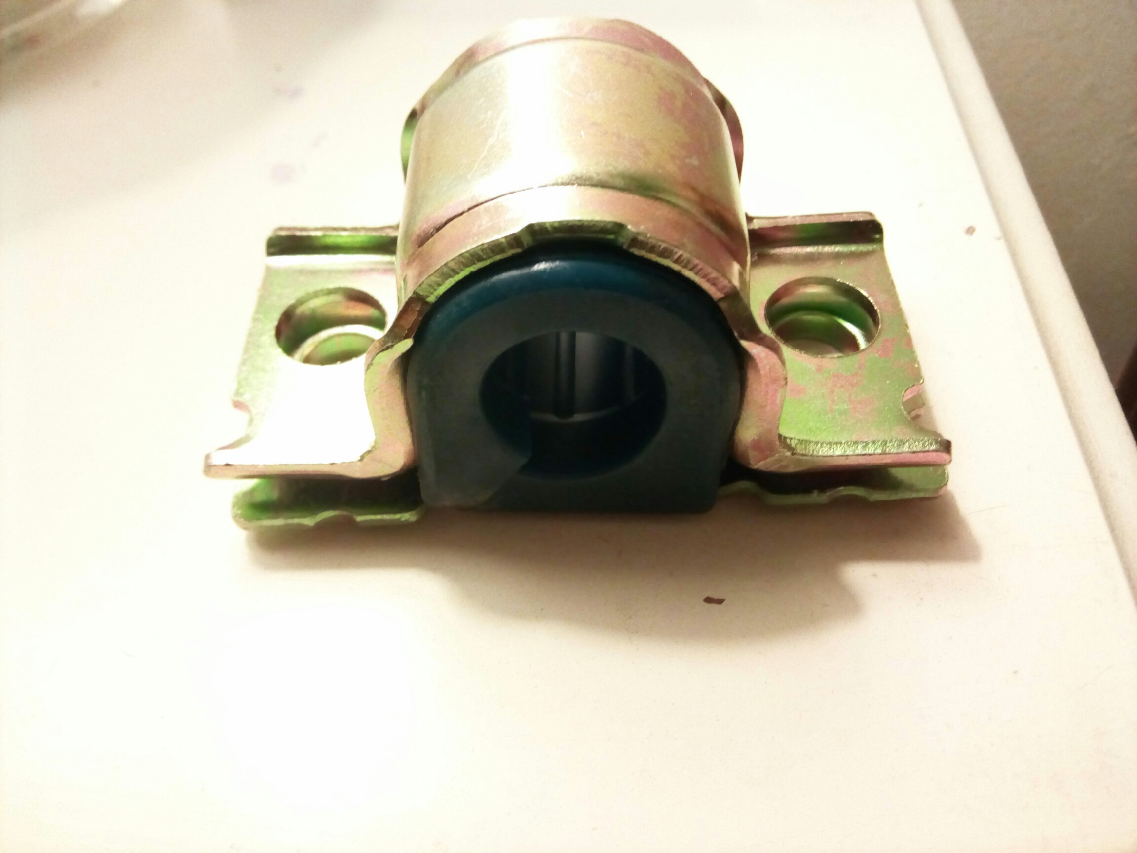

I just bought some aftermarket polyurethane ones for my 2001 T5 which look a little "squishy", however I didn't need to replace them.
I used the same ones on a 98 V70R last year; we burned them out without removing the bar then scraped them off and spray painted the bar black again. What a job!! Only reason I wanted to replace them on my T5 was I was getting a knocking/groaning from the subframe when changing direction at low speeds. I also bought the Pro Parts subframe bushing spacers from FCP Euro and fitted them as well as new sway bar links. The bolts for the subframe were not torqued well enough because they were too easy to undo. Just a word of caution for anyone chasing groaning/creaking noises; check the subframe bolt tightness. The polyurethane spacers may have tightened up the front end but in my opinion most of the noise was from under-torqued subframe bolts.

Oh and they won't slip on the crossmember due to the protruding lip on the underside of the lower plate.

Precopster, I'm not sure but it's more a matter of the bar not slipping sideways inside the bushing? The original bushings were vulcanised by volvo to the bar because there was an issue with the 850 who at the beginning had separate (non vulcanised) bushings that were causing knocking after a while. Since then, Volvo is vulcanising the bushings to the bar.

I can see how its possible for them to slip on the sway bar however the 1998 V70R I fitted these to doesn't have an issue 18 months later as I stay in touch with the guy who purchased the car from me. I will say they were difficult to align and torque due to the bottom plate but once they were tightened that bar was not going anywhere.
