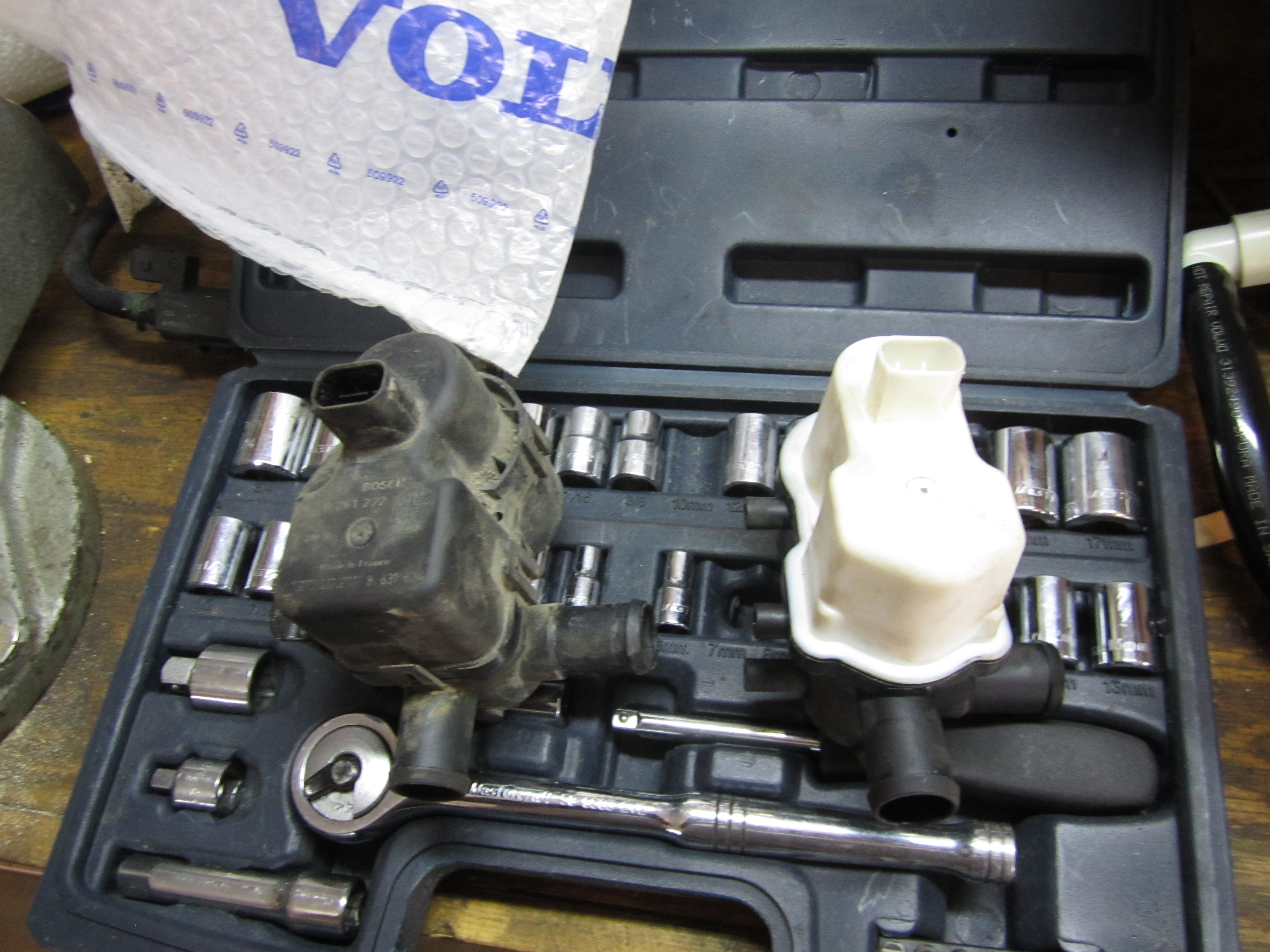

- -1 x Vacuum/emissions pump (Volvo part #: 31392490) – Note below, Volvo appear to have made this a generic pump, so although the pump portion is the same, it comes with 2 plastic pipes that have to be removed prior to use – see pictures)

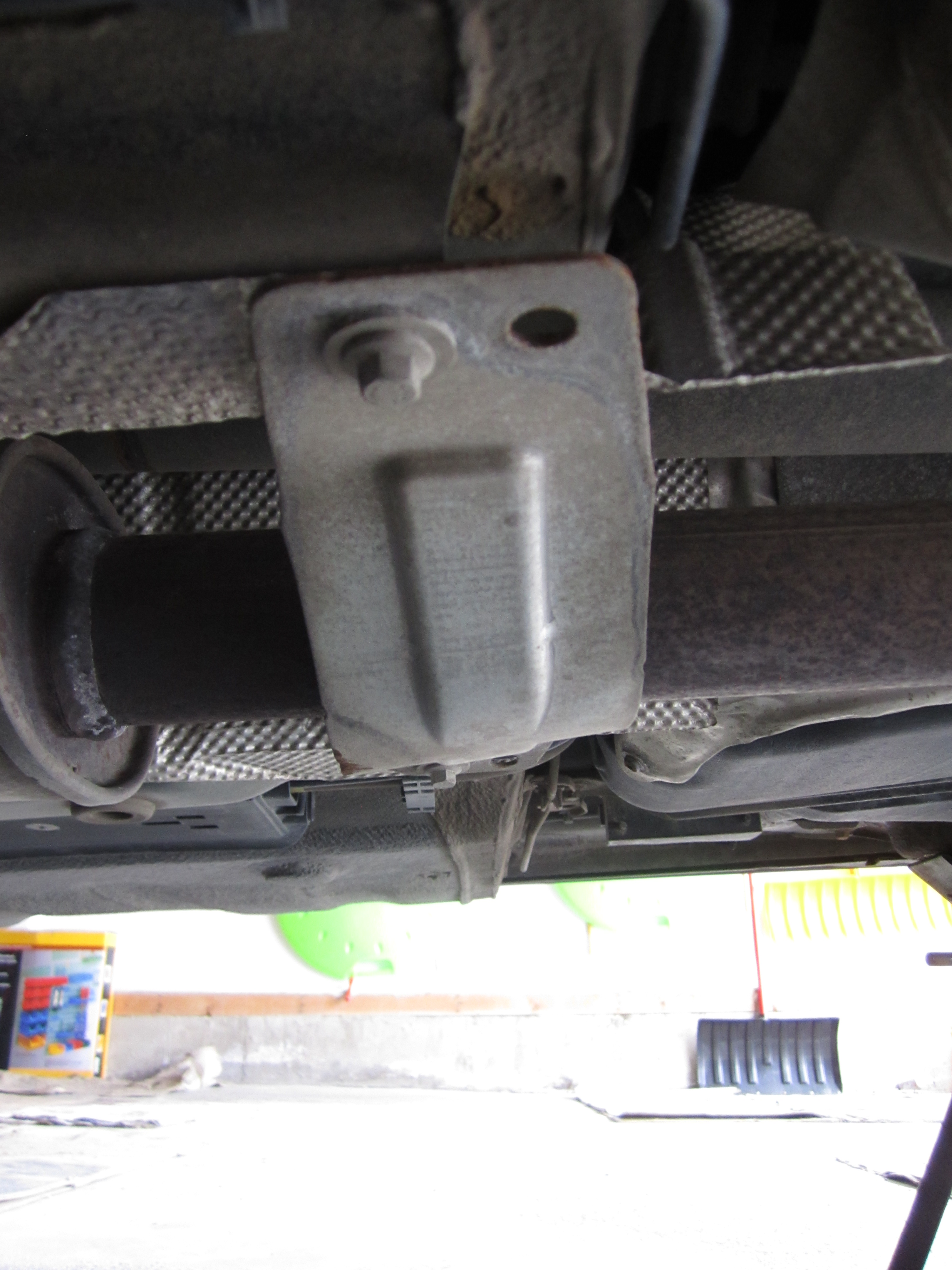

3) Crawl under the car and remove one of the 2 bolts holding the cross bracket near the middle of the car which bridges under the prop-shaft. I loosened the other bolt and just swung the bracket around so it was not in the way.
Bracket under prop-shaft and muffler

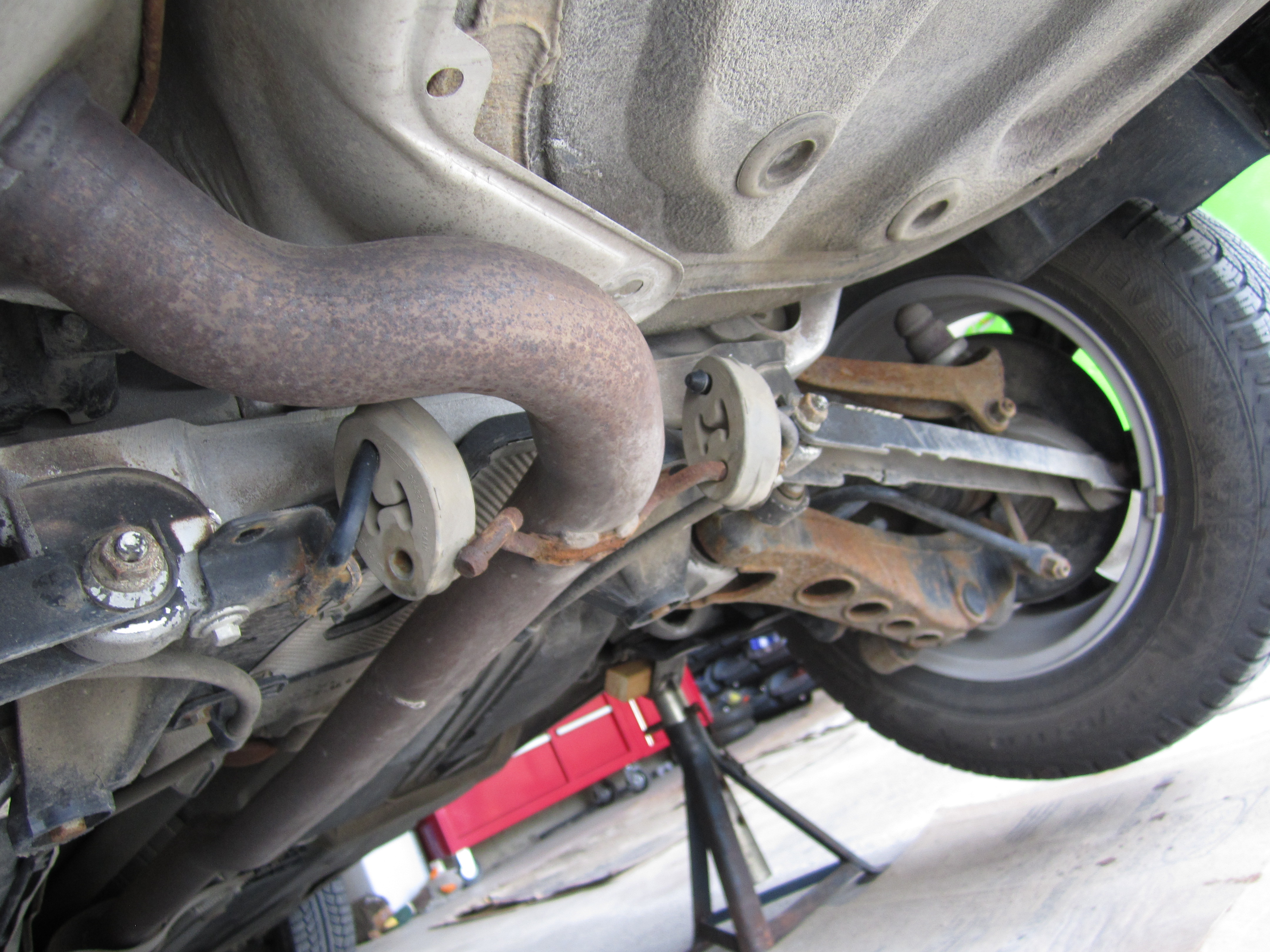

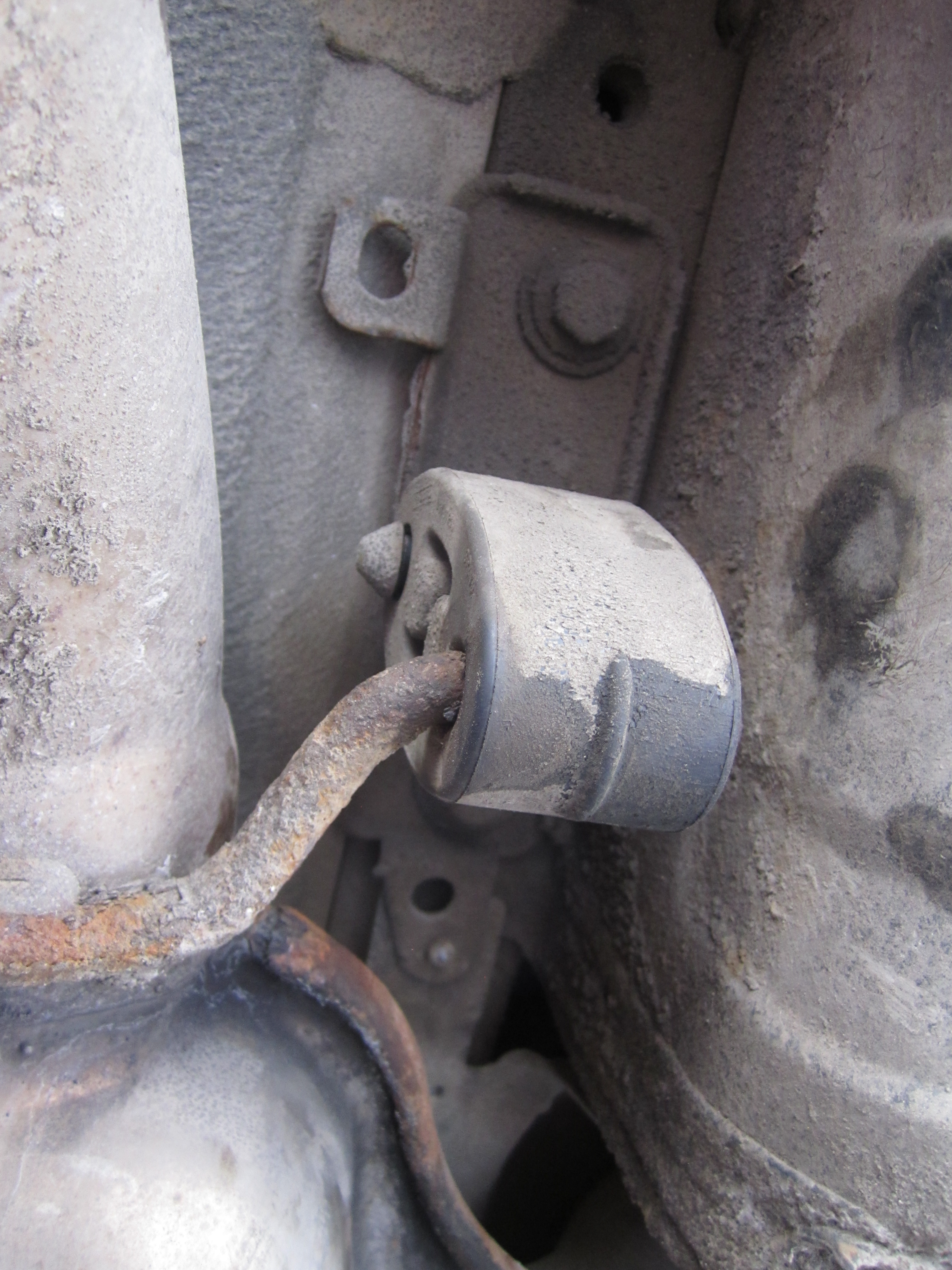

6) Be careful removing the 3 rubber hangers for the muffler system. The ones fitted to our car were still in good condition, but be prepared to maybe needing to replace some or all depending on where you live and age of your car. I used a little silicon spray to ‘lube’ the mounting pins to allow the rubbers to slide off. I did the 2 just rear of the rear axle first, leaving the last one to the rear of the muffler box to last. I had a spare axle stand ready to support the muffler system once it was lowered enough. NOTE: Again, depending where you live and vehicle age, your muffler system could be fragile!! Our muffler looked good until I lowered it and discovered the 2 halves of the outer clamshell cover for rear muffler had almost separated due to stupid mild-steel crimp strip used to hold the 2 parts together had rotted away. I decided to replace the muffler as we were going on a 2000km trip, but a Volvo mechanic said they often remove the outer casing and run the vehicle until the inner portion fails. In this area it can sometimes take up to 2 years! NOTE 2: This is also where I discovered, the original muffler system was a one piece from the cat back. The new system is a 2 part. From the cat (including the front muffler) to just before the rear muffler, and the rear muffler and tail pipe. You have to carefully cut the pipe just prior to the rear muffler and then the new muffler has an integral clamp which slides over the old pipe and clamps them together. I planned to do this myself, but access is tricky on your back, and as the front bolts were badly rusted at the cat, I decided to pay the dealer 1 hour labor (and thus get a 2 year warranty on part and labor) to do the job for me. This did not prevent the rest of the job being done however!
2 rubber muffler mounts rear of rear axle
Rear muffler box mount looking up from underneath rear of car

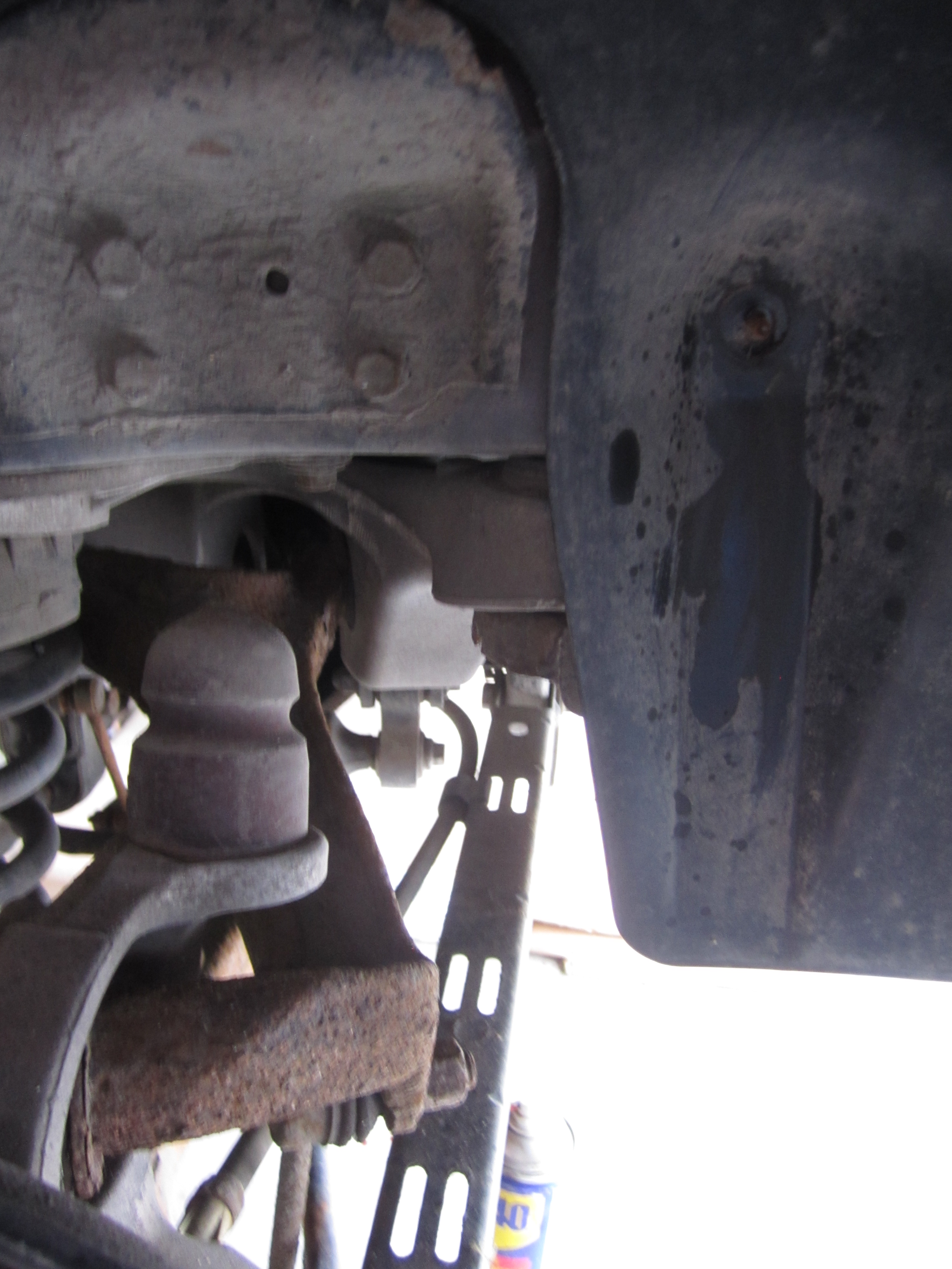

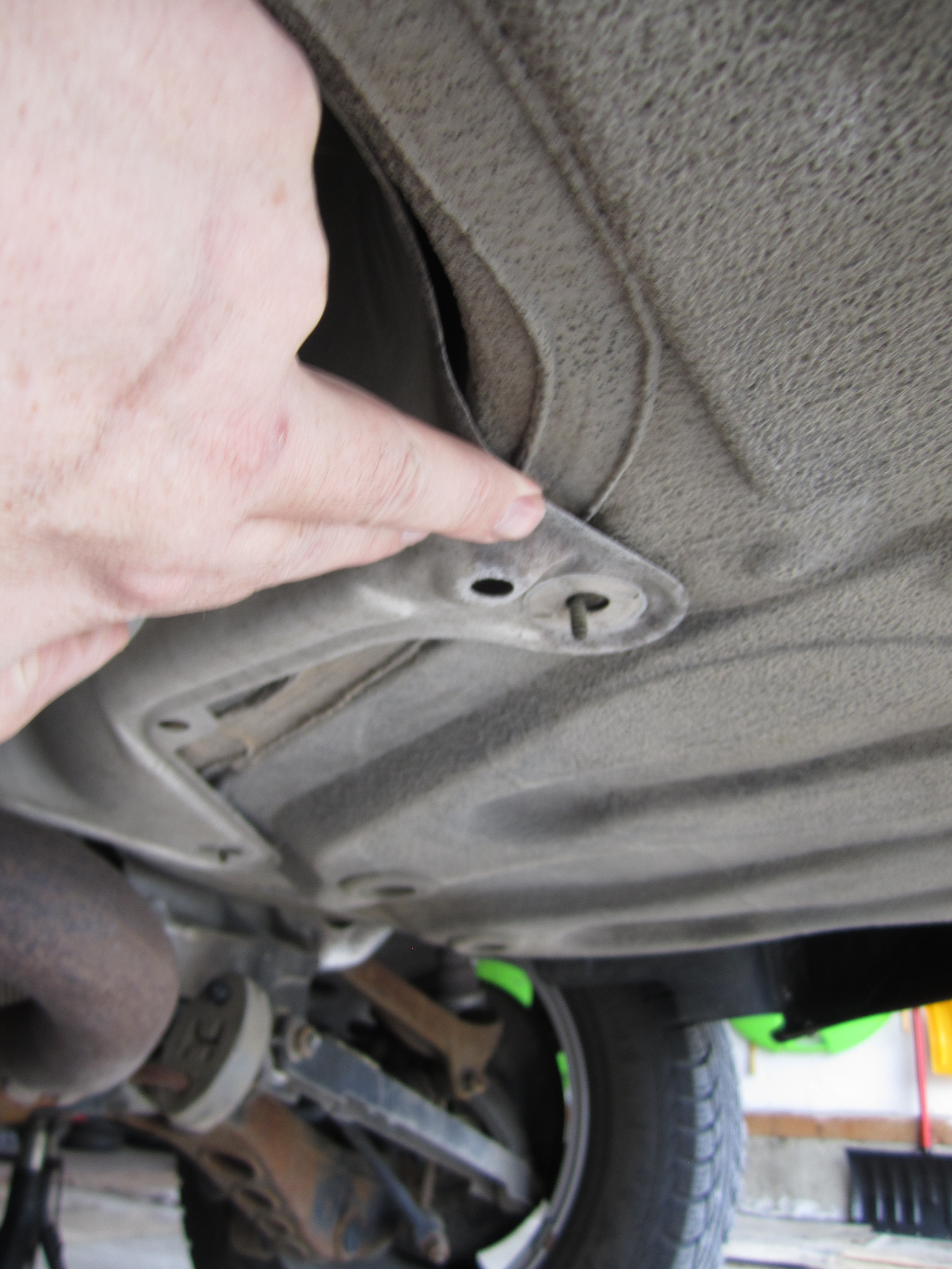

7) With the muffler system carefully supported on the jack stand, the next job was to remove the heat shield above the muffler. This is held on with 2 x 10mm plastic nuts, and also the 3 pop rivets. 2 of the rivets are hidden behind the plastic liner (see picture). I removed the 10mm plastic nut nearest to the rivets, which allowed enough room (with some bending ) of the arch liner to get my drill in to drill out the 2 rivets.
LH rear wheel removed and 10mm nut removed
Bend the arch liner back and 2 rivets to remove are here

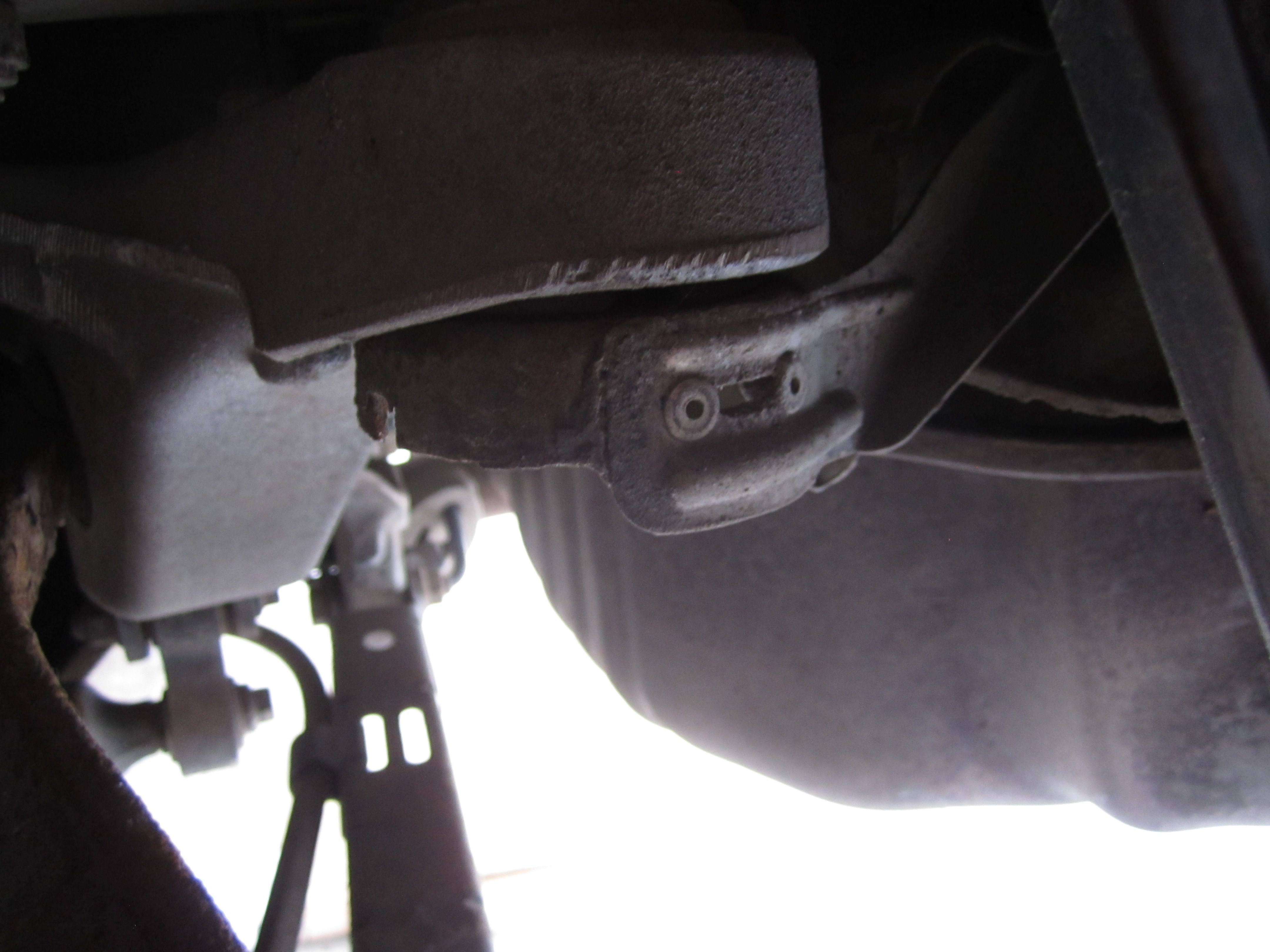

8) Next, I decided to remove the rearmost bracket that supports the rear muffler. The heat shield is attached to this using the 3rd pop-rivet, but it is difficult to get to and Volvo decided to rivet it from the top down. This meant removing the bracket anyway, so I left it attached to the bracket and just removed the 2 bracket bolts instead. Finally removed the 2 plastic nuts holding the heat shield and carefully (read, wrestled!!) the heat shield out.
Remove the 2 bolts holding rear muffler mount bracket

11) I checked the new pump against the old one and discovered, I had 2 remove the 2 plastic pipe fitted to the new pump. I carefully used an Exacto-knife to take slices off the plastic pipe so as to not damage the pump outlets. “You have to remove the mounting plate from the old pump and transfer to the new one. You need to un-screw the 3 Torx screw holding it in place to the pump. I cleaned these up first and carefully removed. Leave the bracket off, as it is much easier to refit the new pump to the old vacuum pipes under the car without it fitted.
Old and new pumps. New pump with pipes
Old and new pumps, with new pump pipes removed
