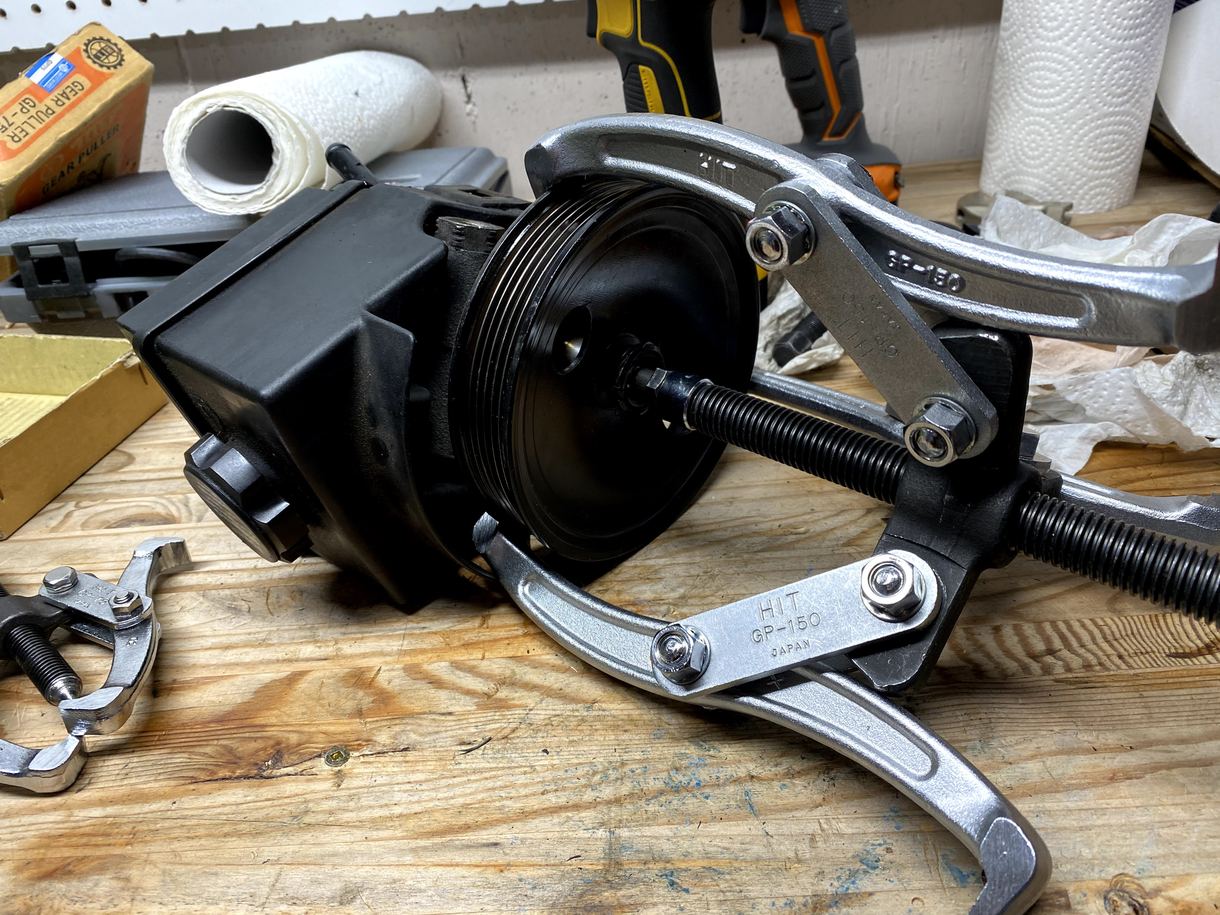

I used a 3 jaw puller to remove the pulley which was quite effortless. Made a loud 'pop' when it became unstuck from the shaft, then just had to thread it off. I threaded a 3/8-16 bolt into the shaft so that the puller didn't mar up the shaft. The diameter of the puller's shaft was also too large, so you need something to be proud of the pulley lip to press on. I had to unthread the bolt a couple of times as the pulley worked its way off the shaft
The reinstalling tool from OEM Tools kit that I originally inquired about worked great for putting the pulley on the new pump.
