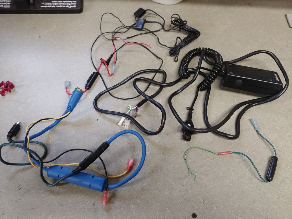

That's all aftermarket, for sure. None of that is original.
