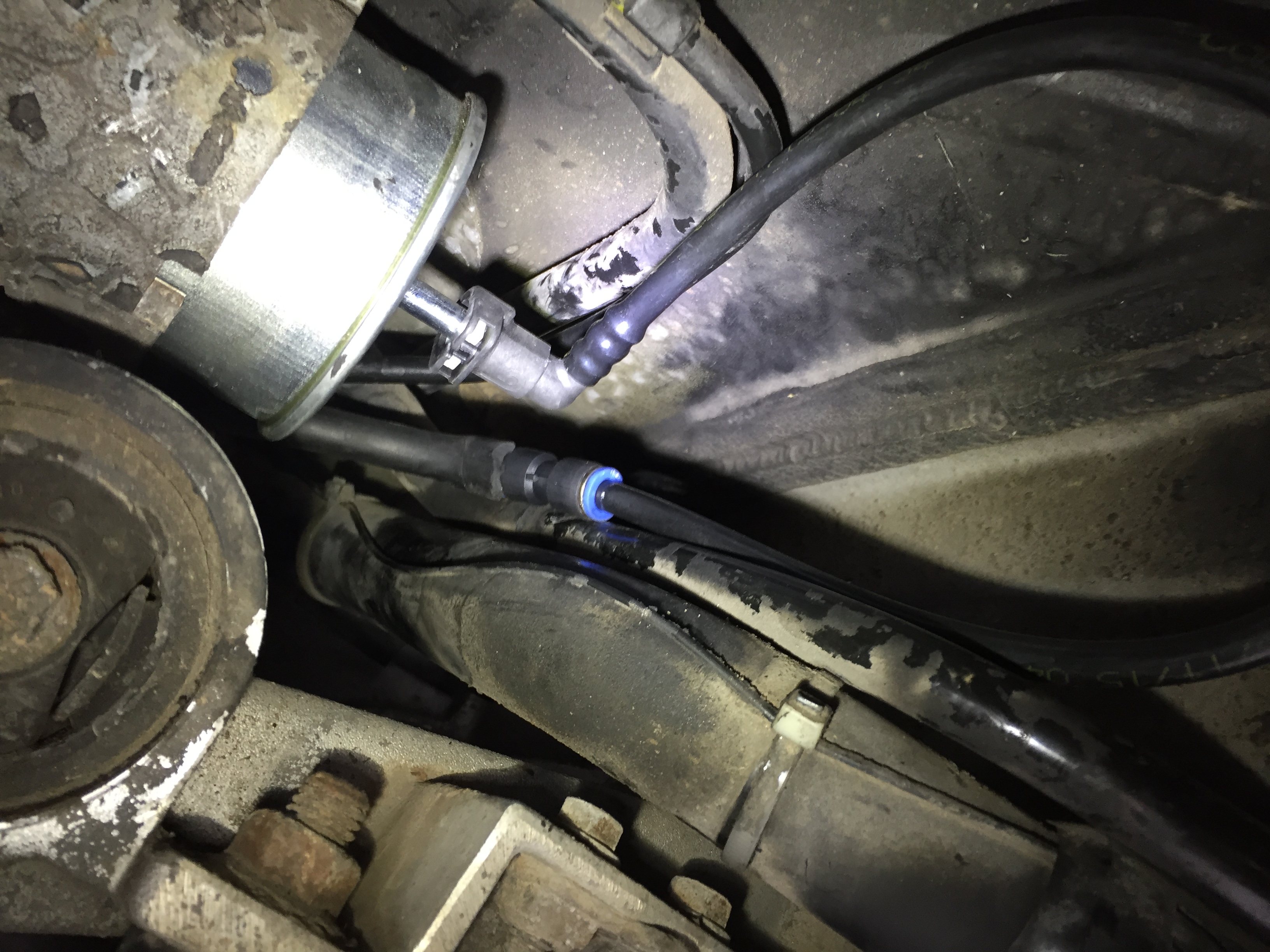

First, after reviewing advice on location of filter I removed 3rd row seat to access the panels in rear. No fuel filter there - it was behind the tank and easily accessed from underneath the car. Doh!
Then, probably because I was in a hurry due to frustration from above, I managed to break the fuel line right at the clip to the fuel filter (tank to filter side). So, the rest of this post describes a hack job to get my car back in business. Very possibly unsafe, and who knows how long this fix will last. Fingers crossed.
After some fiddling and searching at auto parts store I bought a dorman repair kit made for this very problem on American made cars. And I bought a filter that would fit both the Ford style filter clip on the "in" side and was long enough on the "out" side that the 2000 Volvo clip would also work. Later I searched what vehicle the filter is designed for and it's actually a 2001 V70 filter. Perfect. So, spliced the doorman kit to my existing broken "in" fuel line. This is the most difficult part and I wasn't that great at it. So, I put a hose clamp on just in case. The fuel line is 5/16" nylon. You have to trim it off several inches to get past the factory line/clip union. I used a propane torch well away from vehicle to heat the brass barbed splice piece from the repair kit and used pliers to twist and shove it into the old nylon line as far as I could. On the "out" side of the filter I just used the existing Volvo clip. I considered grinding the lip off the filter pipe, but thought I'd try it as is first. So far so good. Have run around quite a bit with no leaks.

Nice mod but I'd put some zip tie or run a solid wire (the solid copper wire used in household wiring) all around the filter.

Update: This fix lasted about eight months before I noticed a fuel odor and found that the metal clamps were damp with gasoline and the filter was rusted. I tightened the screws gently, and this worked for about another month. Today, the smell is back.theWIFES_S70 wrote: 18 Feb 2017, 20:42 Don't mean to be jumping on this thread. But had the same thing happen today to my brother's V70. (I think the boy just doesn't know his strength!)![]()
