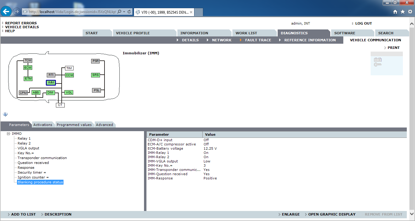

3.Immobilizer seems to recognize the key in VIDA and everything seems to be good there (shown in picture)

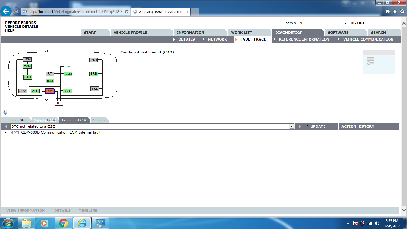

I'm kind of at a loss of how replacing my alternator could have caused this issue.. VIDA also seems to thing that there is an issue with the CDM. Can the CDM cause a no start??

Was looking at what you had posted. Looks like immobilizer is communicating with key without issue as you observed. The CDM000D worries me. Try removing battery power for ~10 minutes and see if that pops back up on next start.
If so, I would suggest removing battery power again to clear it and then attempting a normal start with tailgate open and see what happens. Occasionally the tailgate's harness wears to the point of a short - it is known to cause issues with immobilizer operation - which if I remember correctly is integrated into the ECM.
