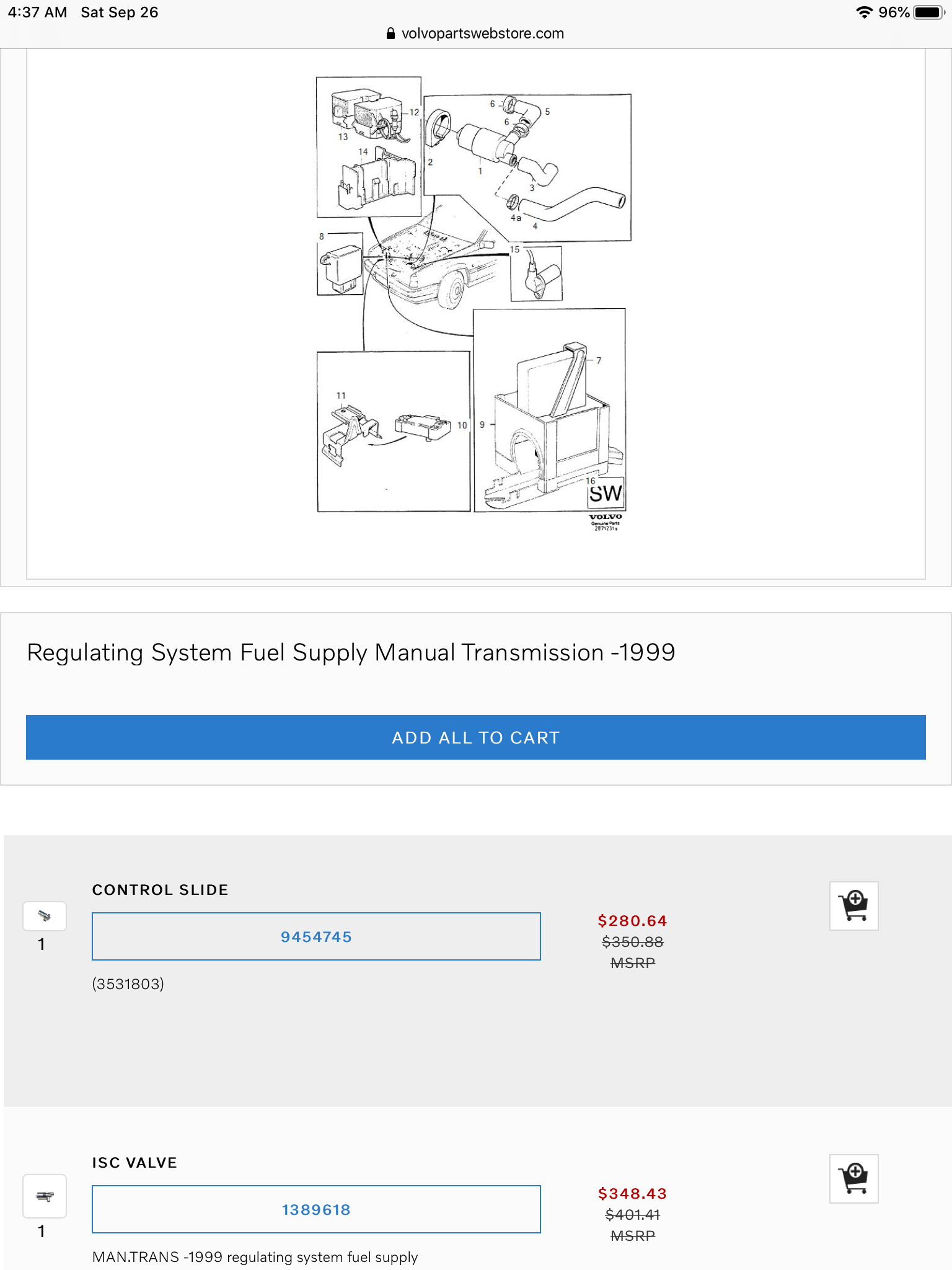

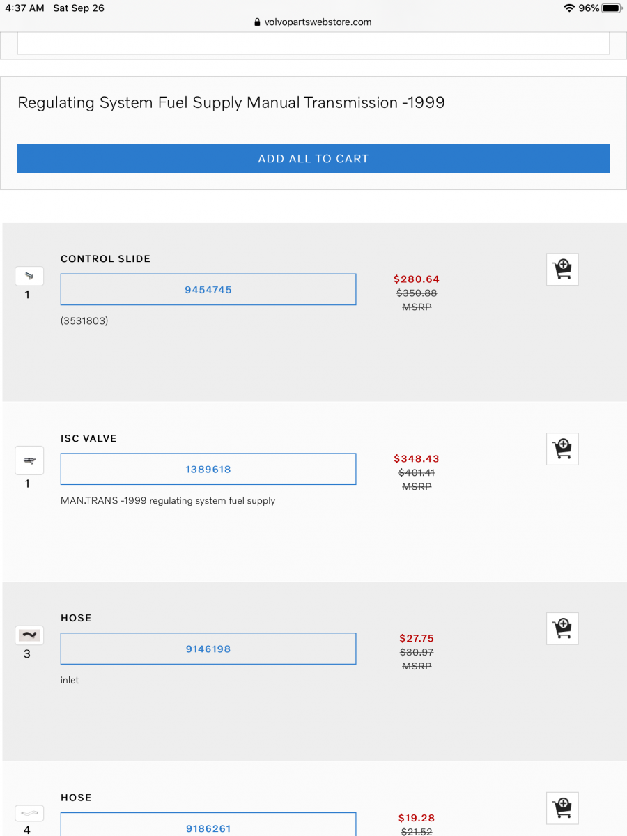

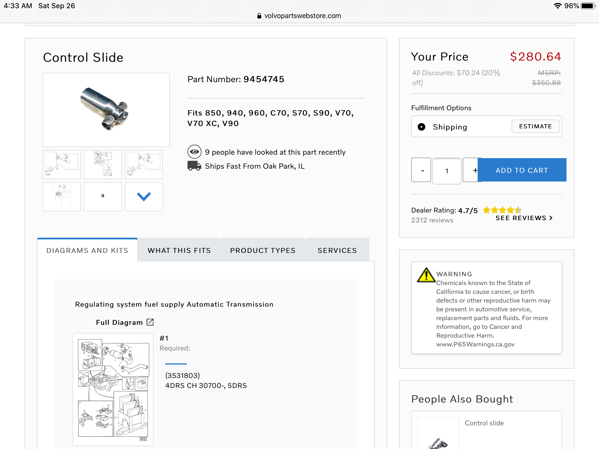

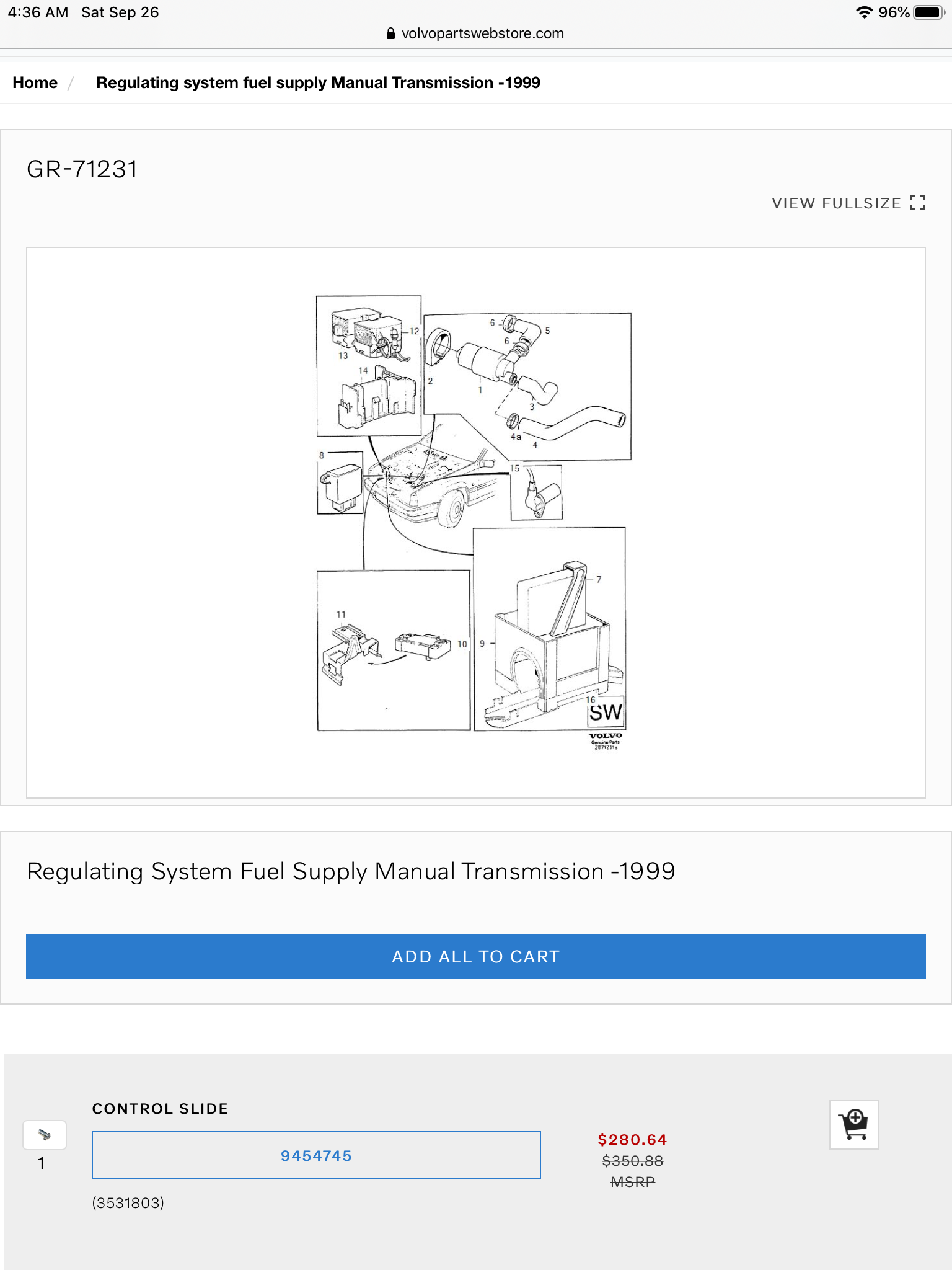

When the Duchess got back home she had a bit of a wonky idle, which we cured by unplugging and replugging in the IAC. My guess is it needs cleaning.
You can still get these new but they are pricy , $330, or so
Junkyard pull much easier on wallet.
Part number 9454745

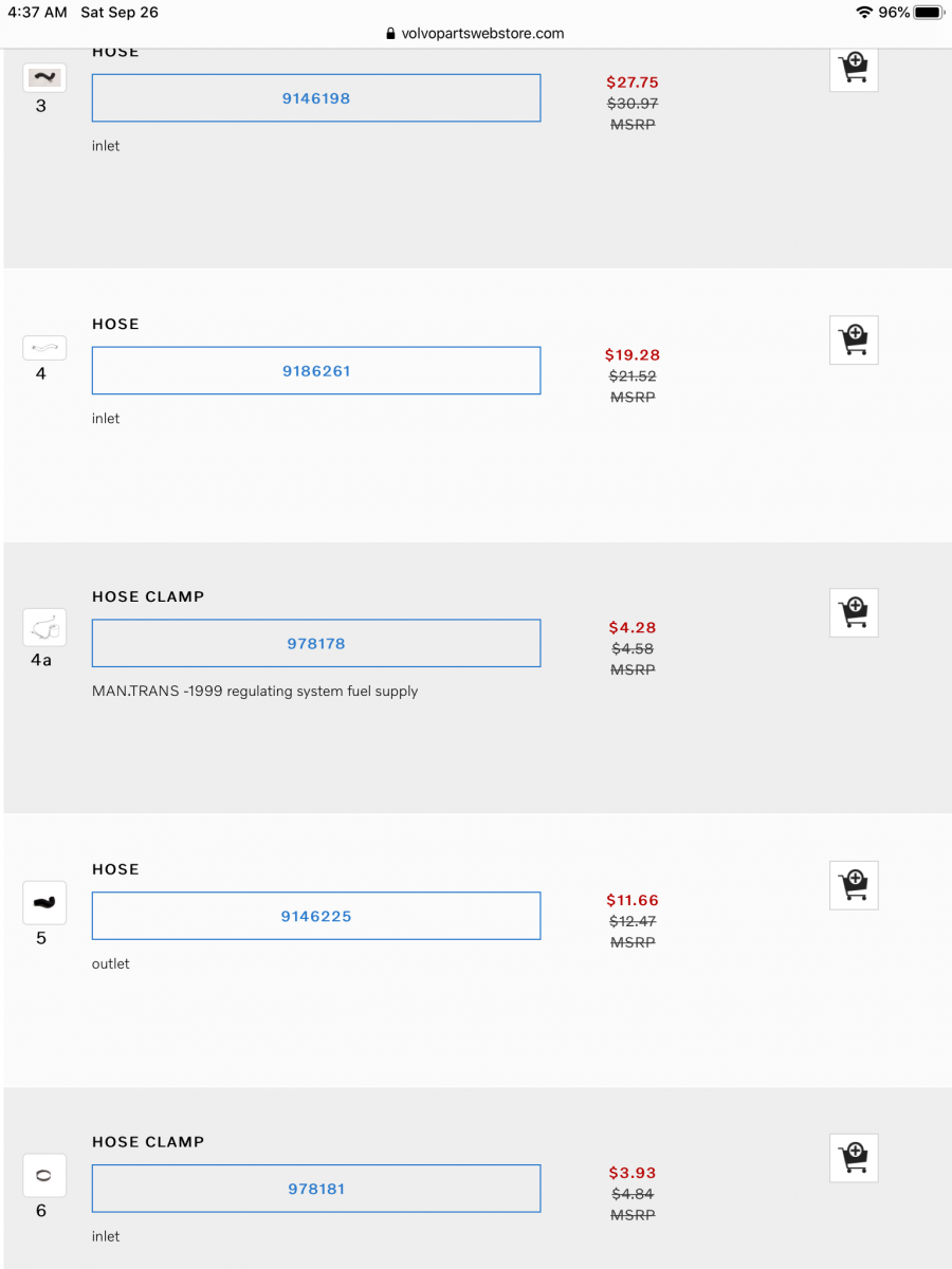

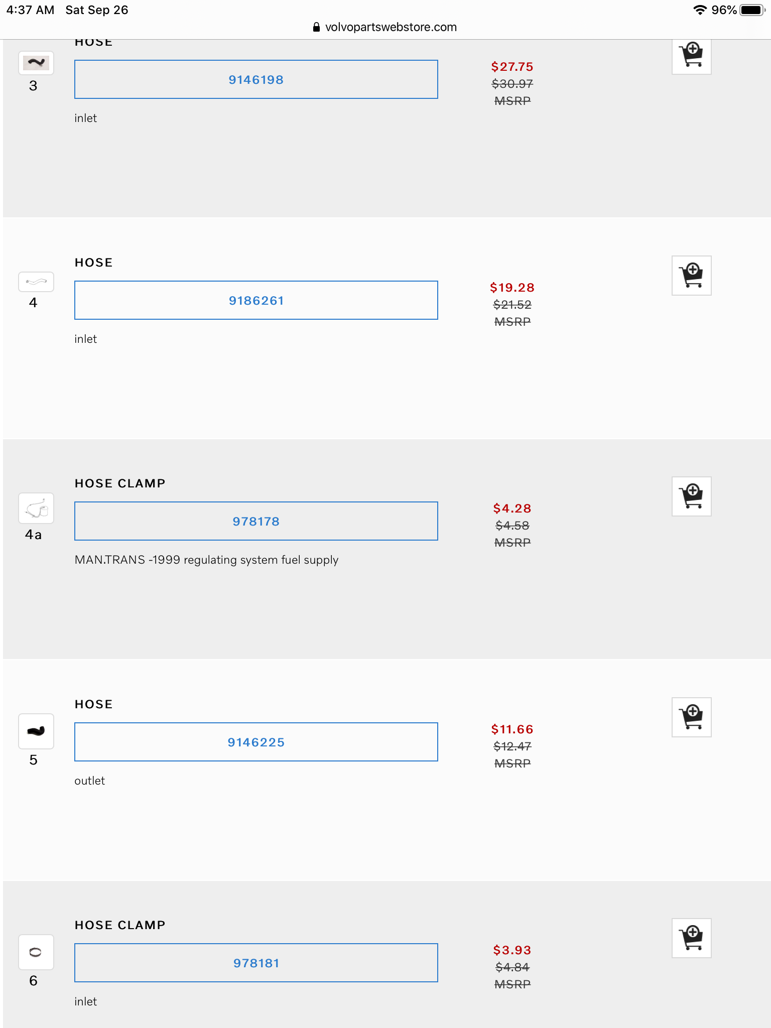

This part is buried in the section for ‘ regulating fuel supply for automatic transmission’ and called the ‘ control slide’ or ISC Happy hunting
Hoses are still available as of sep 2020
Part number 9454745
