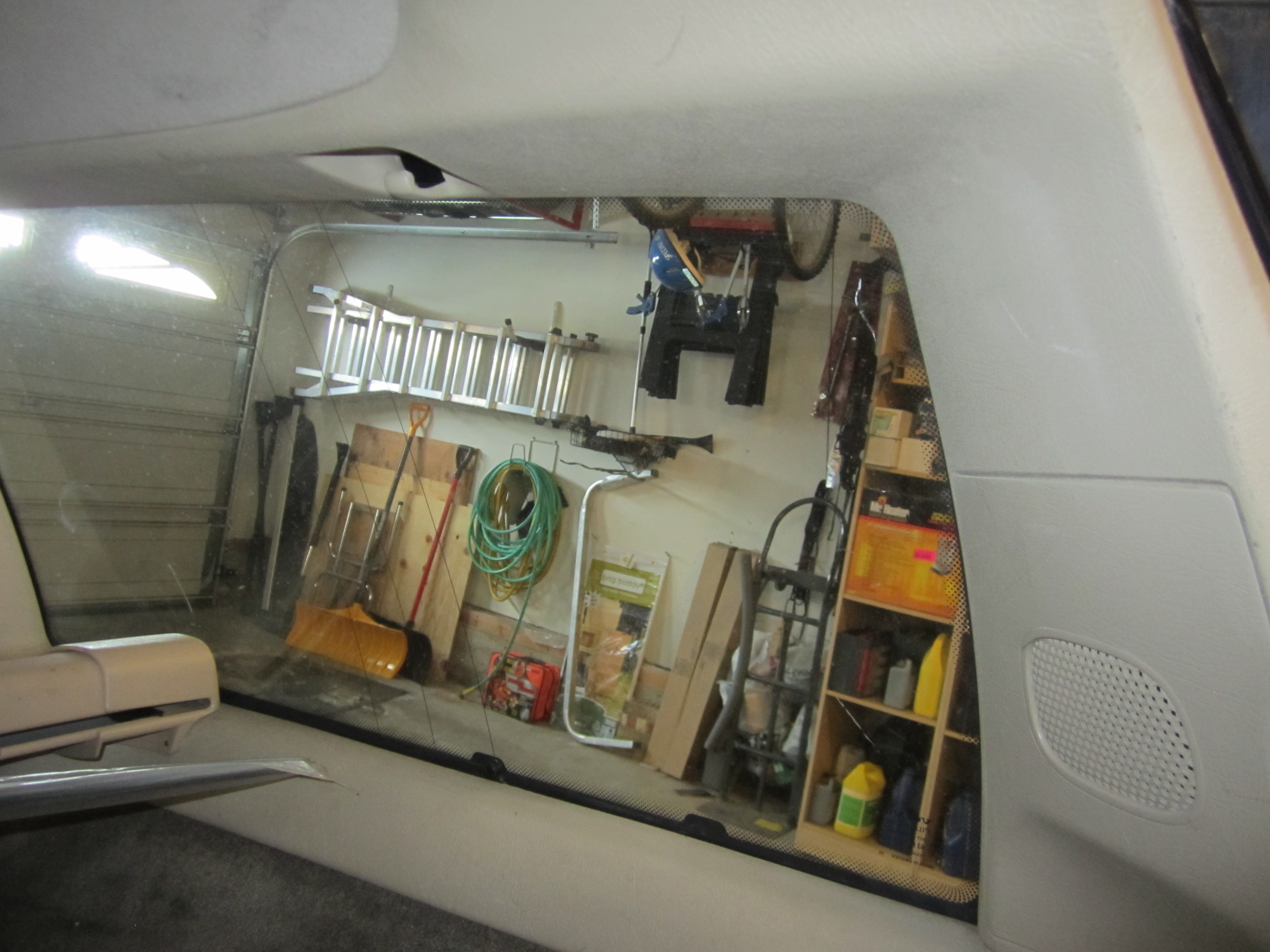

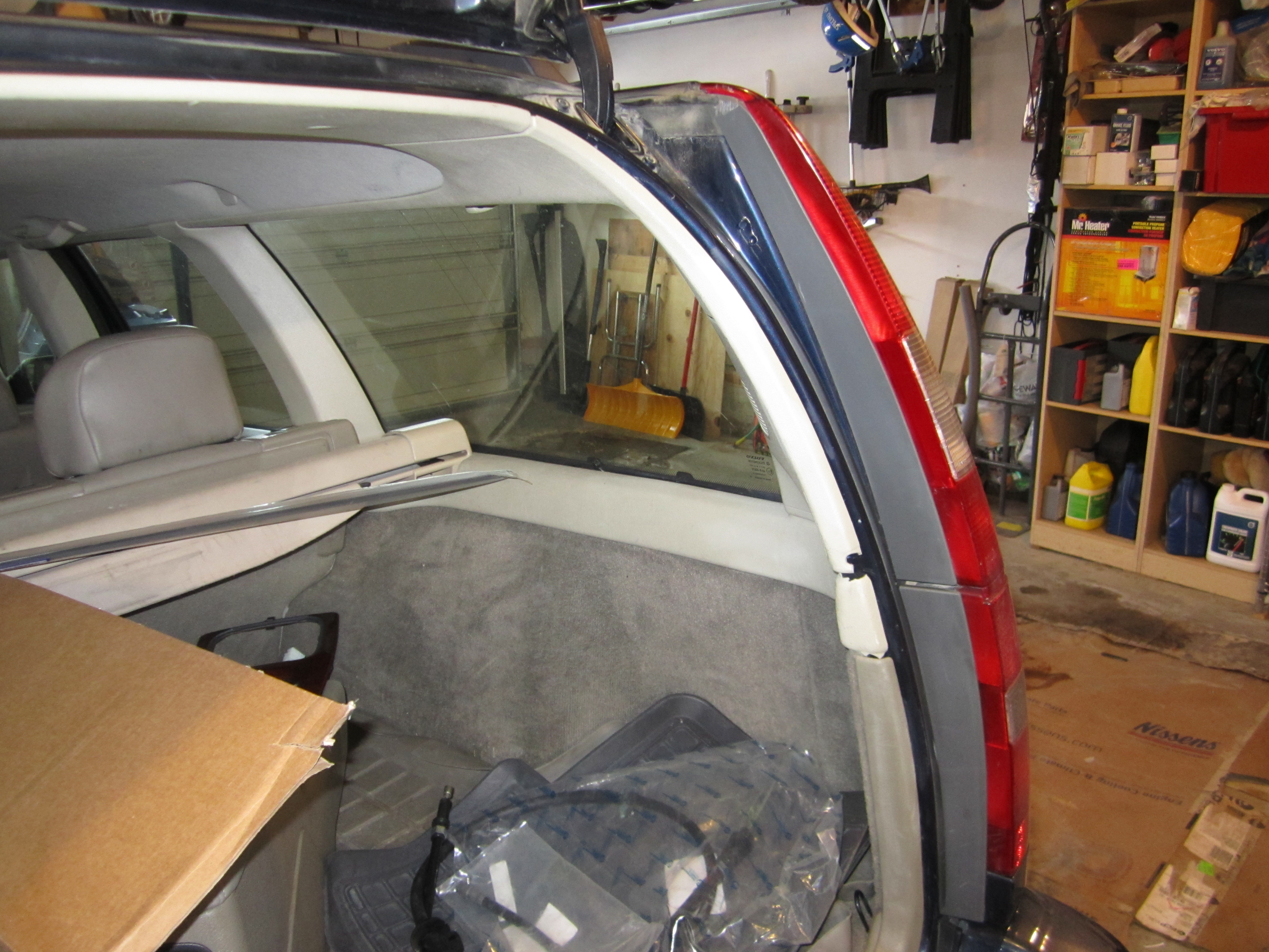

Not particularly hard to replace, but be prepared for possibly broken plastic panels and clips bt on this panel it is not too bad.
You have to remove the upper plastic panel above the side windows in the load area. There is a T25 (?) screw that has to be removed from in the recess for the plastic molded hook built into the panel. If you look at the 2nd picture below you can see the hook about half way along the top of the side window. You have to pry out the upper tailgate surround to allow the lower side window panel to be released at the back to get the upper panel released to remove it. You have to work it out from the panel that runs across the tailgate opening, and unsnap the 4 or so metal pins at the rear edge.
Easiest way is to pry out the speaker cover. Then with a soft tool pry under the edge of the panel at the tailgate end which will help release the 3 or 4 metal locating pins at that edge. Using the speaker cover hole pull the panel away and down from the window. There are 3-4 snap plastic clips along the length of the panel above the window. Slide the panel rearward and rotate the bottom of the panel away from the side window. This should allow you to remove the panel completely. Take your time and don't be too brutal or you could crack the panel.
With the upper panel removed you can then access the clips/mounts for the tailgate strut on that side. Support the tailgate with a piece of wood to allow you to remove and replace the strut.
Then repeat for the other side.
