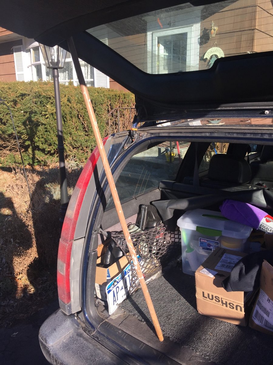

MrAl wrote: 22 Dec 2017, 02:05
scot850 wrote: 21 Dec 2017, 10:50 Take your time and it is not a particularly hard job. I supported the tailgate door with a 2" x 4" wooden joist for this job.
The plastic is not too bad to remove, but try to use trim plastic removal tools at the rear edge by the tailgate.
Hi,
What about getting the old shock off and the new one on? Any problems there?
The old shock pops off with a screwdriver, just pull the wire retainer off if there is one (usually is). Very, very easy to do.
Manufacturing a hold stick that involves drilling into the plastic seems like a bad idea (plastic may crack under pressure, for example) in addition to being more trouble than it is worth. You want to be able to adjust how open the door is, so that it is just right, basically fully open, it is nice to be able to fine tune the opening (by moving the stick) otherwise installing the new shock can be a hassle. A scrap 2 x 4 propped against the metal edge of the door does that safely and easily.
I have changed these things like five times now, this job is a 3 out of 10 on the difficulty scale, no need to over think it!
Hi,
You make it sound a little easier so perhaps i'll wait and see how Steve makes out with his as he's just getting two new ones too, and then go from there.
Also, yes the plastic might crack over time i did not think about that.
So maybe i'll use a 1x2 for now and after i hear how Steve's install goes i'll order two new ones. What the heck, it cant be that hard to do can it? :-)

erikv11 wrote: 22 Dec 2017, 09:16The old shock pops off with a screwdriver, just pull the wire retainer off if there is one (usually is). Very, very easy to do.
Mine were a bit more resilient - had to fight with the largest screwdriver to get them off. Once they were out, I had noticed that what once was grease had turned into something similar to epoxy putty while them wire retainers were missing. Therefore (as a tip to Al) it's a good idea to clean the socket from any muck clinging to them. If ordering the Stabilus dampers, they come with a good dab of fresh grease already attached.
Anyway...second time I had tackled the dampers (to replace the Chinese incontinents with the Stabilusses) it took me about 30 minutes for the complete task, including a cigarette break.

I was going to use the 1x2 because then i can make it variable length with a simple phillips screwdriver. Two pieces actually, where one is screwed with two wood screws into the other forming a longer piece. If too short, just unscrew/screw again, if too long, same thing. A lot of screwing around maybe but only once or twice should do it :-)

I'll take a pic of mine too when i get it out there. You'll see why i wanted to do it this way.
