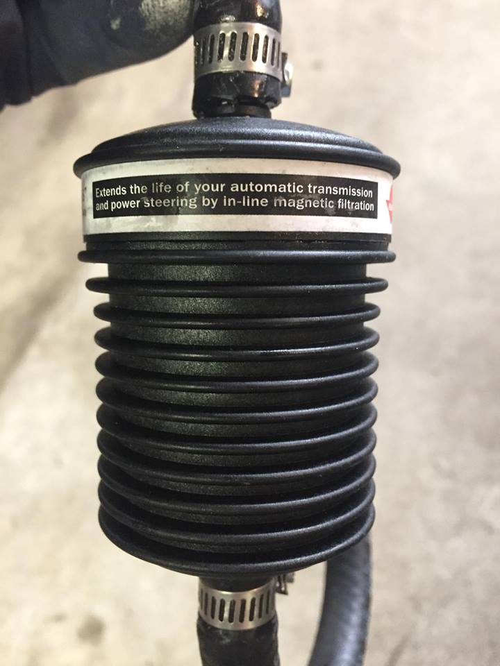

That's basically the same thing my 2003 Saab 9-3 Linear with the same transmission would do. Sometimes after sitting for a significant period of time it would work but then die. One time I drove about 2 miles and then it died. I would then turn off the car, wait for a few minutes and then drive another 1/10th of a mile until it started slipping or stop. Then shut off car. Now I've got it so it'll work but I'm currently stuck with 1st and 2nd and Reverse. I think my valve body is clogged up with all the crap I cleaned out when I pierced my current filter.
I'm currently in the process of running the car with an inline transmission filter on the out port of the transmission cooler. It's winter in Vermont right now so I'm waiting until I can get a clean day to drive the car to my shop to drain the fluid and pull the valve body cover off and clean out all the transmission solenoids and valves and the valve body. I have two complete transmissions and many solenoids to allow me to clean one set and have ready to swap in.

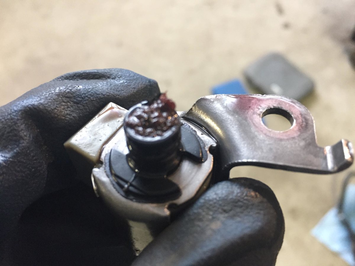

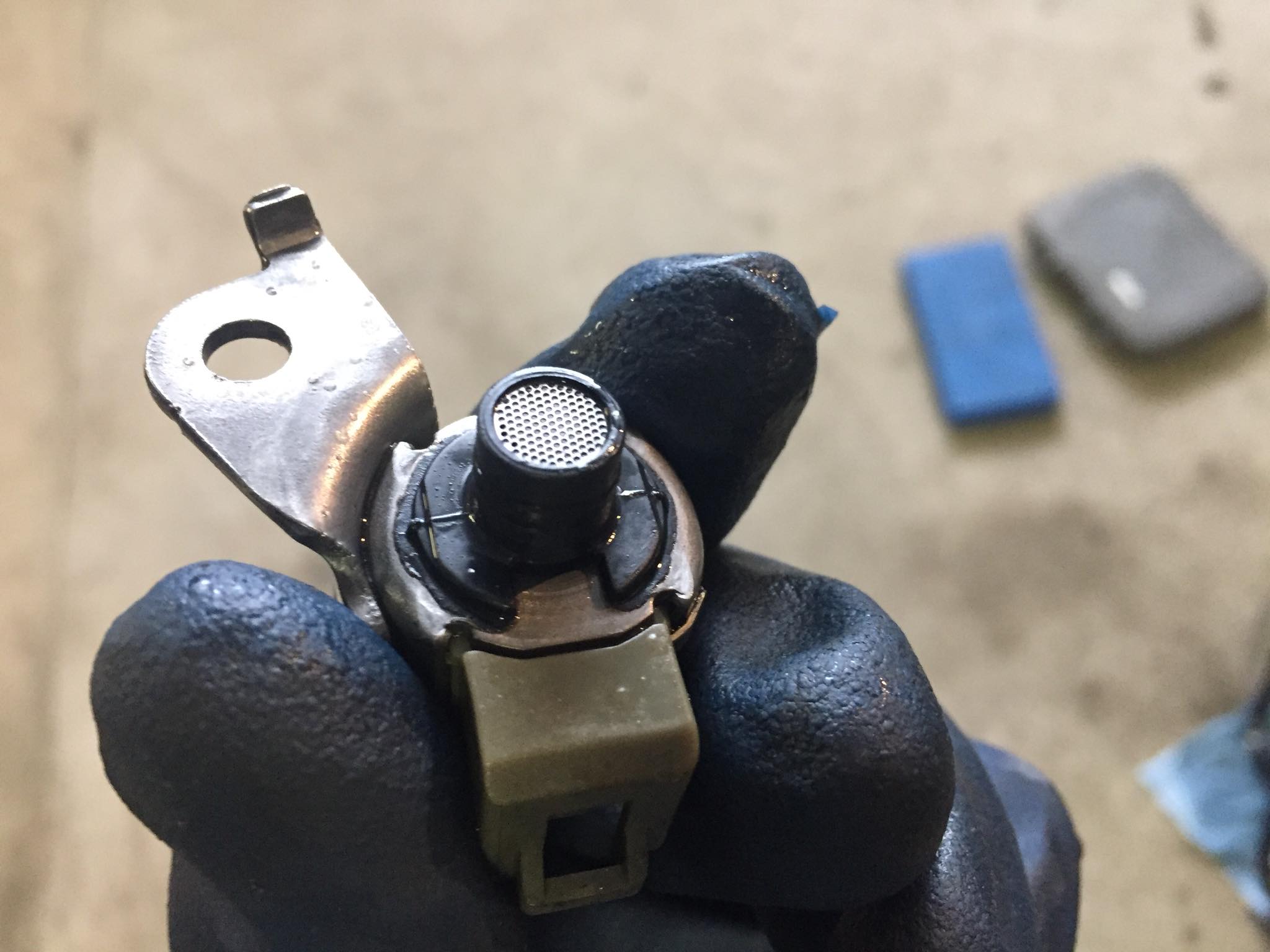

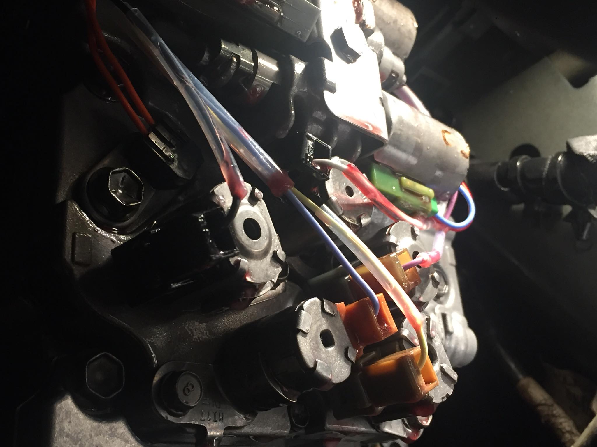

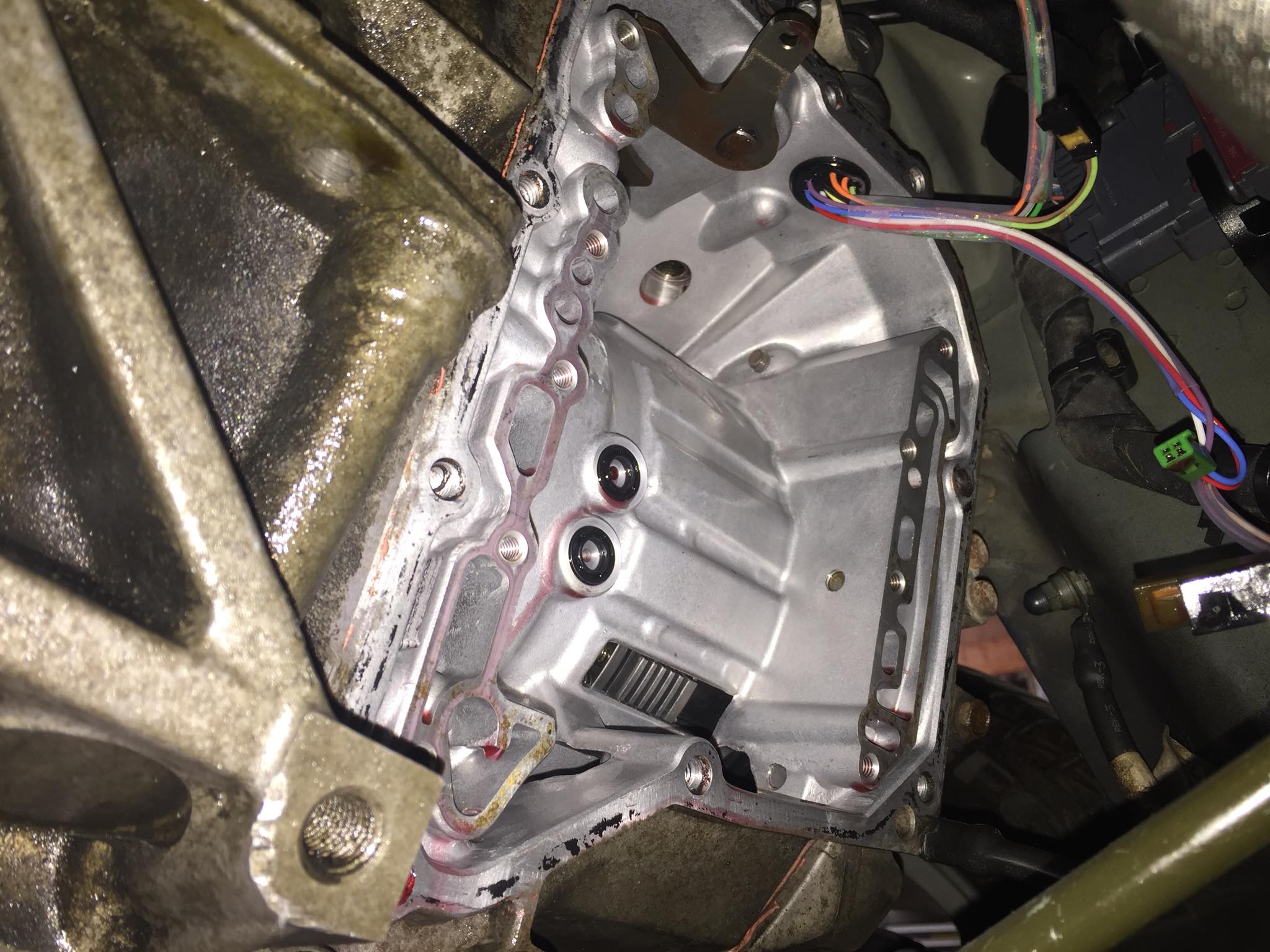

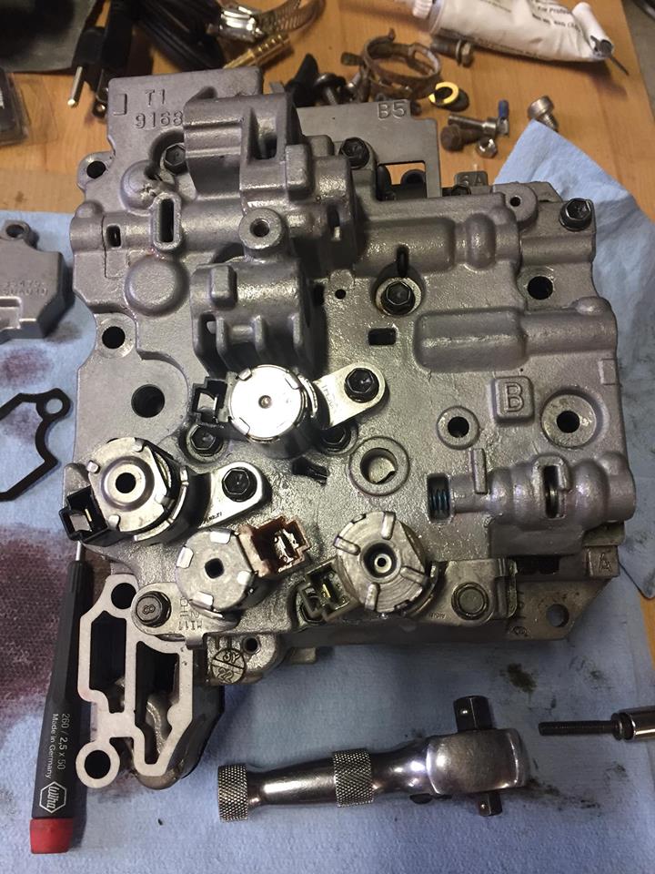

Update on my Saab 9-3 with the clogged filter. After getting it running in November it stopped working correctly. It would shift into 1, 2 and Reverse. No higher no matter what I tried. Took the valve body out of the transmission and cleaned all the solenoids. They were all gunky like these pictured. Then ran 12 volts on each one and blew air through each one to ensure the valves operated correctly. Put it all together and will test drive it on Monday (east coast time zone). I am excited that we may have come up with a solution on these transmissions. I also added an aftermarket higher volume filter 3/8 inch in line with the cooling lines. Replaced all the fluid with some Castrol which is rated as Type IV equivalent.
- 27867995_1678741495517971_2893291330134006381_n.jpg (61.48 KiB) Viewed 3056 times
- 28167774_1678741272184660_7719106288640932157_n.jpg (122.69 KiB) Viewed 3056 times

Watch those serrated clamps on the inline filter. They have a habit of perforating hoses.
vt9000cse
- Posts: 24
- Joined: 1 November 2017
- Year and Model: 2003 Saab 9-3 Linear
- Location: Vermont USA
- Has thanked: 1 time
I see that the clamps are doing damage to the hose to the inline external transmission filter already. Thanks for the heads up. I usually use "fuel injection hose clamps" to prevent that. But this is hopefully a temporary setup until I can figure out how to best route everything and keep the filter and the transmission cooler plumbing to the radiator. It's a tight squeeze in there. Thankfully this is the 2.0T four cylinder. Saab squeezes the GM 2.8 V6 Turbo inside this same engine compartment.
