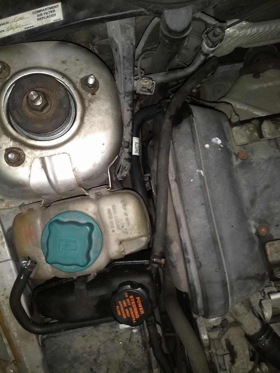

Good stuff. I have a new PS hose for it, too, which I would've replaced had it not been for the polar vortex.
I did mean to mention that there was fluid leaking on to the pavement when I parked, maybe three tablespoons' worth, and it wasn't from the washer fluid I spilled. (That we a separate wet spot on the road.) I thought I'd sop it up with a white napkin to see what color it was, but didn't have any.
I thought I'd read that the water pump is designed to weep before failure, which is why I wondered about it. I have one ready to install, along with a timing belt, whenever the thaw arrives.

If you take off the timing cover and look at the water pump, you'll see if it's leaking pretty easily.

Take off the bottom splash shield and look for coolant residue (white chalk-like substance) and try to pin point where it's coming from. No need to play coolant roulette!!
On an MT N/A your life is simplified:
- Four hoses (upper, lower radiator hoses; heater hoses)
- Upper and lower radiator inlets;
- Thermostat outlet;
- Engine coolant outlet;
- Thermostat housing;
- Coolant reservoir outlets (upper and lower);
- Coolant reservoir tank cap;
- Heater hose inlets on the back/side of the engine;
- Heather hose connections to the firewall;
- Water pump;
- and, of course, a possible hole in your engine spewing coolant!
You installed new Rein hoses with spring clamps, right? There was a review on MVS about those clamps leaking so let's hope it's just that.
Other than that, radiators on these cars are not as robust as they used to be in 2000... I am going to pick one up and get one in our car once the weather let's up!!

The good news is that all the new radiator hoses appear dry, as well as the heater hoses. No new leaks, coolant smell, wet spot or steam from the engine today (or last night), but I did notice a damp hose where it meets the timing cover (upper right section in the photo below).
Leaky power steering line, 2000 Volvo V70

Probably a pinhole leak. Just replace it soon before it becomes a large leak!
