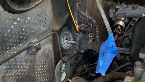

Pull the harness on the kickdown switch, Clear codes. Take out and punch to floor.
1. If the AT-143 does not come back, Kick down switch is welded closed or out of adjustment.
2. If AT-143 does comes back:
- A. short to ground in the kickdown harness.
B. TPS is a lier.

I ended up swapping the VSS from my parts car and the AT-232 didn't come back.
The AT-143 code seams to be a bad kickdown switch. I'm going to try swapping it too.

the kickdown switch is located on the firewall, and it isn’t replaceable without a whole new throttle cable, if the car is in sport mode it won’t matter if the kickdown is broken because the TCU only looks for the signal in Economy mode. But even in my case, when the kickdown switch was bad, it still downshifted to the lowest gear no matter what mode i was in (probably as a fail-safe)???
- RickHaleParker
- Posts: 7129
- Joined: 25 May 2015
- Location: Kansas
- Been thanked: 958 times
The Kickdown switch tend to break at the firewall mounding. See if you can pull it away from the firewall.
